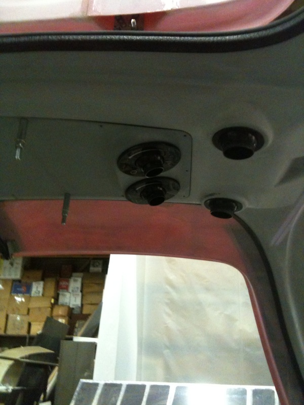

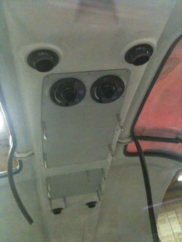

Here is my Aerosport overhead. I am installing two Aveoflash Eyebeams that can turn red or white by touch and also has intensity. I made the angled piece by cutting the aluminum and welding a strip in then filling it in with fiberglass. The Eyebeams scratch easy so I had them send me two new coverplates. I will be buying some protective film to cover the new ones like the film on an iphone. I tried them out and they work great. Two of them cover the entire panel and make it possible to have two lights instead of four.

Just a word about your plan. Look at your sun visor and see what kind of room you'll have in that area. If your OVH hangs down a lot you will sacrifice with sun visor being low at times. Rosans are pretty big.

Good point. I would think that installing them further back where I installed mine would give more room away from the visors than the commonly mounted red lights fwd on the console. I don't know I will have to look at that. I guess there are pros and cons. Hard to adjust if they are in front of the visors and hard to point to the panel if behind it????

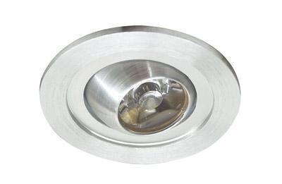

OK I finally found the light that I want to use instead of the vents in the overhead console. Now here is the question to all electrical engineers.
The LED light comes with an LED driver (transformator) which reduces the 230V (AC) into 12V DC 350mA.
Now here is my question.
Is it possible to leave the the LED driver out and connect the LED directly to the battery of course with a fuse in between?

PostPosted: Fri May 14, 2010 3:06 pm    Post subject: Swivel Overhead LED cabin lights Reply with quote
It depends.
IF there is a current regulator in the LED assembly, then you could plug directly into the mail bus (which will on the order of 14 Volts during normal operation).  If they have not installed a regulator then you may burn out the LED's or shorten their life.
The way to find out is to connect them to a bench / adjustable power supply and bring up the voltage slowly while watching the brightness of the LED.  If you get to say 8 volts the brightness of the LED reaches a peak and stays constant for the rest of the voltage change, then yes you have a regulator and it's working.  At that point you should be able to connect directly to the 12 V bus.  If not, then the LED will be brighter and you risk shortening the life.
if they are not too expensive then just plug it in and go for it.
