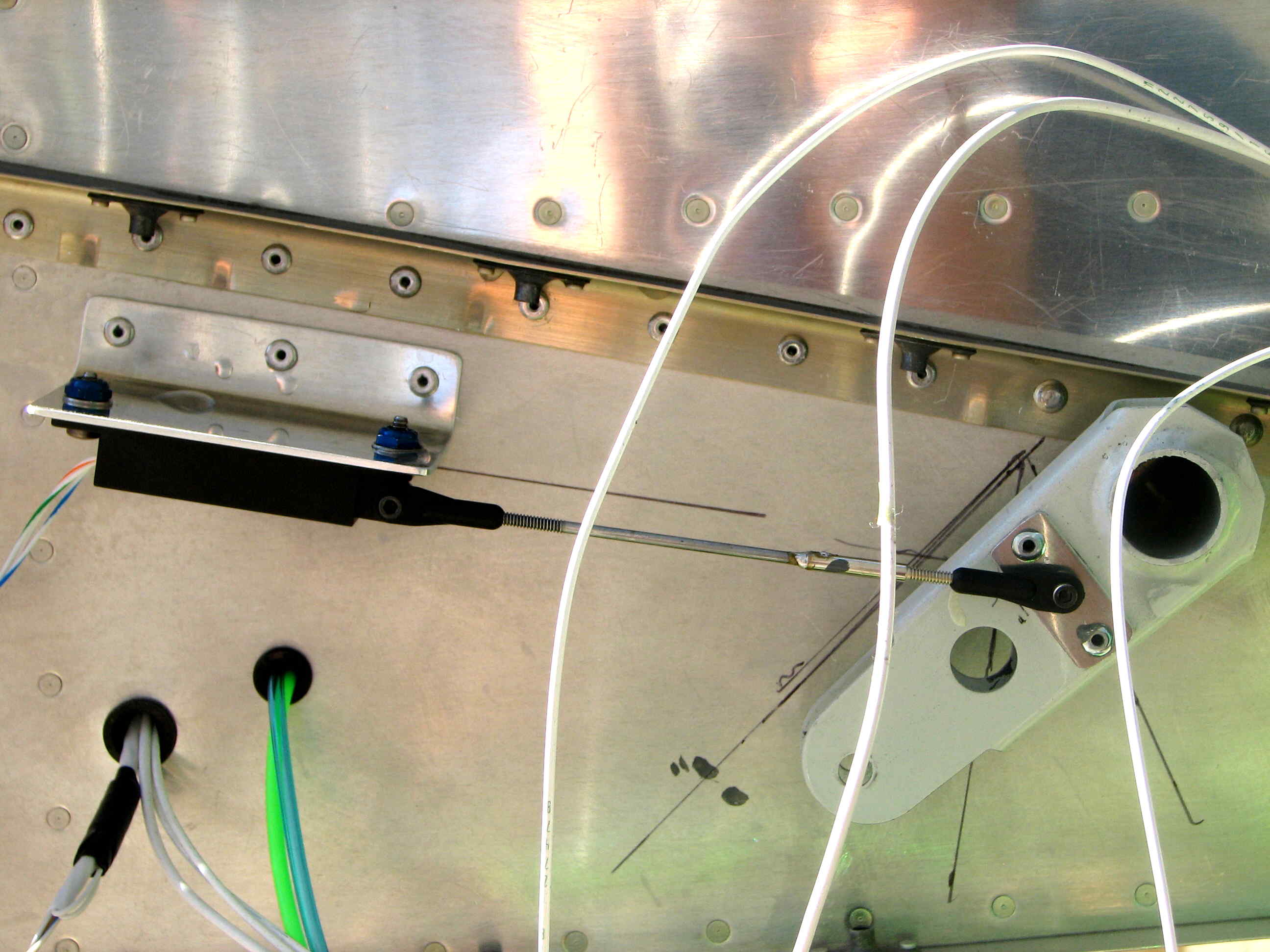

Hey John,
Here's what we did. Others have suggested using threaded rod with a yoke (model airplane connectors) which is a good idea. But there is still some fiddling to do to get the range of throw right. The sensor itself apparently is less accurate at the end limits, so keep that in mind.
Later, - Lew

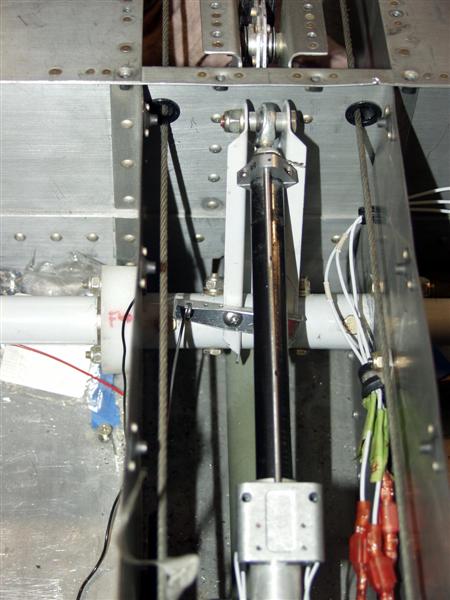

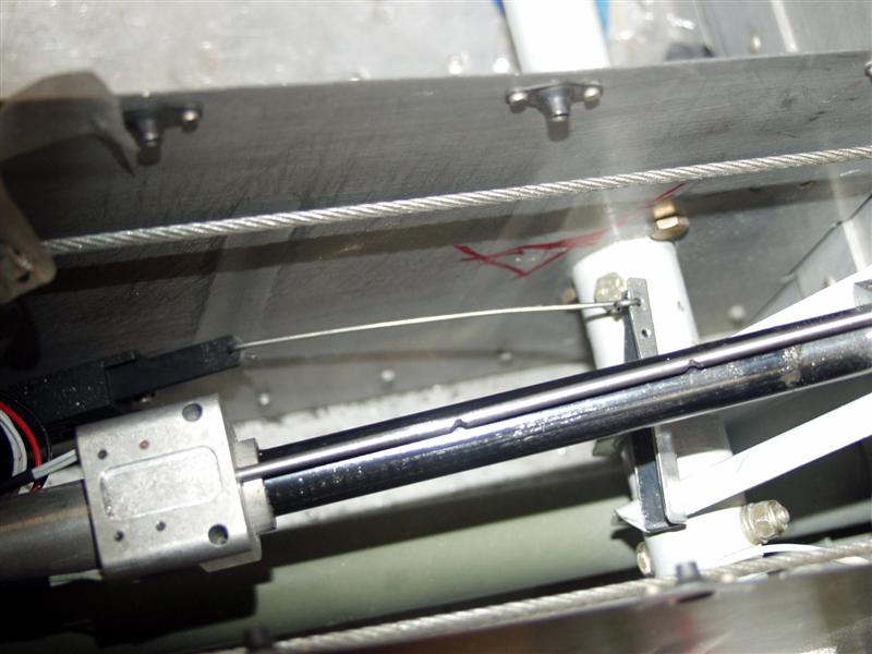

Here's what several of us have done... seems to work just fine... 2 of us with AFS 3500's.
Don
