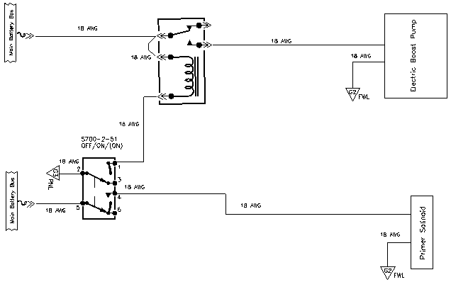

I want to have a single switch that controls my electric fuel pump and also allows me to activate my primer solenoid. The diagram below is my idea of on how this should work. I am using a S700-51 switch. In the first position, the electric fuel, pump in off. In the second position, the fuel pump is on. In the third position, a momentary position, both the fuel pump and the primer solenoid are on activating the primer. Will this work? Is there a another approach I should consider?

The circuit looks like it will work as planned. A small diode across the relay coil (with the arrow pointing towards positive) will help to prolong the switch life.
