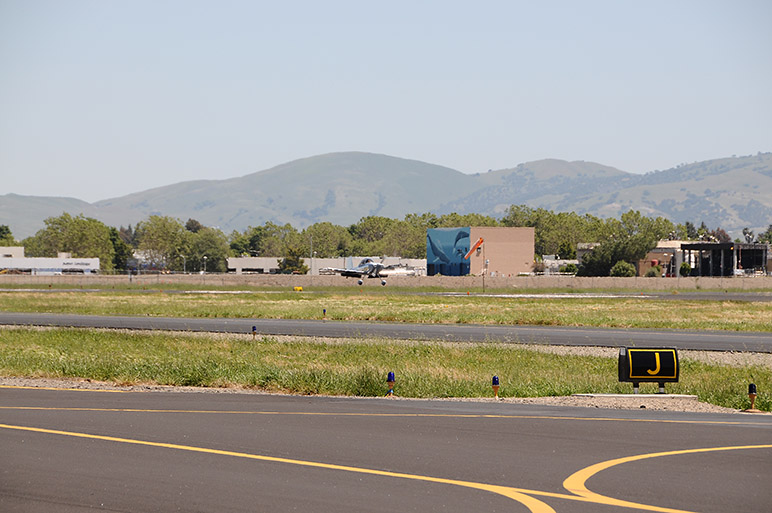

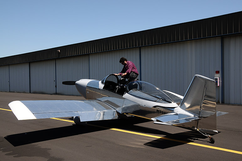

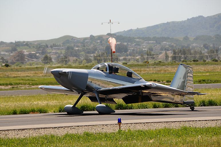

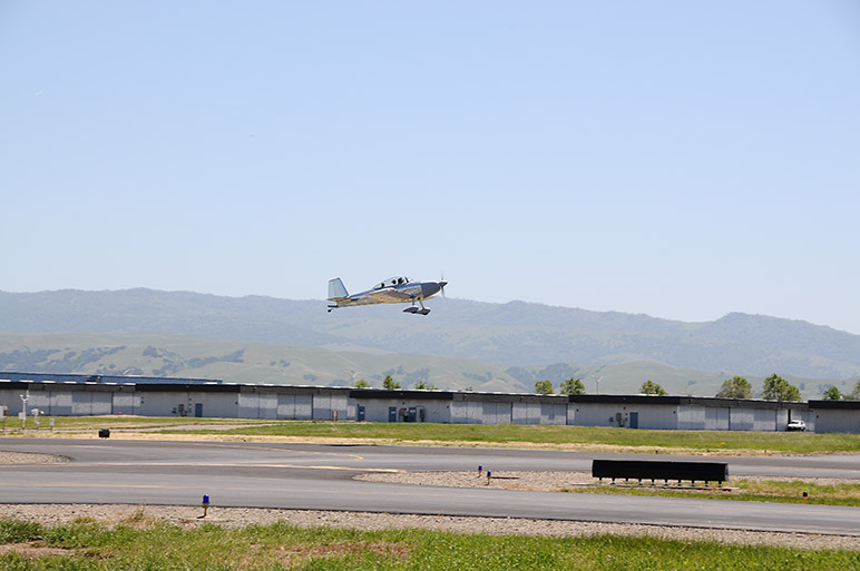

Monday May 2 2010 at 1:15pm, RV-8 #82880 N998RV took to the air for the first time! The first flight was about 30 minutes and all systems worked as expected. The only post-flight adjustments necessary were an increase in the amount of available Up trim, and a decrease in the upper RPM limit on the Hartzell prop. After a smooth takeoff, I climbed out and circled the airport at about three to four thousand feet for a couple of circuits then came around and landed making a nice three-point landing with no bounce. The plane handled excellent and the power from the IO-390 and the Hartzell can only be experienced to be believed! What a great combination!

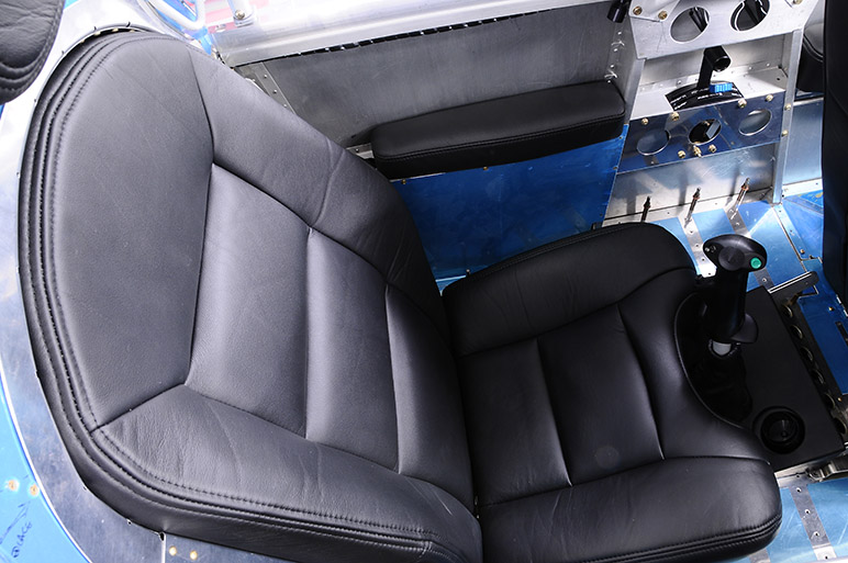

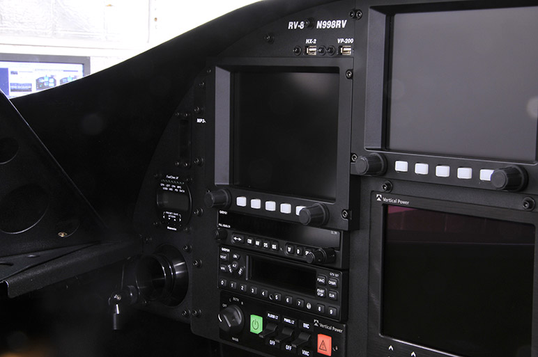

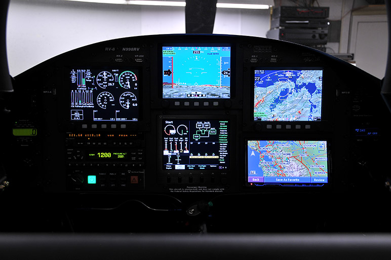

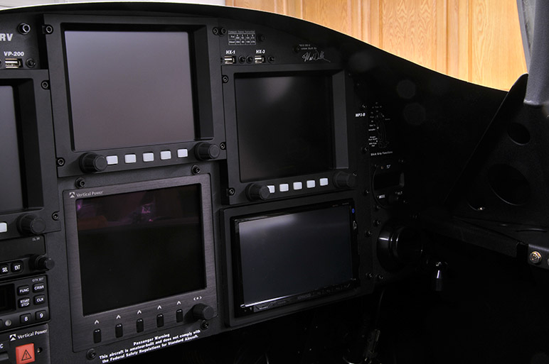

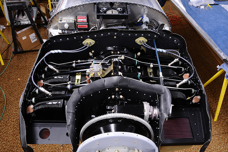

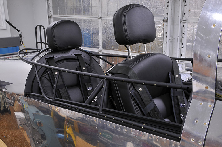

Attached are some pictures from the first flight and few shots of the engine, panel, and interior. Below, I've listed the system highlights.
Build Hours: 2457 Hours
Build Time: 23 Months
Kit: Van's RV-8 QB

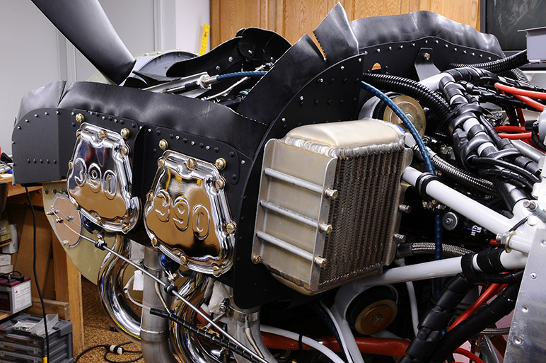

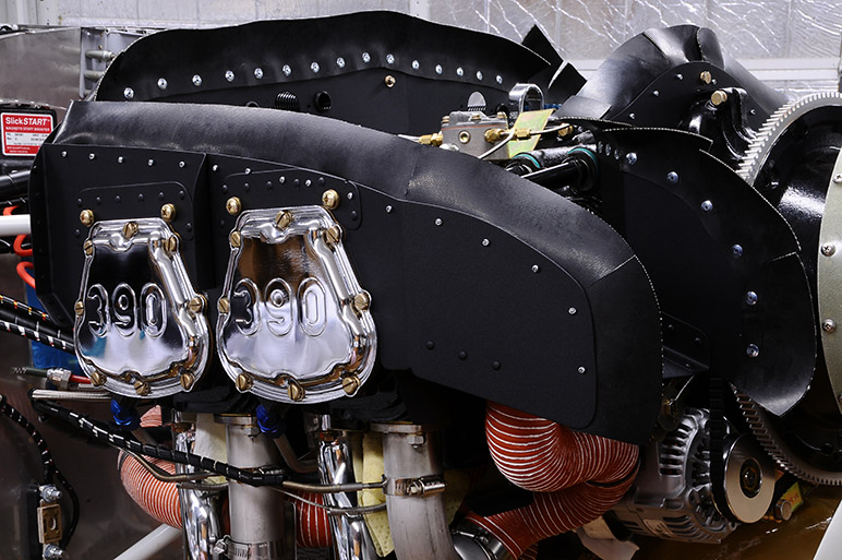

Engine: Lycoming IO-390 210hp
Ignition: Slick Mags w/ Slick-Start Module
Exhaust: Vetterman IO-390 4-into-4 System (Sounds Great!)
Prop: Hartzell 72" Constant Speed
Governor: PCU5000
Alternator Primary: 60a Plain Power Belt Drive
Alternator Secondary: 20a B&C Direct Drive w/ B&C External Regulator
Steam Gauges: NONE!
Flight Instruments: Triple 6.5" GRT HX / Dual GRT AHRSs / Dual Magnetometers
Realtime Weather: XM Module For GRT HX & XM Module For Kenwood DNX-8120
Autopilot: TruTrak Digiflight II VSGV Two Axis w/ Auto Trim Module
Fuel Flow: Matronics FuelChec DX
GPS: Dual GRT Modules (Garmin engine)
Radio: Garmin SL-30
Transponder: Garmin GTX-327
Electrical System: Vertical Power VP-200
Entertainment: Kenwood DNX-8120 with 7" LCD / Psgr 7" Remote LCD
XM Radio / DVD / 64GB MP3 / HD AM-FM / XM Weather /
Full Bluetooth integration with Blackberry (make
and receive calls through headsets)
Intercom: PS3000 Stereo
Headphones: Bose Aviation Headset X

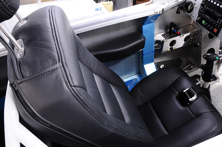

Interior: Classic Aero - All Leather over All Comferfoam
Carpet: Custom design - Cut & Sewn by Classic Aero
Oxygen System: Mountain High O2D2 w/ Electronic Tank Valve & PSI
Seat Belts: Hooker 5-Point Harness
