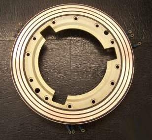

Bob, it is the brushes that transfer the power to the prop motor on the hub,,, not the actual pitch change motor itself.
THAT is a very difficult set of components to optimize to
design goals. Brushes on alternators run on the smallest possible
diameters and smooth surfaces. Smoothness reduces wear, diameter
controls surface speed under the brushes. Brushes in tiny
motors benefit most from their tiny commutators . . . in spite
of having to run over a segmented surface.
Brushes that carry power to a moving prop hub DO benefit from
smooth surfaces . . . but they run 100% of the time, are exposed
to environmental contaminants, and have high surface speeds. A
de-ice slip ring for a three bladed prop . . .
[img]cid:.0[/img]
can be about 10" in diameter and has three slip rings.
Brushes are a high-maintenance item on these systems
too.
