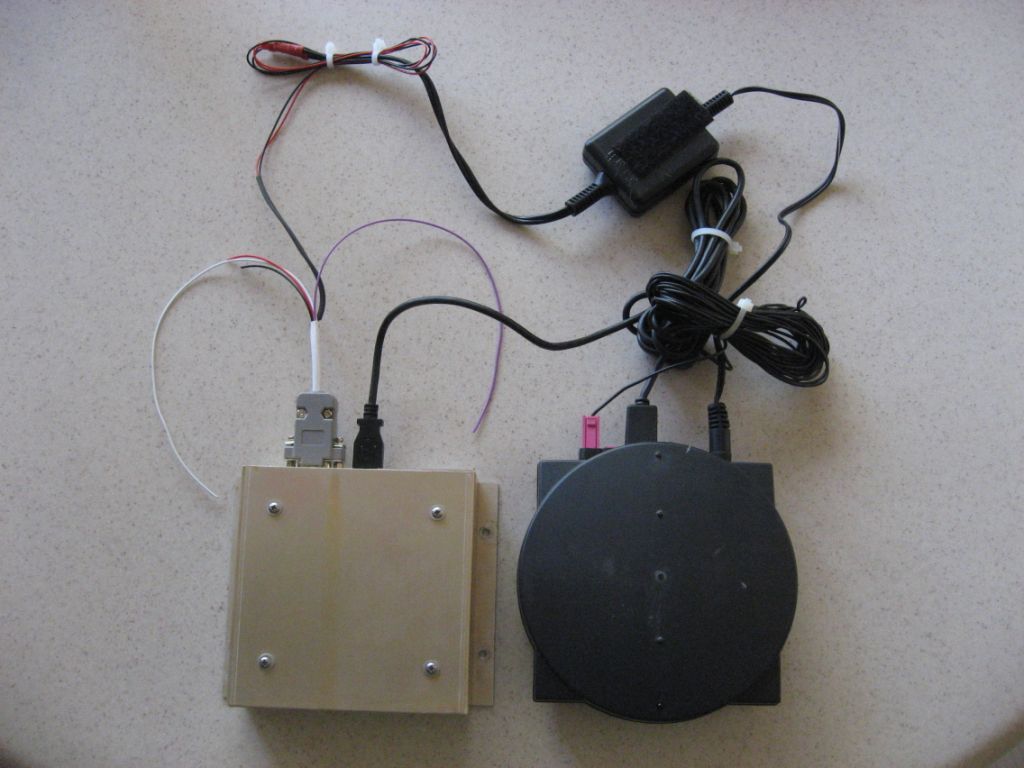

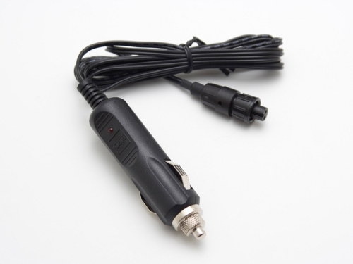

Does anyone know who's the manufacturer of the power plug used on the XM receiver box? See attached picture.
I'd like to use aircraft wire to hook it up instead of the wire they supply with the box.
Lenny

PostPosted: Mon May 03, 2010 2:02 pm    Post subject: WxWorx connector Reply with quote
If it's like the one I just sold it is a dc power plug.
Looking at the picture the left box is the GRT processor; the right puck is
the XM receiver. The connections are the antenna (pink), the data connection
to the GRT processor, and the DC power plug.
The ultimate power connections of the whole system is the red/black wires
out of the Dsub on the GRT processor. This may help.

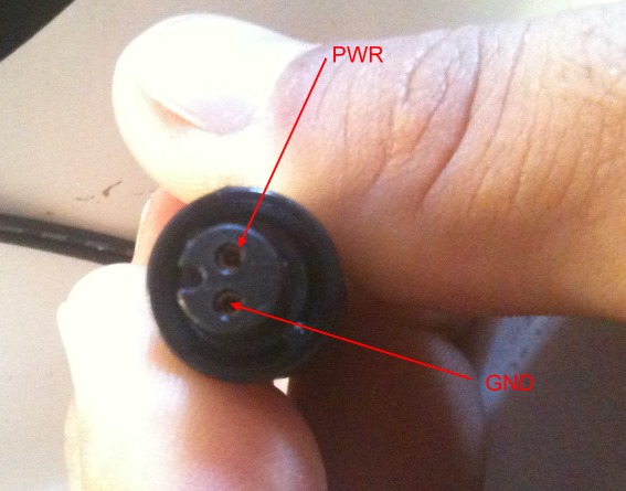

My connector has the two pin plug as shown in Lenny's pic, however, the other end terminated in 16 ga. red and black wires with an in-line fuse. When cutting the wire to connect to the lead wires from my panel buss, I cut on the wrong side of my marks and can't tell which pin is the power wire. My WXWorx box is a single black box with a USB to the GRT screen, the antenna, and the power wire I cut. I have no diagrams from the manufacturer showing the pin identification, and I have been unable to contact any manufacturer that can/is willing to help. Looking at the end of the plug Lenny has, with the notch down, which wire is positive is what I need to determine.

The connector is made by Conxall. I bought additional connectors at Digikey. They are in the Digikey catalog on page 264-265.
Pete

Eric,
Checked my connections. See the attached picture.
Jesse, thanks for that idea! Not bad, but now that I found the connector, that will be a better solution.
Lenny

Eric_Kallio
Joined: 29 Jan 2006
Posts: 149
Location: Baton Rouge, LA
PostPosted: Tue May 04, 2010 11:42 am    Post subject: Re: WxWorx connector Reply with quote
Thats what I needed! Thanks Lenny!
