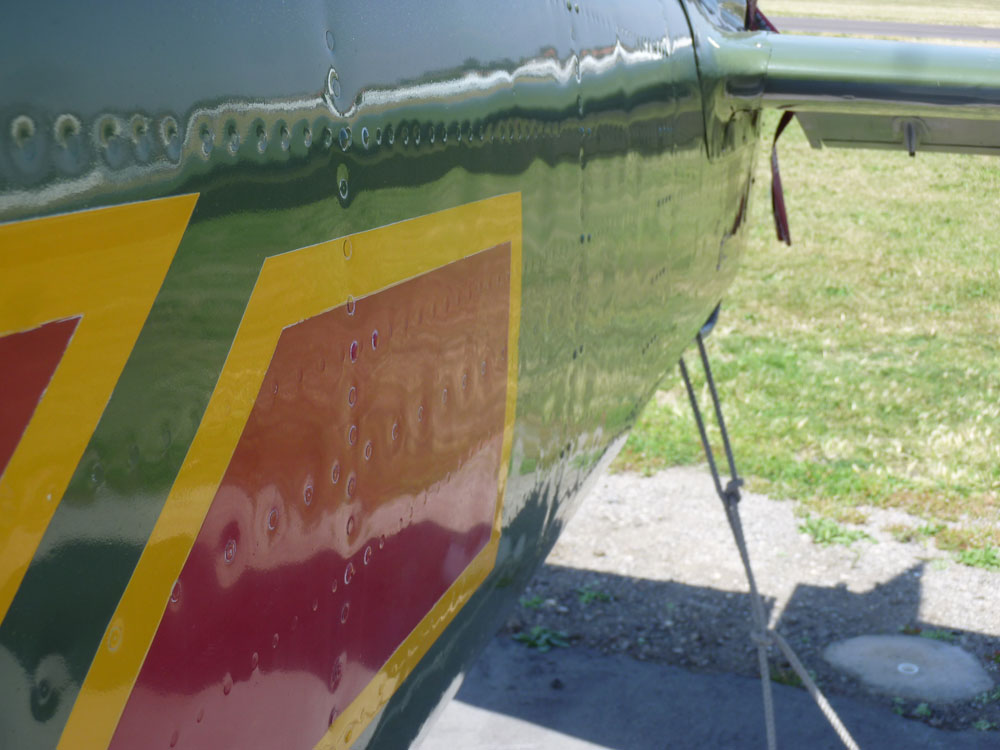

While working on my plane at Santa Paula, one of the many A&Ps there happened by and was looking at my fuselage and said "wow, that plane must have been overstressed at some point". We sort of ignored that but since then I've noticed that my fuselage skins are more "wrinkly" from behind the back seat to the tail. Compared to the "Fresh Off Boat" one I saw today, that one had nearly perfectly smooth fuselage skins.
My plane is one of the first CJ-6s imported into the U.S. in 1991 and had an estimated 3500 hours when imported so now has something like 4900 hours on the airframe. I know that's nothing compared to most other planes but since it appears to be the (or one of the) highest hour planes around, it made me think.
Am I the "guinea pig" for Nanchang hours? How would I determine if the wrinkly skins are "normal"? The local Nanchang guys don't think anything of it but what do you guys think?

This is pretty hard to photograph. Here's one photo and a link to some more on line. What I'm looking at are the "dents" that are on the flat panels between the rivets. There is one set that run around the fuselage just in front of the horizontal stab. In the online gallery, you can click the photos to see them bigger. I've seen similar dents in similar locations one one side or the other on some Nanchangs but not in this quantity.

Those "dents" always look worse with a sweet shiny paint job like yours especially when looking down the side like your photo. Your plane looks like every other CJ I've ever seen including my own.

I agree with Keith, I Honestly don't see a problem with the aircraft Pete..

I have a 1962 CJ with about 4300TT... I have the same dents and have seen many others with the same.

I don't know CJ's but those "dents" look like spot welds.

My CJ has the same amount if not more. The 737-300s that I fly routinely have way more. Ever been up close to a B-52? The fuselage will make you sea sick if you run your hands over it.

Many series of productions used spot welding (not sure on the years, but it was later than 66, I think), but looking at the pic Pete provided it looks like rivets to me. And it just looks like less than ideal riveting from a production line that was still learning the art. They did get better....late 60's were the prime production years for these airplanes. I've seen a couple of new CJ's that don't look nearly as good from a sheet metal finish stand point as many more vintage editions... That picture certainly doesn't denote something to be concerned about from a structural standpoint.

I believe spot welding on the CJ6 was introduced on 1969 models at the same
time they started using alclad rather than anodizing.
They eventually went back to rivets and anodizing but I don't know what
year.
Pre 1969 riveting was for the most part quite well done. Far better than
the few newer ones ( late 1980's) I have seen.
Another change that came in 1969 was the total elimination of fuselage
frame/stringer clips. They probably determined that these were unnecessary
with an airframe life limit of 4000 hrs.

Since you guys mentioned it, I went back and look and, sure enough, my 1966 is spot-welded on the rear fuselage panels where they're secured to the stringers but riveted where the panels overlap or are over formers. It also has button head rivets where the formers "cross" the stringers.

That's a better shot, Pete. Yup...wasn't sure when they spot welded....good to know. All the more reason for the "wrinkles" and it's highly likely you have nothing to worry about here as it relates to structural integrity. Besides, this being Kilo's former bird, I'm sure it never saw more than 4 G's...he getting along in years and such... Twisted Evil
