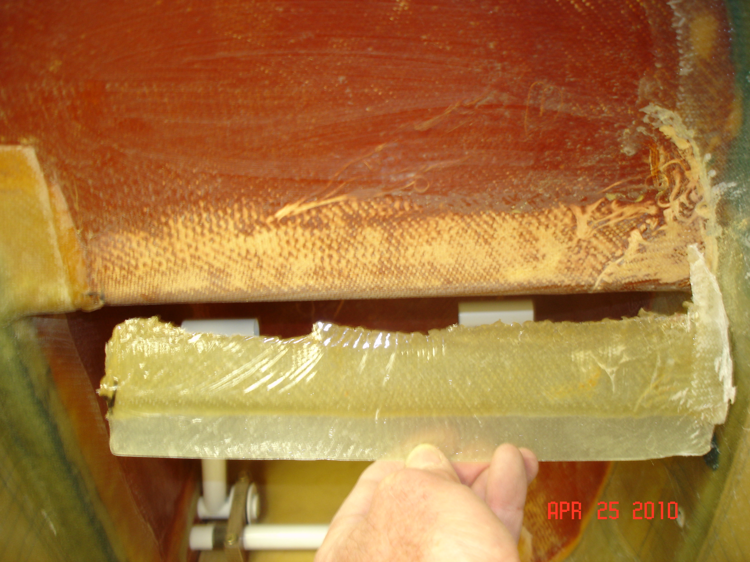

I have run into an alarming situation. I find epoxy BID applied to the firewall material does not have great bonding characteristics. I have not seen this brought up before. I discovered this, as to attach the instrument panel, I epoxied a 4 ply BID flange onto the lower firewall inside face. After cure, I was shaping the flange and found that it peeled away without much difficulty. This brings into question the bond of all the many places that fiberglass BID is used to reinforce the reduxed joints on the firewall. I have attached a picture showing the scuff sanding preparation I did to the firewall surface. Hopefully the photo remains attached. I am using new epoxy and no unusual temperatures were prevalent. The epoxy cured as expected so the epoxy mixing proportions shouldn't be in question. It seems that the phenolic firewall material just does not allow a good epoxy bond? Is this something that is known and expected or is this not as it should be?

Can you tell us how you prepped the firewall for bonding?
It needs to be chemically clean and well scuff sanded to provide
a good key.
Bill,
Your scuffing looks about like mine...as a rule, in addition to
scuffing, I fire up my compressor to blast away loose particles before
wiping surface down w/ acetone...then brush on a tack coat of
resin...and, only then apply BID. Near as I can tell, my BID tapes on
the firewall are not suspect.
your mileage may vary,
Fred

Thanks for the replys, I am at a bit of a loss as I followed my usual routine, scuff sanding (80 grit)cleaning with alcohol then allowing to fully evaporate (clean paper towel), laying up the 4 ply on cellophane to insure proper wetting of the layers of glass, and I had done the surface prep just prior to layup so not likely and air borne contaminates got on the surface. In this case I left the cellophane on top as I used the instrument panel against it to establish the mating of the flange and the panel. No peel ply used. I would guess that if any mold release was used in the original creation of the fire wall, it was on the other side, in any case as usual, I took the surface down to newly exposed material. I have tried to separate or pry off an epoxy to epoxy surfaces before and it is undoable, but has to be sanded or ground off. I have also had to remove a reduxed phenolic pad and it also can only be ground off. Maybe it only leaves to do another test lay up as again see if I can pry it off.

Well, the description and picture are identical to what I experienced
with the strenghtening and flap drive bonding of one of my wings. In
that whole area all epoxy work just snapped loose if I pried with a
screwdriver.
Disturbing was, that after a second attempt (even more sanding,
cleaning, double checking proper mixture, temperatures, etc.) I got into
the same situation again. For some reason it was impossible to get a
proper bond in that area.
General consensus was that there must have been some release agent
residu from the factory left behind, or silicone contamination from
whatever source (maybe a factory employee wiped off some spoiled coffee
with a contaminated rag?)
So, in the thirt attempt, I not only used acetone, but also soap, gas,
alcohol, vinegar, and a dozen other solvents, to get this invisible and
unknown "release agent" off.
One of these solvents must have worked, because after that the bond was
finally OK.
I just keep wondering how many others must be flying around with a
similar local contamination and never found out about it because
everything just looked right.
Because of this experience I have subjected all my bonds to the
"screwdriver" test. You should pry until you get some fibers off as a
proof that the bond is ok. If you instead hear a "snapping sound" and
the whole layup changes color, you have the dreaded "contamination error".
And yes, my firewall bonds survived the "screwdriver" test. There were
no other problem area's, only this specific area of one of my wings had
this "impossible to bond" problem.

After having done some additional tests, bonding epoxy to the phenolic firewall material as well as testing of my previous firewall bonds, I have satisfied myself with a conclusion. It is that epoxy does not form even a somewhat adequate bond to any unabraded glossy phenolic firewall material. The bond is almost non existant compared to that of an otherwise epoxy to unabraded epoxy bond. So leaving any glossy phenolic surface unabraded is well more detrimental to the overall bond than leaving some unabraded area under a epoxy to epoxy lay up.
I still consider that on the areas where only one ply of glass/epoxy is over the foam sandwich, one has to be careful not to sand off too much of that single ply to get down to a complete abraded surface, not so on the phenolic firewall material.
The front (engine side) of the firewall, requires less sanding and material removal to get below the glossy surface, as it is smooth having been against the mould in the original lay up, compared to the less smooth firewall backside with its depressions from the embedded woven material. So you just have to remove more material on the firewall backside to get below all the gloss for an adequate bond.
Contamination on surface was not the culprit in my case. Though removal of real or potential surface contamination is alway a necessary step in bonding preparation.
