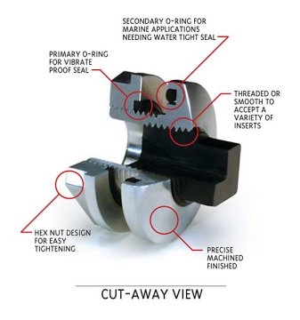

These look pretty interesting for new wire runs... http://precision-grommets.com. Lots of sizes and available in stainless too.
Jay
[img]cid:.0[/img]
Certainly a class act product. Keep in mind that
the PRIMARY purpose of a grommet is to mechanically
separate and isolate relatively vulnerable wire
insulation from the sharp edge of a fire-wall
sheet or other thin penetration. Maintaining
fire-wall integrity calls for gas-tightness with
some degree of resistance to fuel fed flames.
Of course, the classic rubber/plastic grommet has
no resistance to flames so we have to add the
steel shields and fire-putty to add flame resistance
to the assembly.
Grommets like those shown above are obviously
flame resistant but we're still interested in
the best-we-know-how-to-do for gas tightness
too. So perhaps the fire-putty fillet on the
engine side is still called for.
