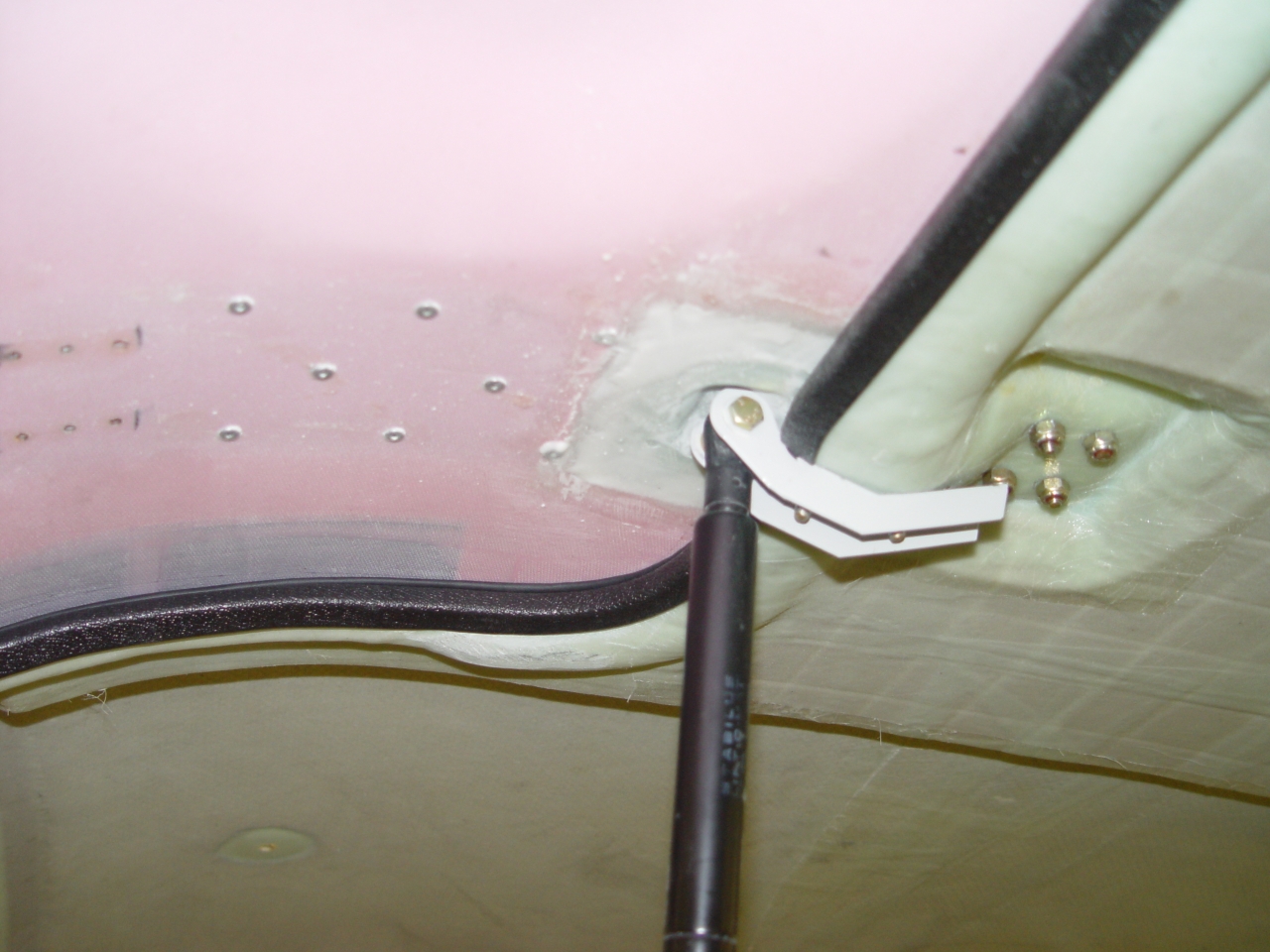

Photos? Especially of running the seal around the door hinges and/or strut area.
Jay

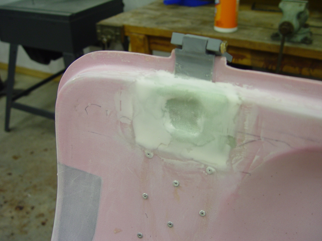

PostPosted: Sat May 15, 2010 12:39 pm    Post subject: Cabin frame and Mcmaster-Carr door seals Reply with quote
You've probably already received some photos but here are mine
Jay
http://forums.matronics.com/viewtopic.php?p=297349#297349
