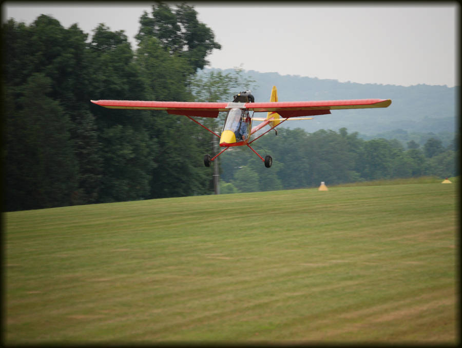

PostPosted: Fri Apr 30, 2010 6:26 pm    Post subject: Re: Nose down at higher speeds. Reply with quote
Mark,
To prevent, or stop the tail wag/wing shuffle keep both feet on the rudder pedals.
Full wind screed "shape" affects nose down moment at increased speed.
Narrower and round is better than wide and flat.
The goal is to have the wind deflect around to the sides of the wind screen and fuselage rather than up over the top of the wing.
I've tried both shapes, and while wider and flatter is more roomy, narrow and round is more efficient and makes the plane pitch neutral which is a much safer flight characteristics at higher speed.
attached is a photo with the narrow rounded wind screen which increased my top speed about 10 mph.
My other wind screen was the full width of the wing gap cover and approximately flat along the leading edge of the gap cover.
Gene
