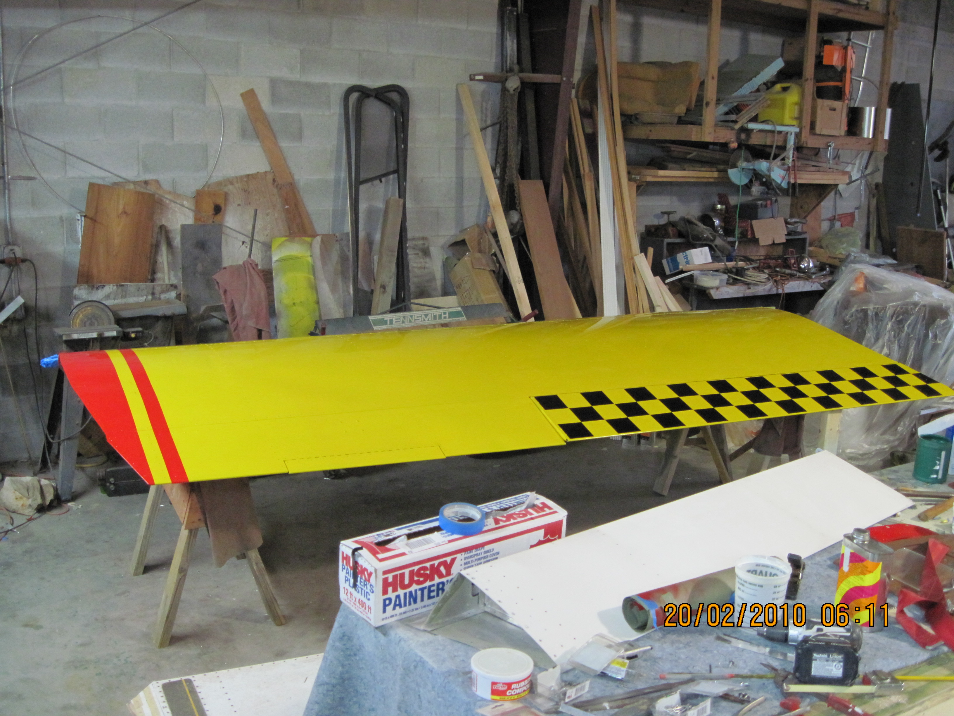

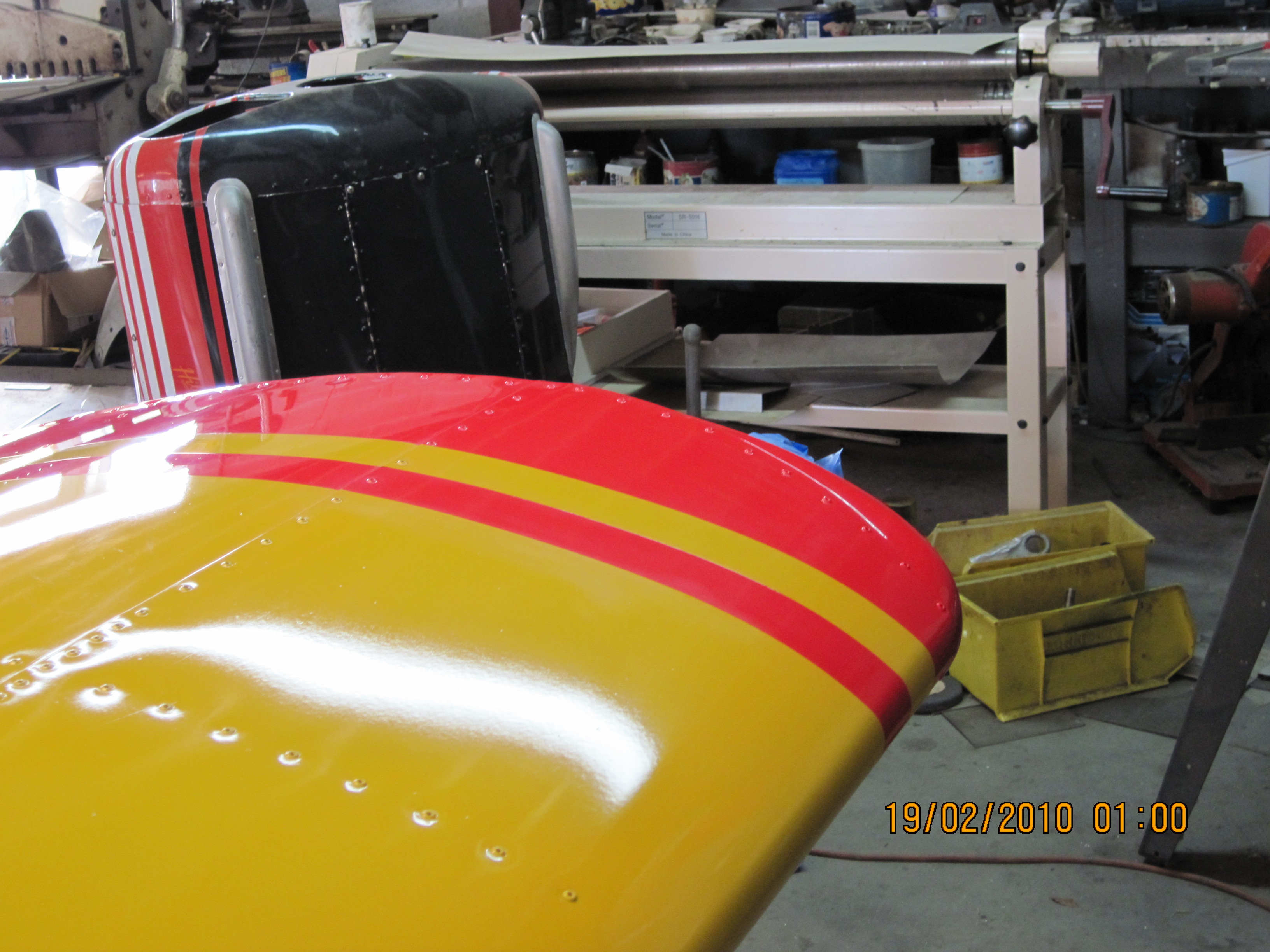

PostPosted: Mon Apr 26, 2010 3:37 pm    Post subject: PAINT Reply with quote
Well,here we go again I just started to paint after my refit,and it went something like this strip all paint to bare metal, coat with self etching primer then paint with filler primer,then hand samd with#320 paper making sure to get in betwen reivets that makes for a very smooth,and porus surface to shoot your acrylic enamel (Omni) used light hardner and more thinner than we were told to. Ins. said three coats , so we did three. Take a look,I like it. Worked out to 1 1/2 gal for two wings plus thiner and hardner Joe N101HD 601XL-B
