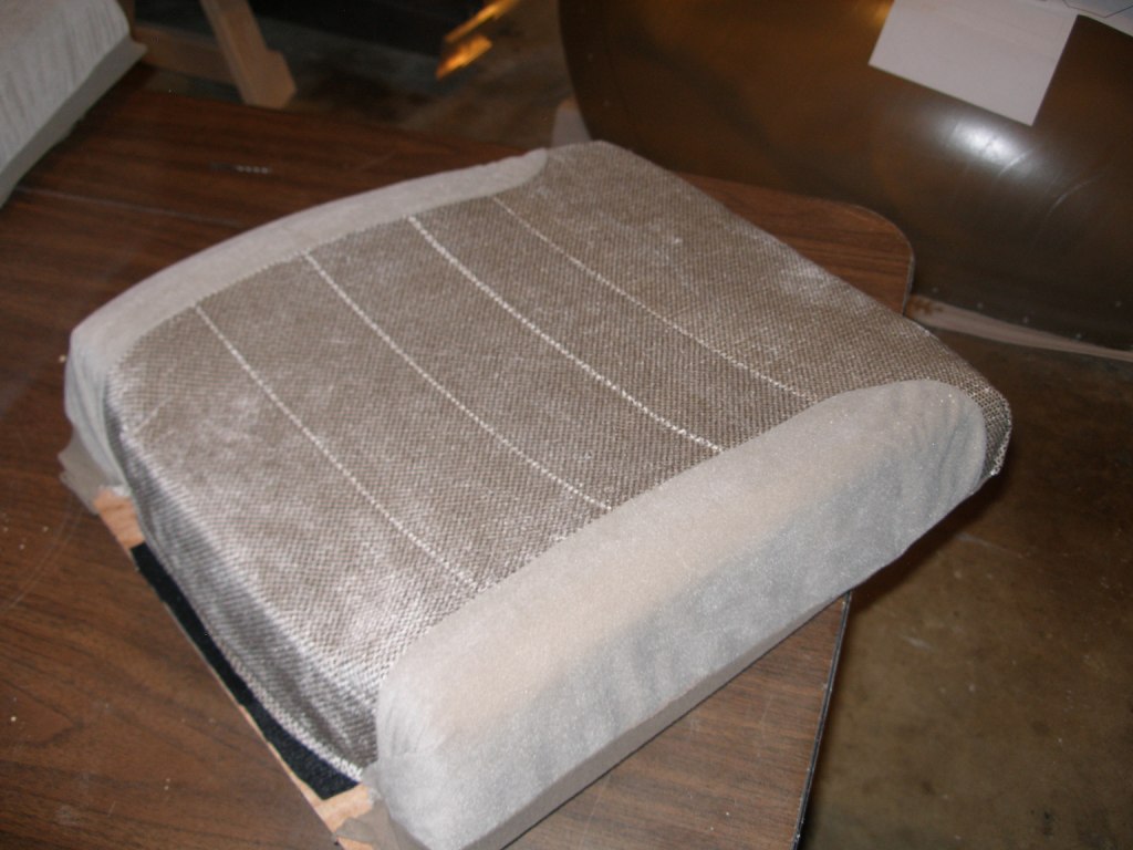

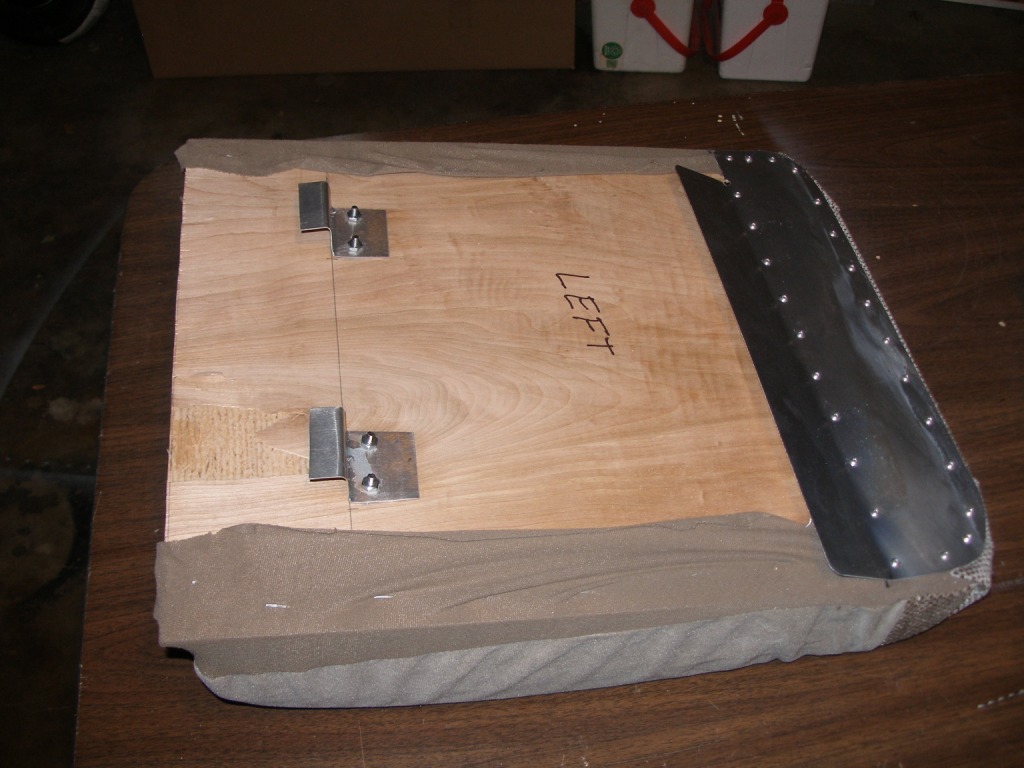

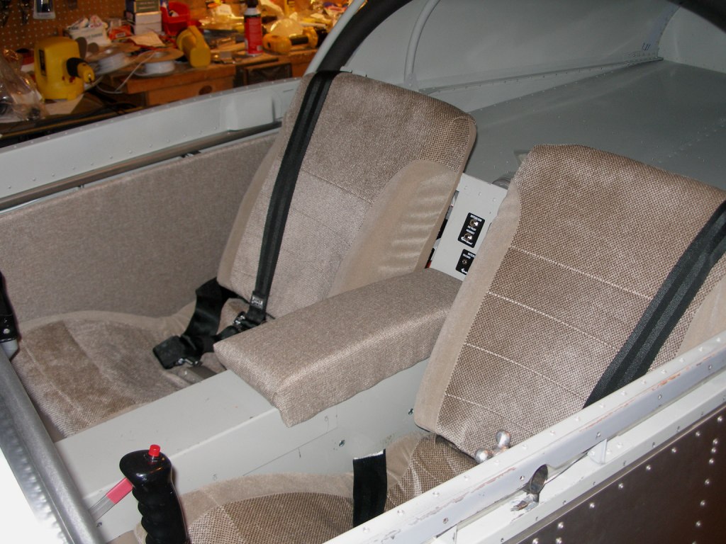

Here is what I did. That's 1/4" plywood, aircraft grade, of course  (;>) from the aircraft section at Lowe's.
Jay

I had some 3/16 plywood flooring laminate that I used for the seat backs. I used a piece of aluminum L riveted to these and bent down over the top of the baggage shelf lip to hold them in place, similar to the way Jay did his.
