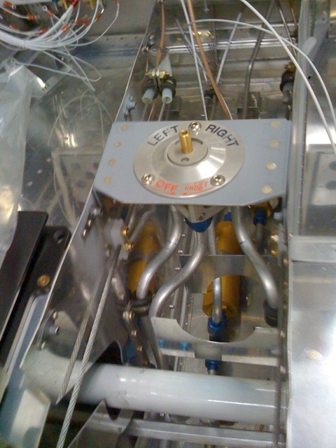

Hi Rob,
I installed Andair Valve 20X7T as it came from Vans at the top of the
tunnel cover. It took some careful tube bending to route the scat
under the valve.
Jeff Carpenter

I used the FS20x7m. I ordered the 12" extension, then cut it down to about
three inches. This is what you'll need if you use the current location for
the fuel valve per plans. I don't know when Van's moved the location of
the valve. I got my fuse kit about 14 months ago. The new elbow fittings
look like you can get even more flexibility.
Bob Leffler
N410BL - Phase I
http://mykitlog.com/rleffler
