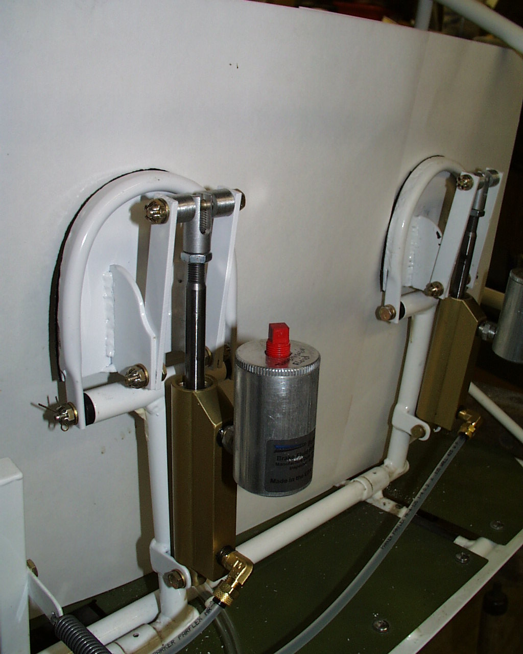

I finally got back to working on the brakes. The c-90 brake calipers now being used on the MK-3x and others require a brake pedal ratio of 4:1 to have really good braking power. The pedals being used on our Kolbs have a ratio of 1:1 or less, according to Matco. If you don't seem to have good braking power, this is probably your problem. I have been thinking about this for a while, trying to find an easy way to modify what we already have. The picture should answer any questions you may have to modify your existing pedals. This arrangement should give you a ratio of 3:1. You could improve even more on this by raising the top of the pedal another inch giving you the full 4:1 ratio called out for the the instructions.

could you press one of the pedals in a pic to show how this system works from what I see in the pic all it would give you is more dead linkeage but I could be wrong

Yeah, Ellery, that's what I thought, too.  It must work better in real life than it looks like in the picture.

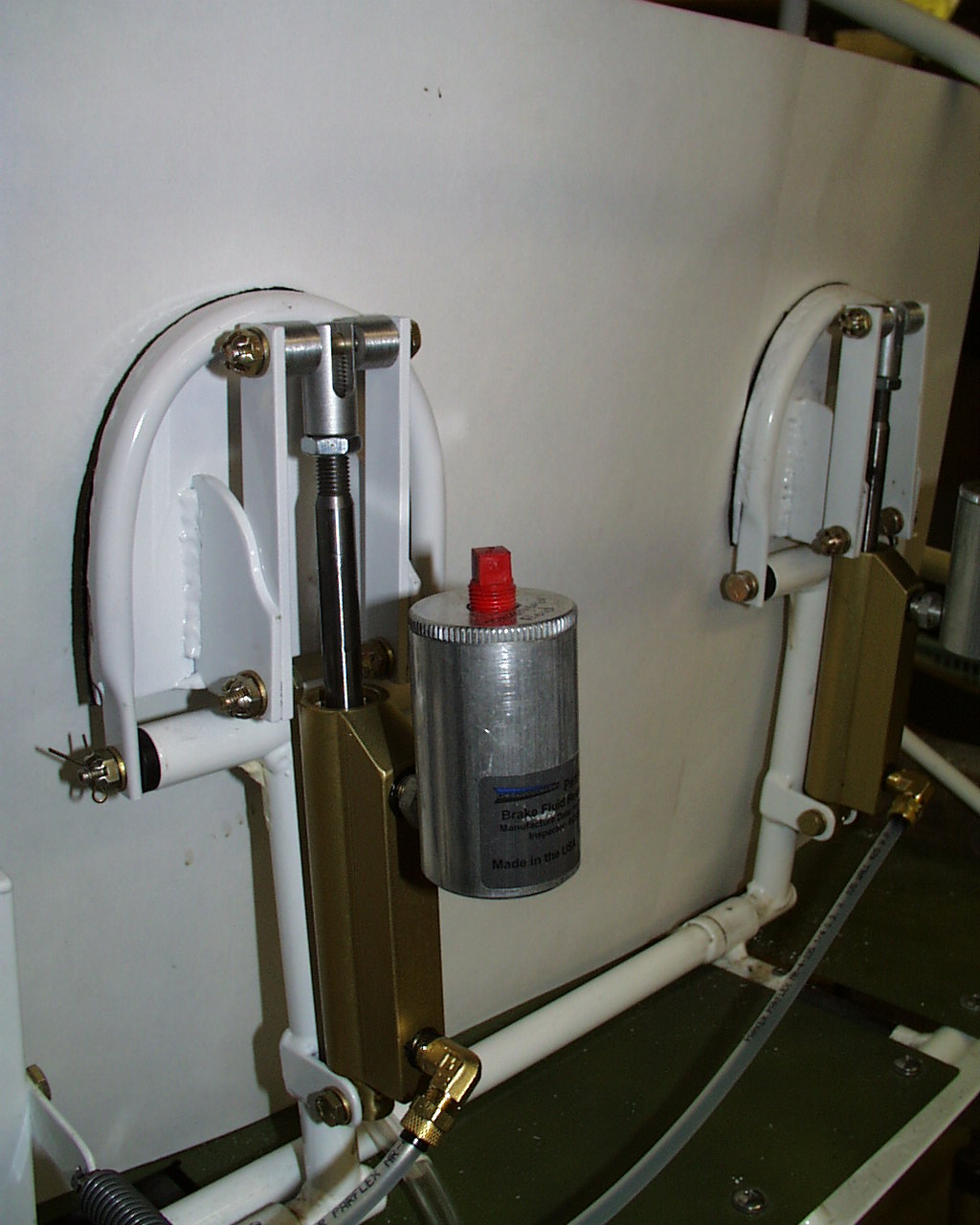

This arrangement will give you a 3:1 ratio at the pedal. Look closely at the attach points and you will understand how it works. The lower two bolts are 1" out from the pedals plate, and the top of the pedal is 3" up from this point. This give you the 3:1 ratio. After making the initial prototype I could instantly feel the difference. Try to think of this as a crowbar pulling a nail, only this is pushing a rod.

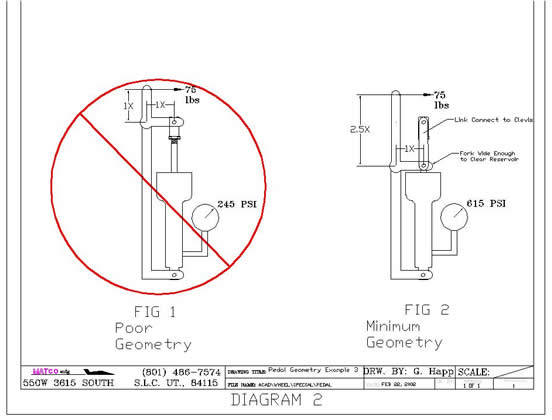

This drawing, from Matco, is were I got the idea on the configuration I'm presenting to the group. Going to there site will clear up anyone having a hard time understanding how this pedal configuration increases your braking power. What I was trying to do is come up with an easy way that everyone can increase there braking power with a simple modification. It really does make an incredible difference. I did a similar method on my previous home built, a Cozy.

I am pretty good at working with mechanical things and I just dont see how that setup will do what you say it will you can send a pic of a pedal pushed and that will tell the story much better than your explanation

What is important here is the force that can be applied to the brake. The
higher the hydraulic pressure developed the greater the braking force. If
one assumes a 100 pound force is applied to the cylinder piston rod, the
hydraulic pressure developed will be force/piston area. For the 3/4 inch
diameter piston = 100/(3/8x3/8xpi) = 226 psi. For the 5/8 inch diameter
piston = 100/(5/16x5/16xpi) = 326 psi. So for the same pedal effort the
smaller bore cylinder will give 44% increase in pressure and braking.

I agree with Jack's figures
"The drawing you submitted to the list" if you have your Points as the drawings show you will only have changed the length of your pedal  and not gained anything by adding the extra linkage
because both both setups are doing the same thing with the same arm lengths pushing the plunger down to make pressure in the brake system where you are Gaining on braking power is having longer brake pedals that is all it boils down to You changed the length of your brake pedals from 1X to 2.5X that is what your drawings show
I have heal brakes that worked good with small tires on ,when I went with the 800-6 tires I lengthened my brake pedals 1.5 inches longer to make them as good as with the smaller tires I didn't change anything else on the pedals other than the length from the pivot point north
Ellery Batchelder Jr.

I can see that just increasing the pedal length will increase the leverage
available to the pilot and thus increase the pressure he can apply. Are
there any limiting factors `downline? Joints and pipes premumably have an
upper pressure limit.
