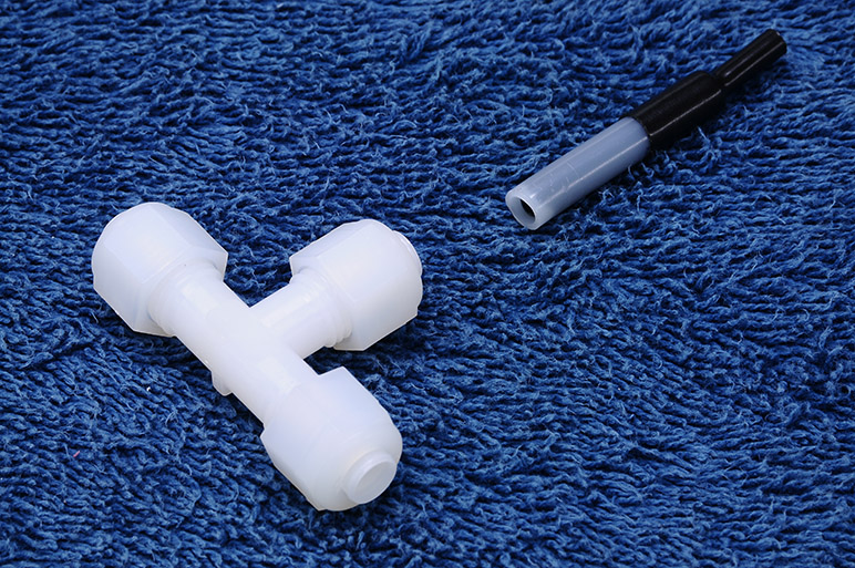

At 03:53 PM 4/19/2010 Monday, you wrote:
Matt, cut the tubing, insert a 'T' with a short stub of tubing. Put a plug in the tube of a type that you can pull out easily if needed.
Simple, light, and inexpensive.
Linn
Matt Dralle wrote:
>Dear Listers,
>Looking at the requirements for IFR certification of the RV-8, it looks like the only thing I don't have is an "alternate static source". This seems like it would be as simple as adding a "T" valve in the 1/4 neoprem static air tube that goes along under the left hand canopy rail.
>Does anyone have any suggestions on something I could just cut the tube and stick in line with a little thumb screw to switch between the fuselage or cabin source?
>I'm assuming this will meet the requirement?
>Thanks!

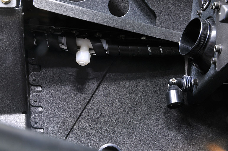

What a great idea, Linn! Thanks. Here's what I did tonight including a couple of pictures...
I added a small "T" Nylon fitting in the 1/4" tube for static air just in front of the instrument panel under the left cockpit rail. I cut a short piece of 1/4" tubing and filled it with black RTV and then put a piece of heat shrink tubing over it to form a handle. The whole thing fits nicely under the cockpit rail and from the pilot's position is just barely visible, yet can be accessed easy. In the event that icing conditions occur, the fitting can be unscrewed and the plug removed for cabin venting.

PostPosted: Tue Apr 20, 2010 7:56 pm    Post subject: Check Valve For Static System Cabin Venting... Reply with quote
check this valve to the left of the Cheltons.
From: owner-rv10-list-server(at)matronics.com [mailto:owner-rv10-list-server(at)matronics.com] On Behalf Of Kelly McMullen
Sent: Tuesday, April 20, 2010 8:27 AM
Subject: Re: Check Valve For Static System Cabin Venting...
I appreciate the data point. I think we all know that FAA inspectors are not very familiar with OBAM requirements. Has been discussed many times that there is no IFR certification of OBAM aircraft. I'd still like to see where it is required.
I suspect that the vast majority of RVs are given airworthiness inspection by DARs that are more familiar with what is and isn't required. Tail cone static ports are not exposed to impact in flight icing. Now some aircraft that have a single static port forward of the wing might have an issue, like some Cessnas. Perhaps it is a good question to pose to EAA.
On Tue, Apr 20, 2010 at 8:06 AM, C.R. Usery <drrx60(at)yahoo.com (drrx60(at)yahoo.com)> wrote:
Kelly,
You may be right on the requirements but I just had the Seattle MIDO come and inspect my RV-10 and on the list of items they wanted to see was the Alternate Static Source.
Since I had this installed we did not discuss if it was optional/required. Just wanted all to know that these FAA inspectors were looking for it.
Charles Usery
N719PD
Do not Archive

Get Clippard switch here:
http://clippard.com/store/display_details.asp?sku=TV-2SP
Jay
stein(at)steinair.com
PostPosted: Wed Apr 21, 2010 7:05 am    Post subject: Check Valve For Static System Cabin Venting... Reply with quote
I have a quantity of these on order that I'll at some point have on the
website along with the requisite quick connector that screws directly on to
them. We've used those valves on a lot of panels and planes they are slick,
work well and look pretty good. Anyway, it'll be a couple weeks, but we'll
have them sooner or later!
Cheers,
Stein
