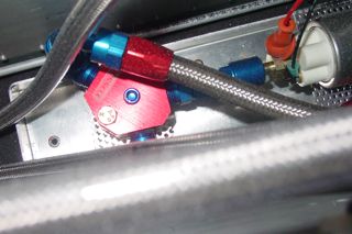

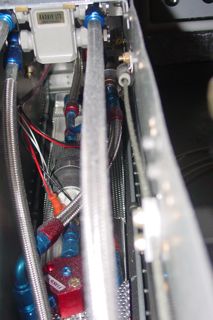

I used a combination of the existing aluminum lines, Bonaco lines, and some braided lines I made myself. If I was doing it again, i would use nothing but Bonaco lines for the Brakes, and maybe a few homemade braided along with Bonaco for the fuel lines in the tunnel.
As far as a pass through to the wings, try these:
http://www.aircraftspruce.com/catalog/hapages/an832.php
Here are a couple of shots of my tunnel. The all blue lines are Bonaco and the ones with red are mine.
John
