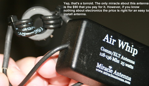

Have you looked at Miracle Antenna's Air Whip? http://www.miracleantenna.com/AirWhip.htm It's a full dipole antenna that's made completely of flexible wire. It's also end-fed, so you don't need access to the middle of the antenna for connection. You can put it anywhere in the fuselage that's not shielded by conductive parts.
I'm not flying yet, but mine seems to work very well on the ground. It fits quite well in the fiberglass nose cone of my Challenger.  Based on a quick look at a picture of a Kolb M3X, I'd guess you could do something similar in your airplane. It might save you some of the hassle you're dealing with.

  No, I hadn't heard of this one.  It sounds like this could be the perfect setup.  Do you know how the wire is "oriented"?  Can you just make a circular loop, or ????
  I do like the idea of this antenna, but since I'm between jobs right now, funds are very scarce.  Plus, I really wanted to make the antenna for my plane, just for the experience.
  Does anyone know of a DIY plan for this type of dipole end-fed com antenna?  What is in that little black box? (hopefully not some of that "special smoke" that leaks out when you touch two wrong wires together!!)
  If anyone knows of a way to make one these single wire dipole end-fed antennas, I'd sure appreciate a drawing or two.

The end-fed half-wave antenna has been around
for a long time and is a popular topic of
discussion and debate in the amateur radio
antenna forums. There's a particularly lucid
study of these beasties to be found at:
http://www.aa5tb.com/efha.html
Of course, this article is dealing with the lower
HF frequencies of interest to amateurs but the
physics scales nicely into the higher VHF range.
My sense is that while they can be "tuned" to
accommodate effects of installation, they're not
your grandpa's plug-n-play buggy whip. It's unlikely
that an end-fed half-wave stuck inside the fuselage
of a composite aircraft will be optimized out of the
box for that particular installation.
Having said that, we also know that antenna efficiency
in airplanes can be all over the map and still provide
satisfactory performance. I have no doubt that the
antenna offered has many "satisfied" users.
If the builder is not DIY shy, a few dollars in
materials can be crafted into an quarter-wave
over ground-plane antenna that will certainly
perform as well with more predictable results
for SWR. Getting to the center of a half-wave
dipole isn't hard if you put the center
half way up on the side of the fuselage and
wrap around the inside surface.
Distorting from a straight antenna will have
the effect of electrically lengthening the
antenna so trimming after installation with
some form of SWR instrument would be useful
. . . but probably wouldn't produce observable
differences in performance

PostPosted: Wed Apr 14, 2010 1:32 pm    Post subject: Re: copper foil groundplane Reply with quote
Inside the magic box
 Filesize:  53.02 KB
 Viewed:  14017 Time(s)
