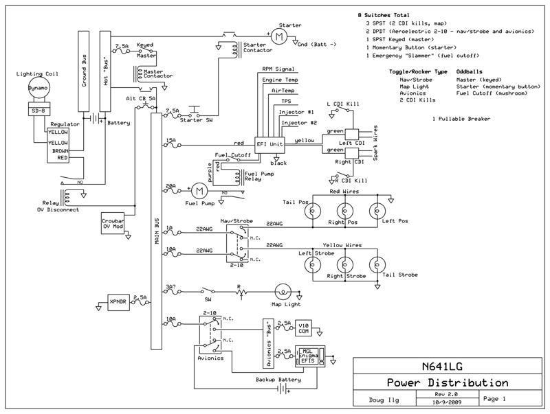

Folks,
Attached is my schematic diagram for the power distribution in my Challenger II as a 300 dpi .jpg. I tried to send a .sch file from ExpressSCH, but the list software refused it.
Anyway, I started with Z-17, but had to change a few things to accommodate the fuel injection system. This is for a Hirth 3203.
A few notes:
* Pay no attention to wire sizes. I have not really done that analysis. As a general rule, though, I plan to use 20 AWG for most things, with 4 AWG welding cable for the fat wires.
* The Hirth lighting coil is good for about 250W, which is about 21A (at) 12V.
* The switch logic for the small (1.7Ah) backup battery is pretty much as suggested by MGL (the EFIS' manufacturer). I combined it with the power for the radio and EFIS, to save space. I plan to wire it so down is off, middle is backup power and up is ship's power. In the up position, the EFIS will charge the battery. The middle position is really only to check that the battery is working.
* The transponder has a built-in power switch, so it was not ganged with the others.
* The EFIS contains low-voltage warning alert.
* The main battery will be an Odyssey PC625, 16Ah.
* I'll add a filter cap on the VR output, if it becomes necessary.
I think that covers it. Now, I'll sit back and watch the fireworks!
Thanks for checking it out.
-Doug

Doug,
The way to let others open a file is to save it on a file sharing website and then provide a link to it on Matronics. I use WindowsLive. Even though it is designed for photo sharing, you are allowed to share files with various extensions.
4AWG seems big for a small engine unless the battery is a long way from the starter.
Placing diodes in parallel across the relays and contactors (with arrows pointing towards positive) will protect the controlling switches from arcs and sparks.
Switching the grounded side of the master contactor instead of the hot side will minimize the number of hot wires running to the instrument panel.
An avionics switch is not recommended because if it fails, everything connected to it stops working. In your case, there are only two items. If each has its own on-off switch, then an avionics switch is not needed.
Joe

Joe,
Oops.  I guess attaching the file was a faux pas.  Sorry.
Would you say that 6AWG is good enough for the fat wires, then?
Another oops.  I have those diodes across the coils on my diagram.  Sent the wrong one.
Good point on switching the ground side.  Will do.
For the avionics switch, both of the switched units (EFIS and radio) require external switches.  Wish they didn't.  I'll consider separating them if I can find enough room on the relatively small panel.  (The switches I'd like to use are rather large.)
There is nothing wrong with the way that you did it. I was only trying to explain how to share a drawing with the extension of sch.
I do not know. It all depends on the current draw of the starter and length of wire. My Rotax 912 comes with 8awg for the starter. What have others used on your type of plane and engine? You could try smaller wire and if the engine cranks too slowly, then replace the wire with a larger size.
I assume that your plane will be used for low and slow fun flying. As long as failure of the avionics switch does not disable critical equipment, then having one switch for two devices is OK. Separate switches are ideal but one switch will work.
