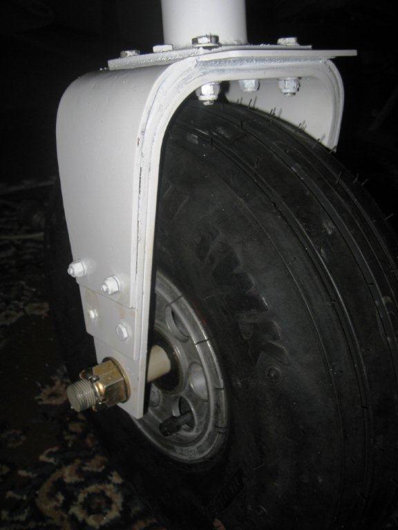

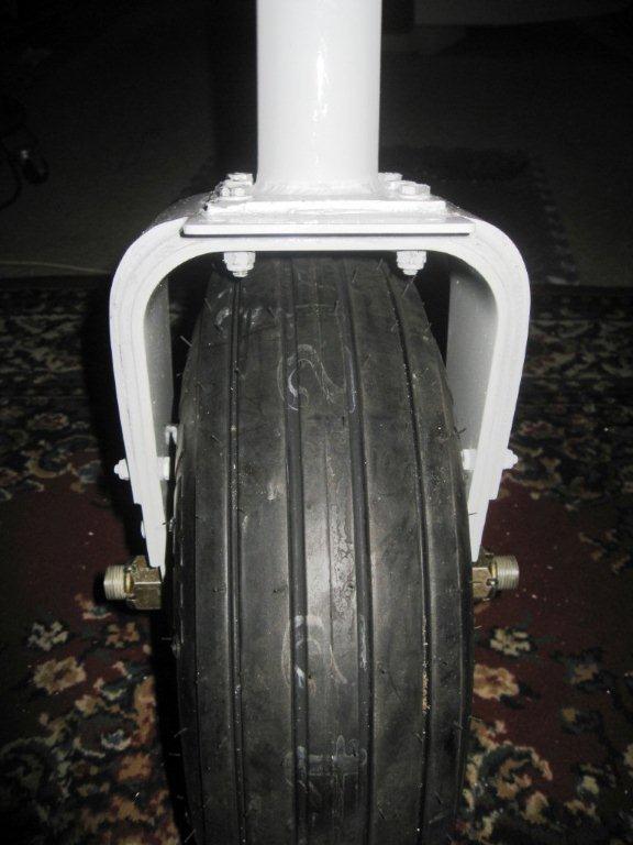

PostPosted: Thu Apr 29, 2010 1:03 am    Post subject: Re: Nose Gear Reply with quote
Beefed up nose wheel fork made from 1/8" 4130 plate and bonded with tank sealant for good measure Cheers T87
