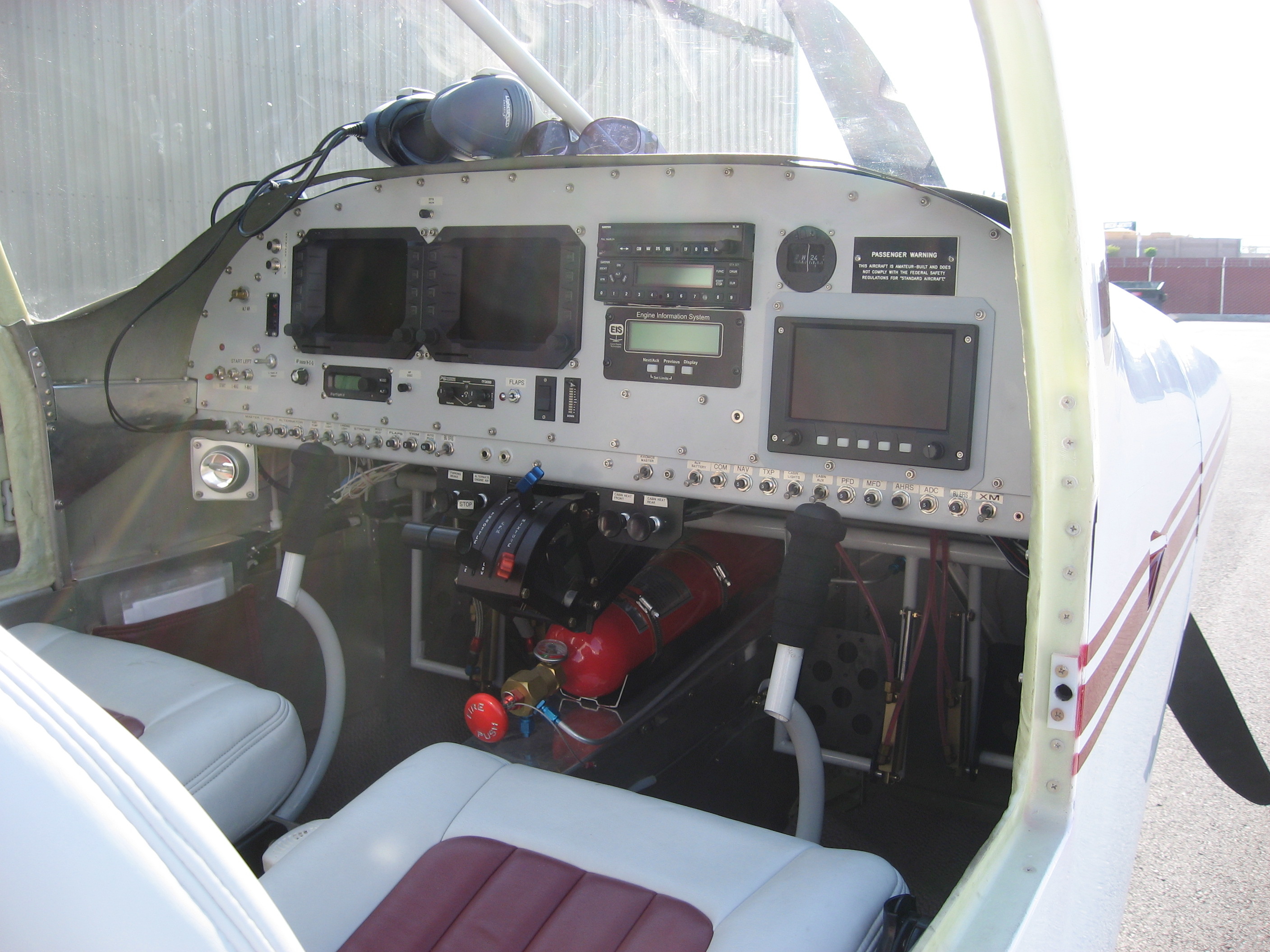

For those concerned about fire, you should consider a fire bottle. Mine does not, but could be plumbed into the tunnel also. Mine will flood the engine compartment and aft of the baffles with 15 pounds of Halon gas. First order of business is fuel selector to OFF and pull the pin and push the fire handle. For carbureted engines plumb a line into the carburetor air intake.

What about the heater boxes? Having halon in the cabin (or tunnel) concerns me.
I'd like to put one in, but just want to make sure I understand the risks before making a decision.
Phil

I think a person will know about the fire in the engine compartment (engine instruments) before anything starts melting out there. If you get smoke in the heat ducts close them, shut off the fuel and fire the bottle. Most Halon will be expended in the engine compartment. The sprayers can be tailored for flow. Certainly Halon is not something to breath but a little beats a lot of smoke and CO. I don't have the statistics but I believe that cabin fires are usually started by smokers or electrical shorts. Engine fires are fuel fed forward of the firewall. On that basis I do not allow smoking in the aircraft; all appliances are on individual breakers to quickly shutoff power to a failed circuit. and a fire bottle can be used to cool and snuff out an engine fire.
