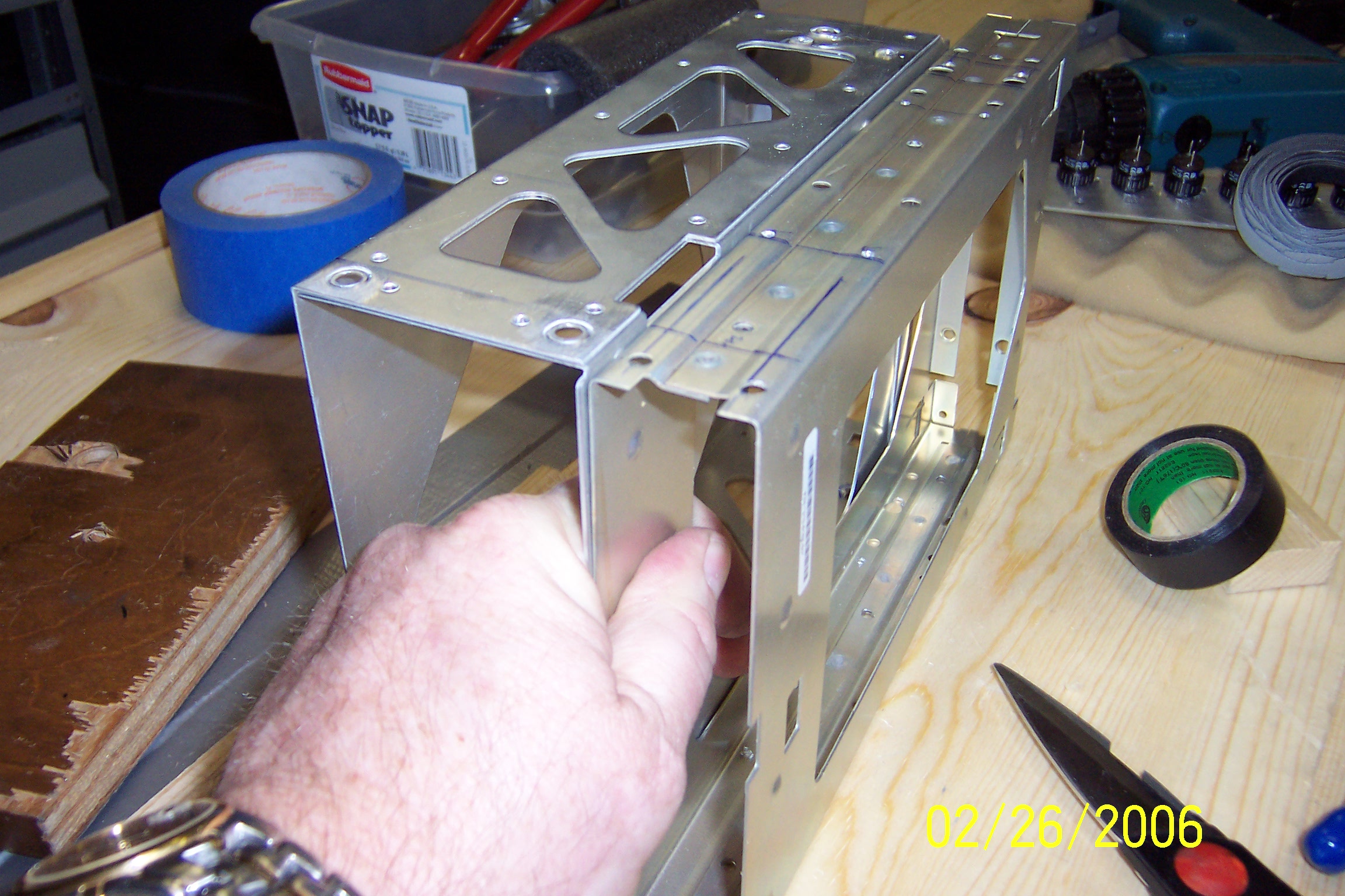

OK, I had all my radios in their respective racks stacked on to of each other to get the final measurements before I cut the hole for my stack. I taped all the racks together so that the radio bezels were even. Most of the racks required a different setback to even the face of the radios. I then just mounted the taped racks, slid the radios in, every thing matched. The Garmin racks have dimples on the bottom to give proper spacing between radios.
Bruce

Pix worth a thousand Smile This is a 430W tray and a SL40 Tray from Garmin.
Definitely not the same size but I think I remember the SL40 is slightly
smaller than the 430 as I had to add shims and the 430w tray was 6.25. 6.38
would have been a little better as mine is snub. Note that Garmin didn't
design the SL40 and SL30, those came with the Apollo acquisition as I
remember which probably accounts for the difference in tray sizes.
Bill S
7a just weeks away Smile
 Filesize:  681.32 KB
 Viewed:  13241 Time(s)
