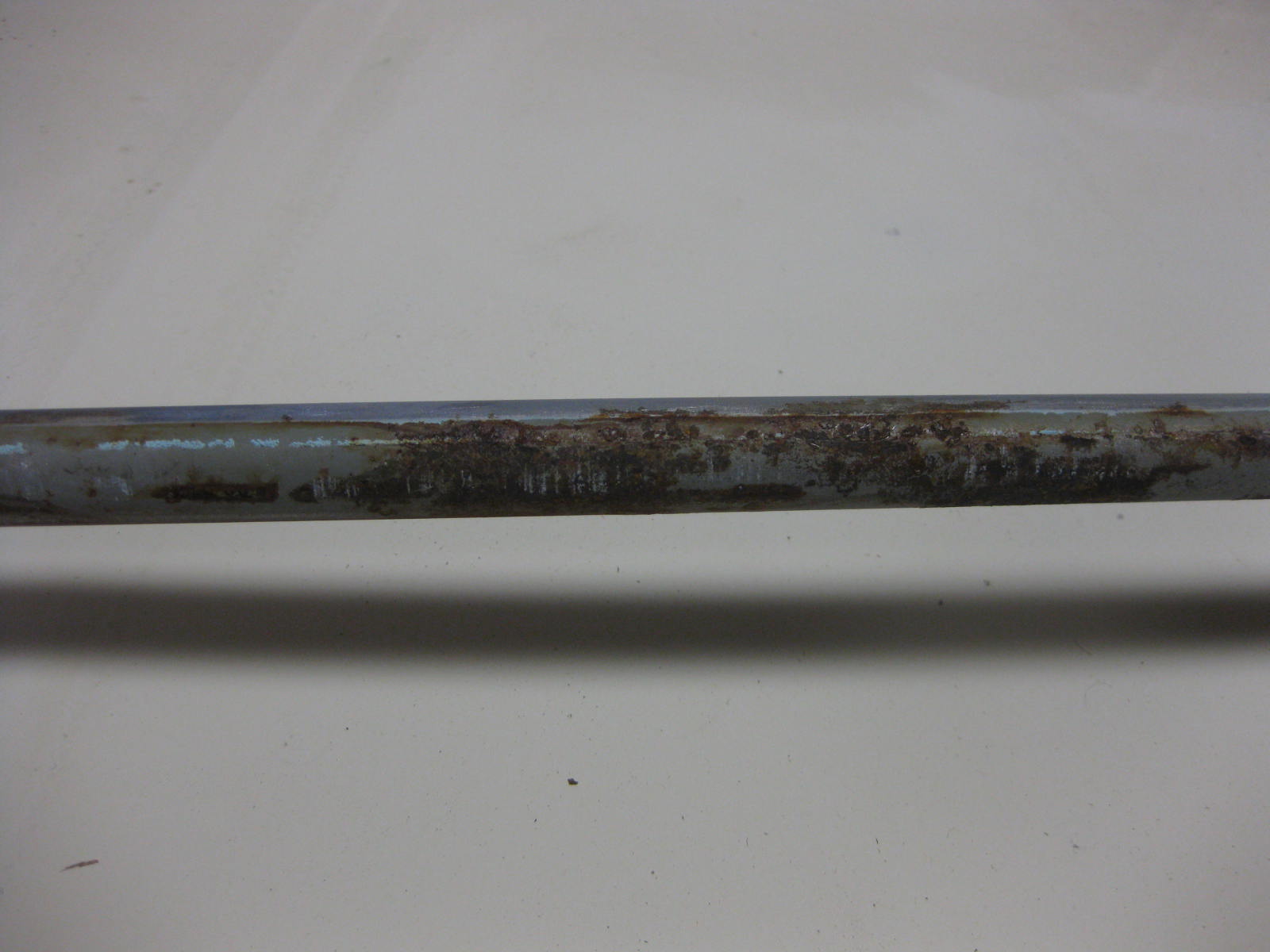

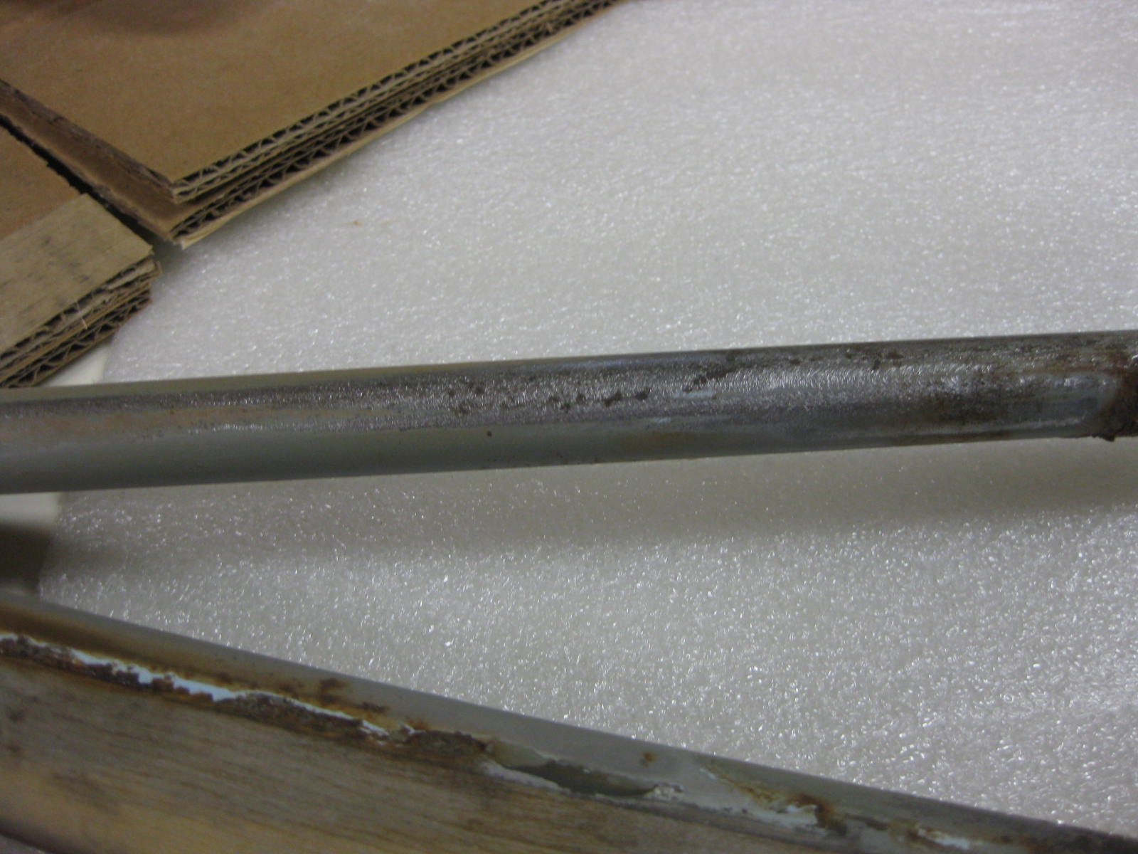

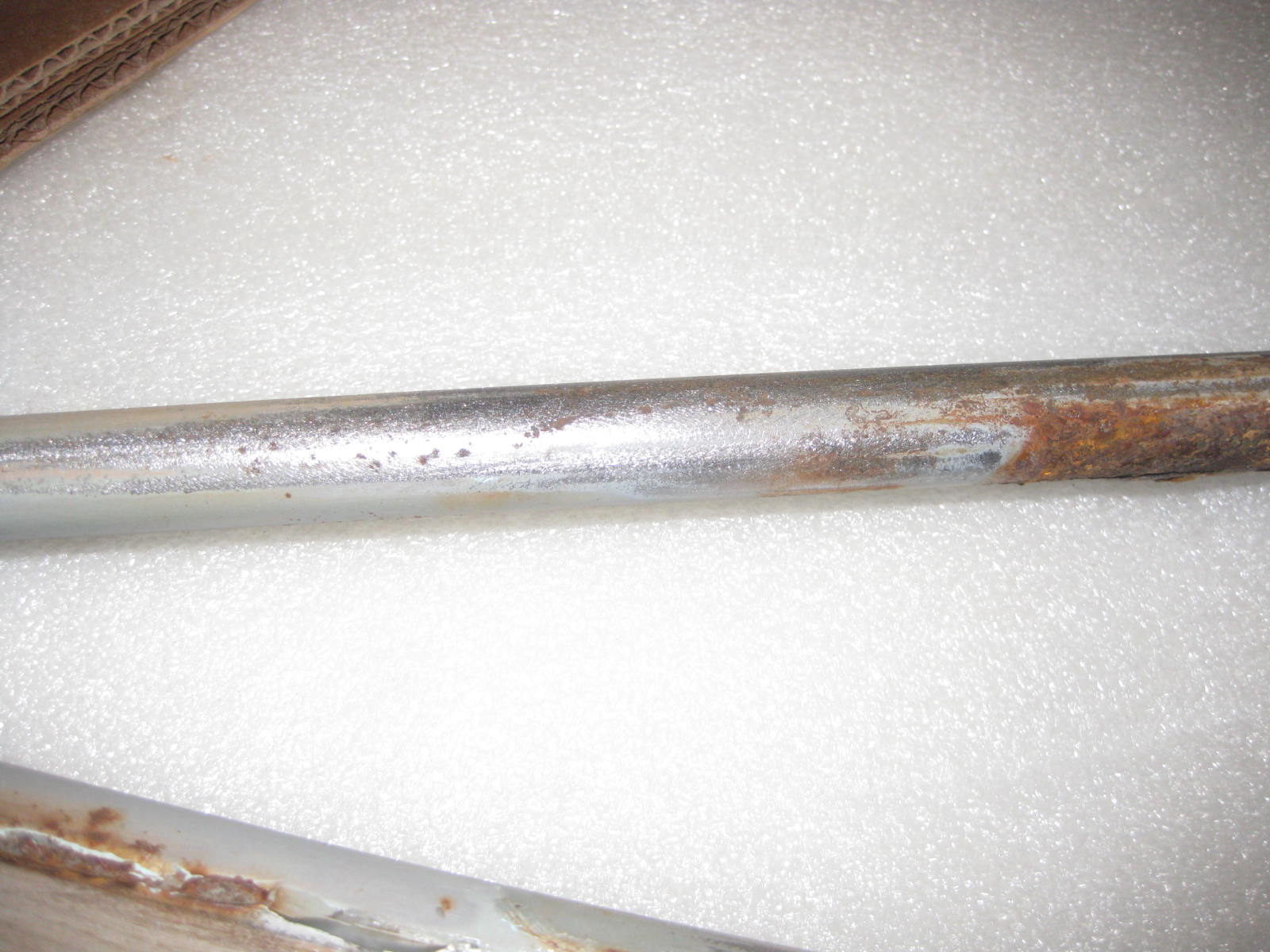

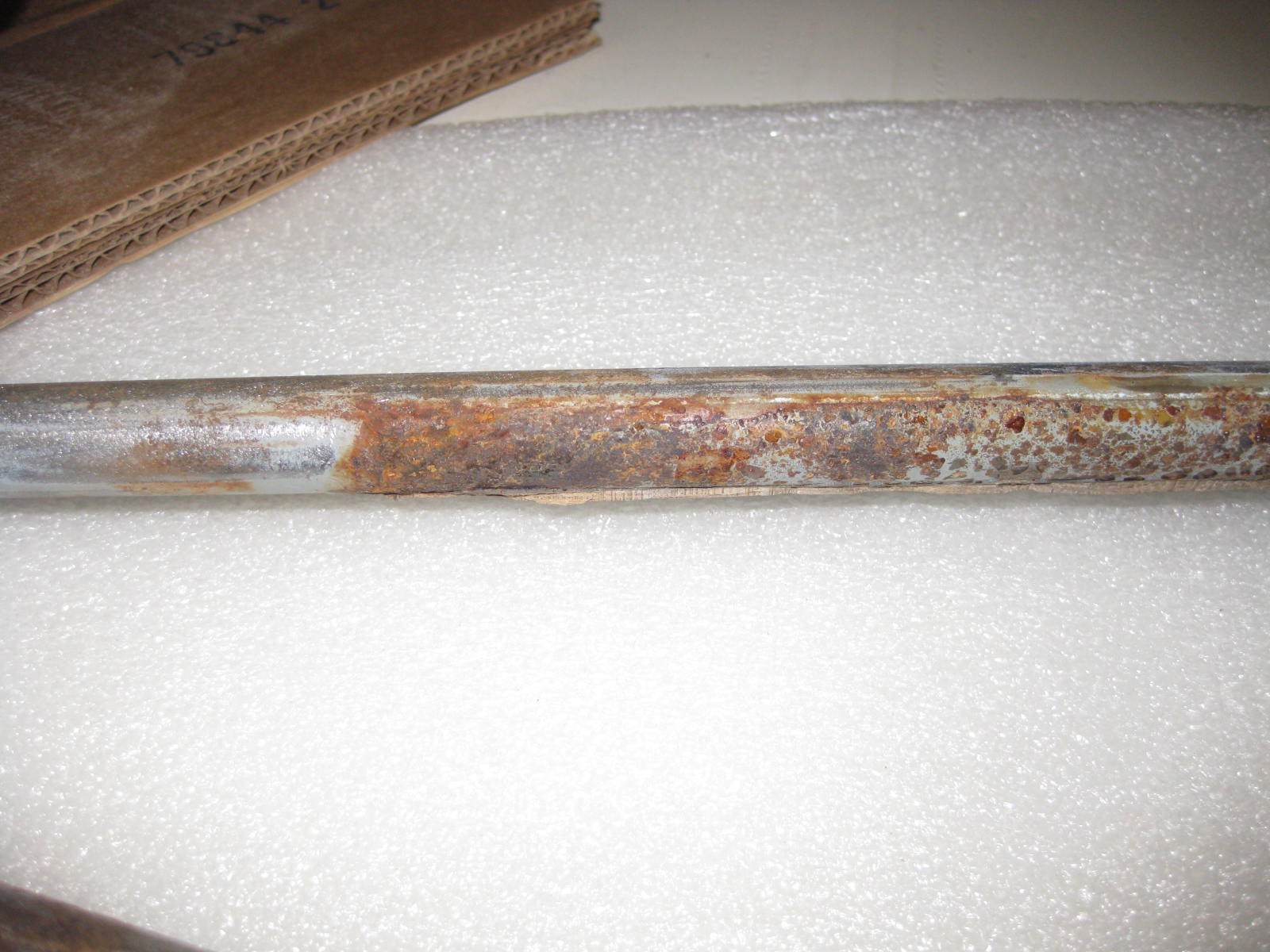

Hello Listers,
Today I took my Fox home to begin a thorough Condition Inspection. I decided to cut the fabric on a wing strut and inspect the
strut tubing. To my great surprise the tubing was quite rusted to the point that I have to replace them. In 1992 I prepared the metal, primed it well with Stits epoxy coating and glued the wood trailing edge fairings into place. Up to this date, the struts looked as good as new. Now I am thankful that I decided to open the fabric and check things out.
Now I'm in the market for both new struts. If anyone has a new set to sell, please contact me. If not, I'll try the factory and see if they are still available.
Thanks Much, Happy Easter, Ron N55KF

PostPosted: Sun Apr 04, 2010 7:24 am    Post subject: Model 2 Kitfox wing struts Reply with quote
Hi Pat,
Since there was a small cut in the fabric about 1' from the lower attach point, I thought it wise to open it up for a proper inspection.
The amount of rust that was along the full length of the tubing was shocking. Apparently the wood fairing held moisture and it went thru the epoxy that was used. I did use the kit supplied epoxy.
After I cleaned an area of the rust, I did a punch test on it and found that the tube was still in great shape. A "sounding" test on the tube gives me the idea that there may not be any rust on the inside. After the testing of the tube I think that they look much worse than they are.
I fear that there may be many early Kitfox's out there with similar rust, hidden from view by the fabric.
Ron

Hi folks,
I do a fair bit of failure analysis work with my job as a TSB investigator. The pictures I see alarm me not from the corrosion, but the pits that I see. Each of these pits is a stress risor and may be the initiating point for a crack. With the fairings on you would never see it until the strut failed. I am just finishing a model II with wood strut fairings. I'm going to fly it for a year or two and then look into modifications to allow the fairings to be removed at the annual for inspection.
Cheers

Are the extruded aluminum like are on the Rans too heavy? They were also a
replacement option on the Hawks.
Dwight Purdy
Model II
dwight
model II
Wes Bender
Joined: 05 Apr 2010
Posts: 4
PostPosted: Mon Apr 05, 2010 8:04 am    Post subject: Re: Model 2 Kitfox wing struts Reply with quote
I know a lot of Avid owners follow this list. (I'm one.) If you are thinking about flying your Avid without the lift strut wood fairings, you should reconsider. The fairings are not optional equipment. They add strength to the strut under compression loads. See AD (Avid Directory) #7, available under the files section of the Avid Yahoo group. That AD covers mandatory installation of flaperon counterweights and strut speed fairings.
Wes
[quote="jose_m_toro(at)yahoo.com"]Ron:
I'm not surprised. Mine was worse...by far. Again, I strongly recommend NOT to use a fairing. �Like yours, mine had wood fairing.
akflyer
Joined: 07 May 2007
Posts: 574
Location: Soldotna AK
PostPosted: Mon Apr 05, 2010 8:13 am    Post subject: Re: Model 2 Kitfox wing struts Reply with quote
The Avid AD
Avid AD 007.pdf
Download
 Filename:  Avid AD 007.pdf
 Filesize:  84.69 KB
 Downloaded:  646 Time(s)
DO NOT ARCHIVE
Leonard Perry aka SNAKE
Soldotna AK
Avid "C" / Mk IV
IVO IFA
Full Lotus 1450
PostPosted: Mon Apr 05, 2010 9:24 am    Post subject: Model 2 Kitfox wing struts Reply with quote
Wes:
I don't recall a similar AD for the Kitfox II. My former Kitfox II has been flown without fairings since 2007. No problem. However, it seems to me like a good idea to order the model II struts using the wider tubes, like in the Kitfox IV.
Best regards!
José
From: Wes Bender <bender_wes(at)yahoo.com>
Sent: Mon, April 5, 2010 12:04:16 PM
Subject: Re: Model 2 Kitfox wing struts
--> Kitfox-List message posted by: "Wes Bender" <bender_wes(at)yahoo.com (bender_wes(at)yahoo.com)>
Wes
http://forums.matronics.com/viewtopic.php?p=293049#293049
gt; http://forums.matronics.cp; -Mcs.com/contribution" target=_blank>http://www.matronics.com/contribution<=============
akflyer
Joined: 07 May 2007
Posts: 574
PostPosted: Mon Apr 05, 2010 9:52 am    Post subject: Re: Model 2 Kitfox wing struts Reply with quote
I flew mine without the strut fairings for awhile, but I have alot heavier tubes. This biggest surprise to me when I put the fairings on was the increase in climb rate of about 250 FPM. the extra 5 mph or so in cruise was not that big a deal to me, but I liked the climb increase!
DO NOT ARCHIVE
Soldotna AK
Avid "C" / Mk IV
IVO IFA
Full Lotus 1450
rliebmann(at)comcast.net
PostPosted: Mon Apr 05, 2010 10:32 am    Post subject: Model 2 Kitfox wing struts Reply with quote
Thanks Wes, do not archive
fairings.
Wes
carlisle
Joined: 20 Jun 2009
Posts: 72
Location: Sioux Falls, SD
PostPosted: Mon Apr 05, 2010 7:36 pm    Post subject: Re: Model 2 Kitfox wing struts Reply with quote
I've flown my Model 2 for almost 20 yrs without the fairings without a problem. Does anyone know if replacing with the larger diameter tubing changes the maximum gross weight? An extra 100 lb (current gross is 950) would open up a whole new world of sharing for me.
Chris
