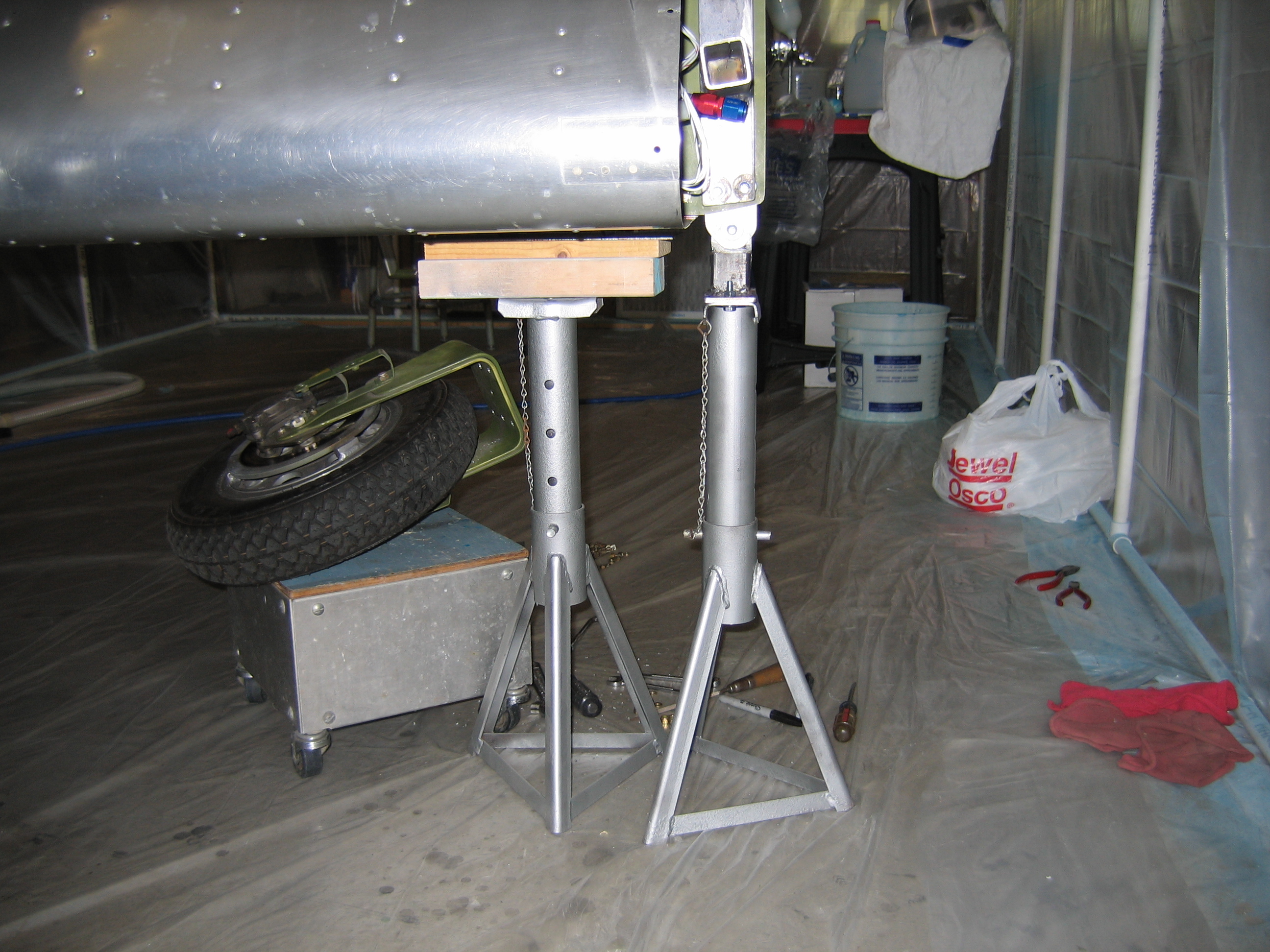

PostPosted: Tue Mar 30, 2010 4:34 pm    Post subject: Wing Support points Reply with quote
Hi Damien,
I made a set of wing stands to do the job. The wings were off when I did
these, but you could make a set that supports the spar area
as shown here. You may have to adjust the angle a bit, but I replaced
bungees one at a time while on this rig. Lift the airplane, set in the pin.
or just place the support under the spar.
See attached image.
Larry McFarland

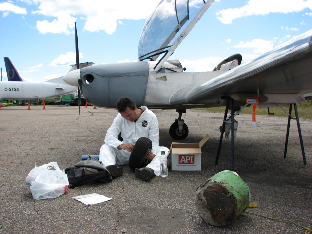

mtherr(at)yahoo.com
PostPosted: Tue Mar 30, 2010 5:48 pm    Post subject: Wing Support points Reply with quote
Not sure what you mean, but if it is to put the plane on saw horses or something like that, I'd say that anywhere under the main spar should be good (main rivet line underneath)... at least, this is the case for the 601 HD.
Here is a not so fun example...:
Michel Therrien CH601-HD, C-GZGQ
