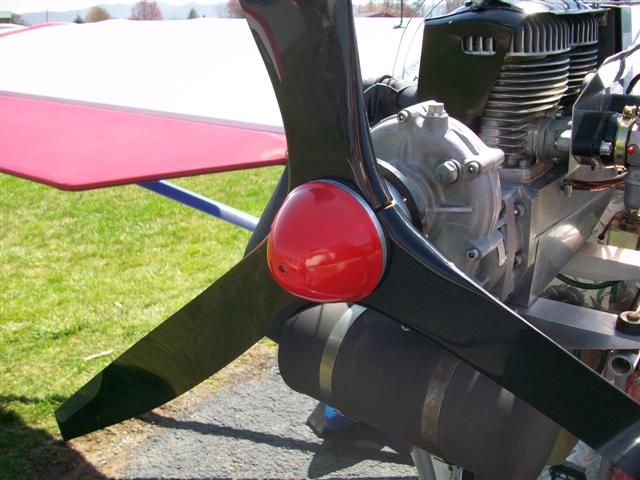

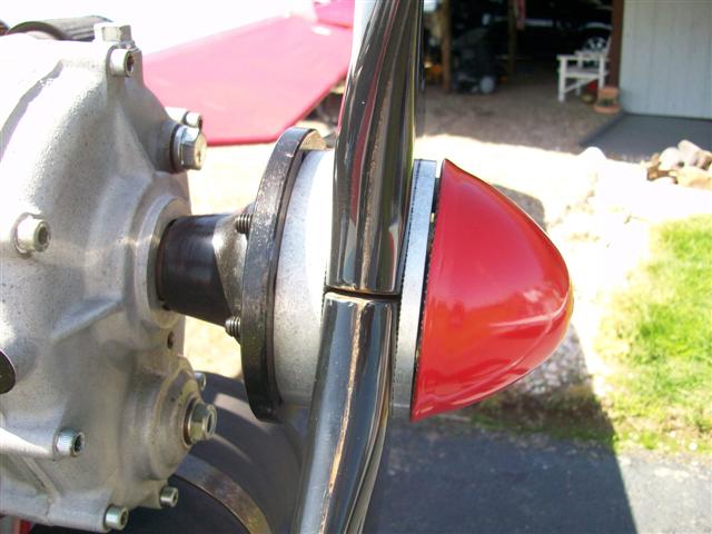

This is a home made spinner that one of the guys in the Mountain Empire Sport Flyers made
http://www.bcchapel.org/MESF/Index.html
It is made from a 2006 Ford F250 van air filter. The guys who are using it claim it will stay in place even without a retaining screw (although they use one) - that it clips over the bolt heads on an Ivoprop. Have no idea how it fits on other props. I don't have one on the MKIII, so - no opinion.
Worth what ya paid for it.

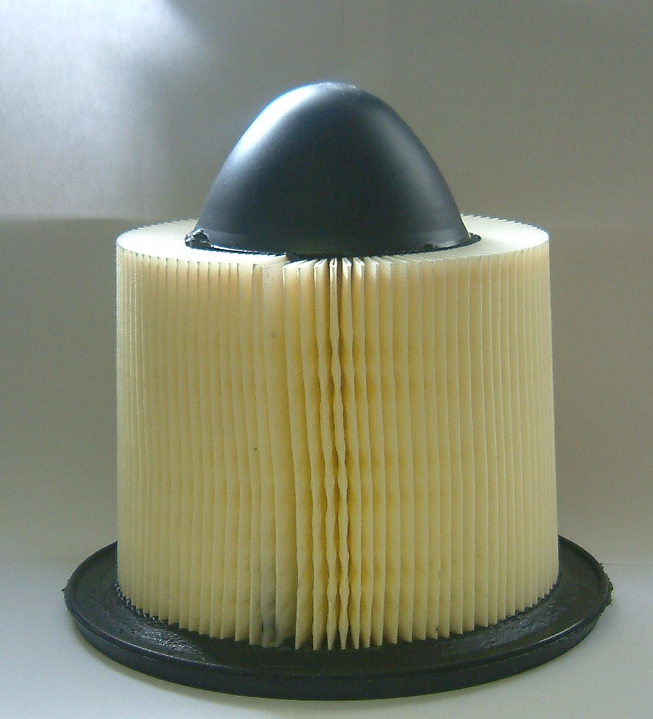

Motorcraft Air Filter FA1632

PostPosted: Sun Apr 04, 2010 7:47 pm    Post subject: Re: Cheap Ivo Spinner Reply with quote
Thanks! I'll add that to our club website tomorrow.
