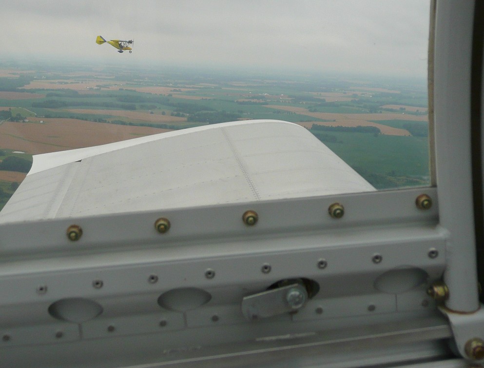

I installed mine on forward with the lock just above the rail, mounted on the forward canopy side metalwork just aft of the roll bar.. I cut a slot in top of the slider rail that the locking tab turns down into for the locked position. Works fine for me.

"I am getting ready to install the locking mechanism on my 6A slider. The lock
uses the same key as the ignition and the locking mechanisms came with the ignition
switch set.
I am trying to figure out where to install it as the side skirt bows out in the
middle and the slider rail that the lock bar goes in to is straight front to
back. Essentially, there are two installation points (foreward and aft) on each
side."

Here is a picture of mine, I've got two slots full shut and a little
open for air circulation when parked out in the hot sun.
