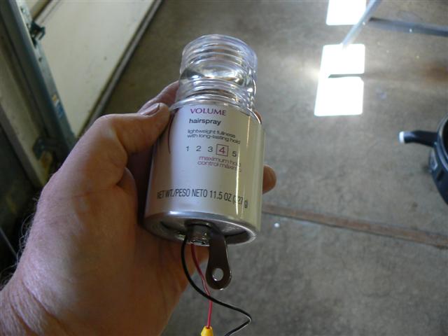

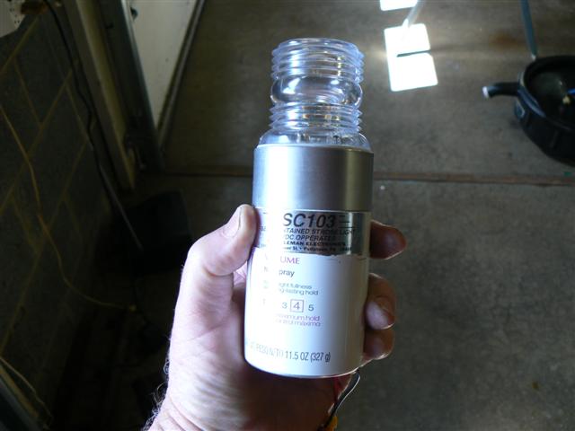

Decided to put a strobe on each wingtip, but wanted a way to
streamline it in,
and also wanted a way to make the strobe easily removable in case it
needed replacing.
Went to the CVS drugstore, no luck, went next door to the Dollar Store
- Bingo!
Wandering around the Dollar Store with a Kuntzleman strobe and
calipers pays off.
The Pantene can was a perfect fit. Took it home, laid a brick on the
nozzle (Take
that, Gore! HA!) and when the can was empty, cut off the bottom and
fit it
in the wingtip. Will glue it in place with JBWeld, and then use
fabric to blend
it in.
Will use the other end of the can on the other tip. The nav light
will go just
ahead of the strobe, ordered two 6" strips of 24 12V LED's off of
ebay, will put
those across the back of each tip for the white rear light.
Richard Pike
MKIII N420P (42oldPoops)
http://forums.matronics.com/viewtopic.php?p=292469#292469
http://forums.matronics.com//files/p1160002_small_125.jpg
http://forums.matronics.com//files/p1160026_small_191.jpg
http://forums.matronics.com//files/p1160039_small_929.jpg

A picture is worth 1,000 words - it acts as a socket for the strobe to slide into. First picture is starting in, 2nd is all the way in. A thin strip of silicone seal will hold it in, and keep the water out. Won't use the tang on the bottom of the strobe, but trying to take it off is a no-no.
