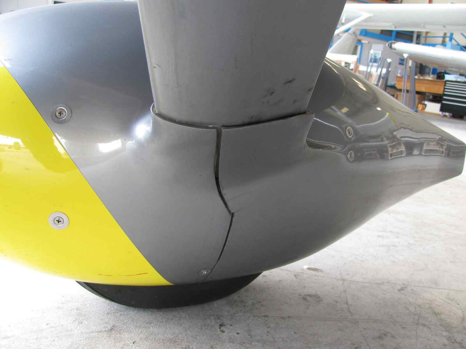

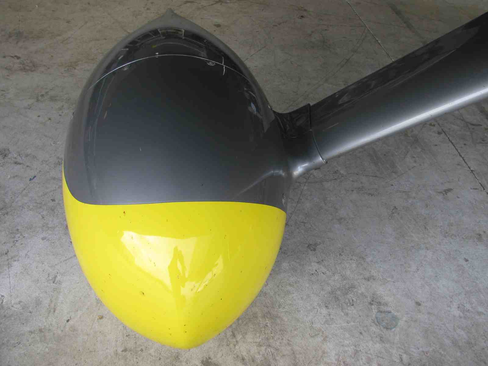

PostPosted: Tue Mar 30, 2010 10:45 am    Post subject: Gear intersection fairing - bonding lower fairing to wheel Reply with quote
Bill,
Here are some pics of our wheel pants.  The gap you see opened up on the inner split line because there isn't a screw closer to the top of the intersection, just the one on the very bottom.  Others look nicer so if you can think of some way to pull the split line together you could probably avoid the gap you seen on mine.
Dave Saylor
