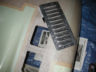

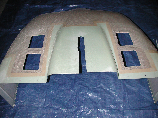

PostPosted: Mon Mar 29, 2010 11:21 pm    Post subject: RV-List Digest: 5 Msgs - 03/28/10 Reply with quote
After you have sealed as much as you can --If you still have a cooling problem you, might consider louvers. Particularly if you have yet to paint the plane. I was worried about cooling with my io 360 so I built in louvers when I built my plane. It runs almost too cool -- I have to block about 80% of the oil cooler in the winter in SoCAL. No problem with heat even on hot, summer days at gross weight and climbing.
good luck
dave

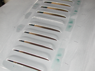

[img]cid:983F8972-C238-40ED-93E4-5B3FB1814F20(at)gateway.2wire.net[/img][img]cid:9C2E9673-9EEA-487A-ACD1-72418B84EAA2(at)gateway.2wire.net[/img][img]cid:927E3A53-30E6-4B25-A4E1-40DE97A50D1C(at)gateway.2wire.net[/img]
