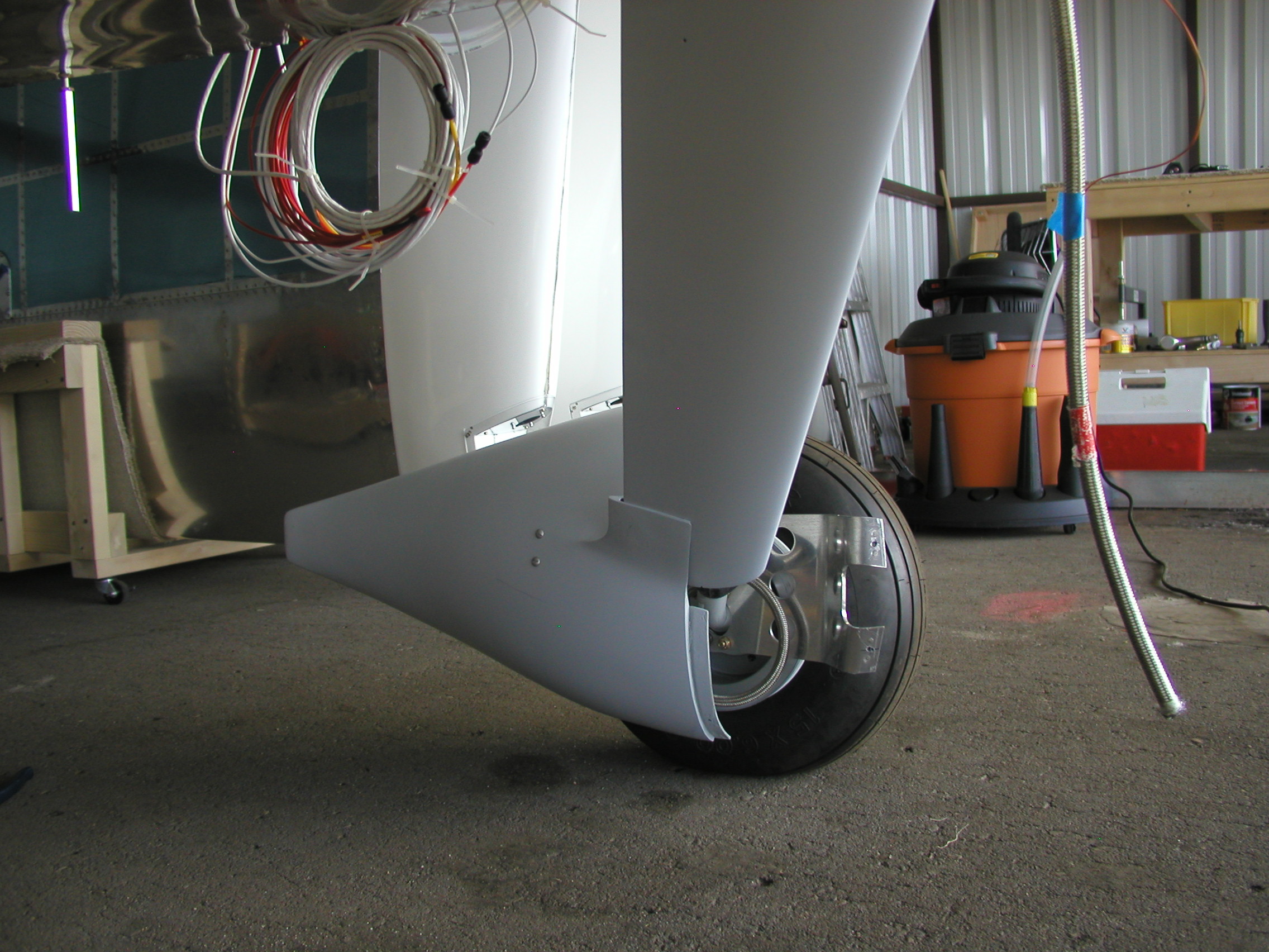

PostPosted: Mon Mar 29, 2010 1:54 pm    Post subject: Gear intersection fairing - bonding lower fairing to wheel p Reply with quote

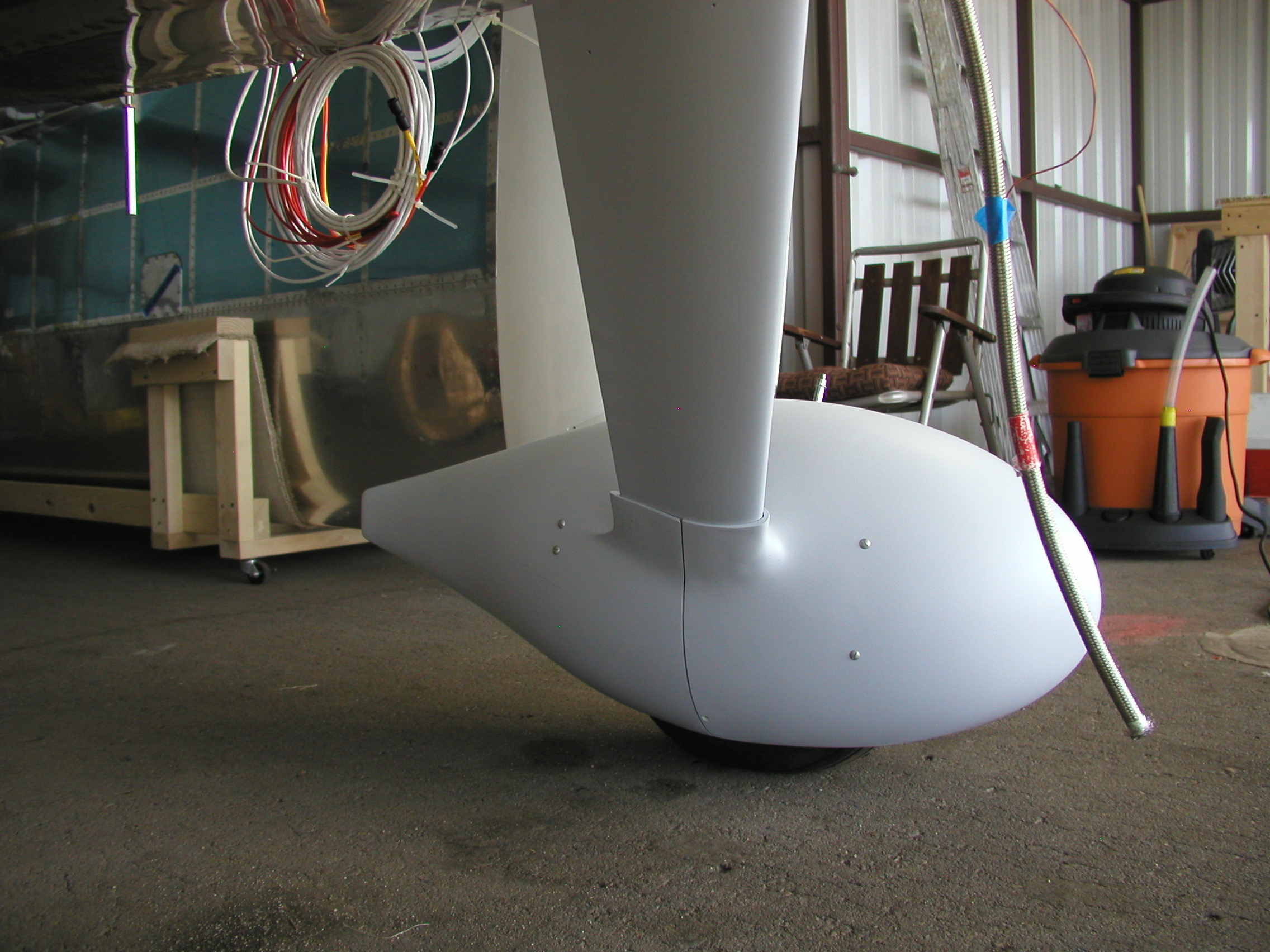

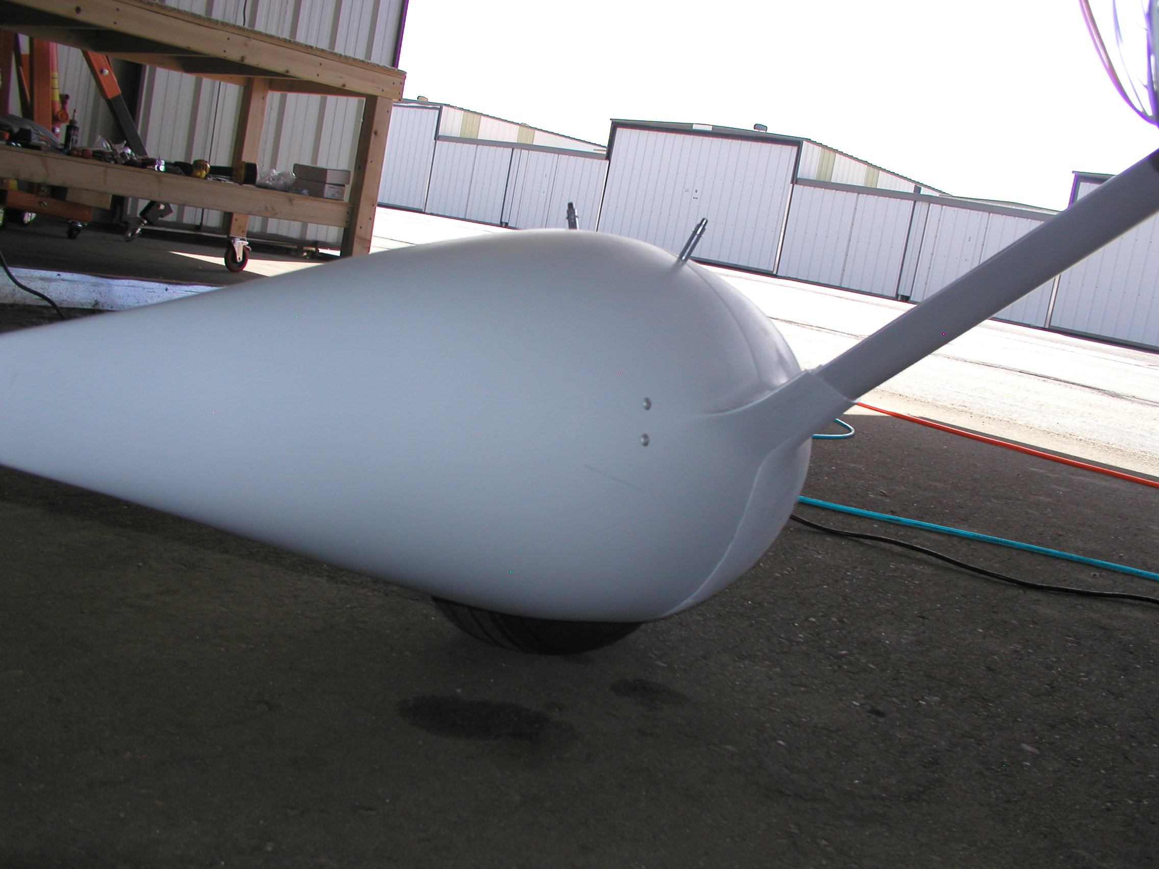

Bill I did it and love it so far. I am glad I did it. A little more work but
easy on and off. I thought I had a better picture. I will send a few better
picture tomorrow.
Geoff

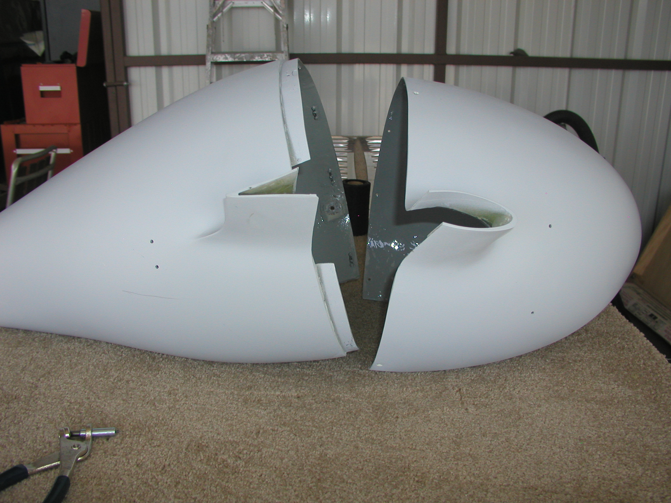

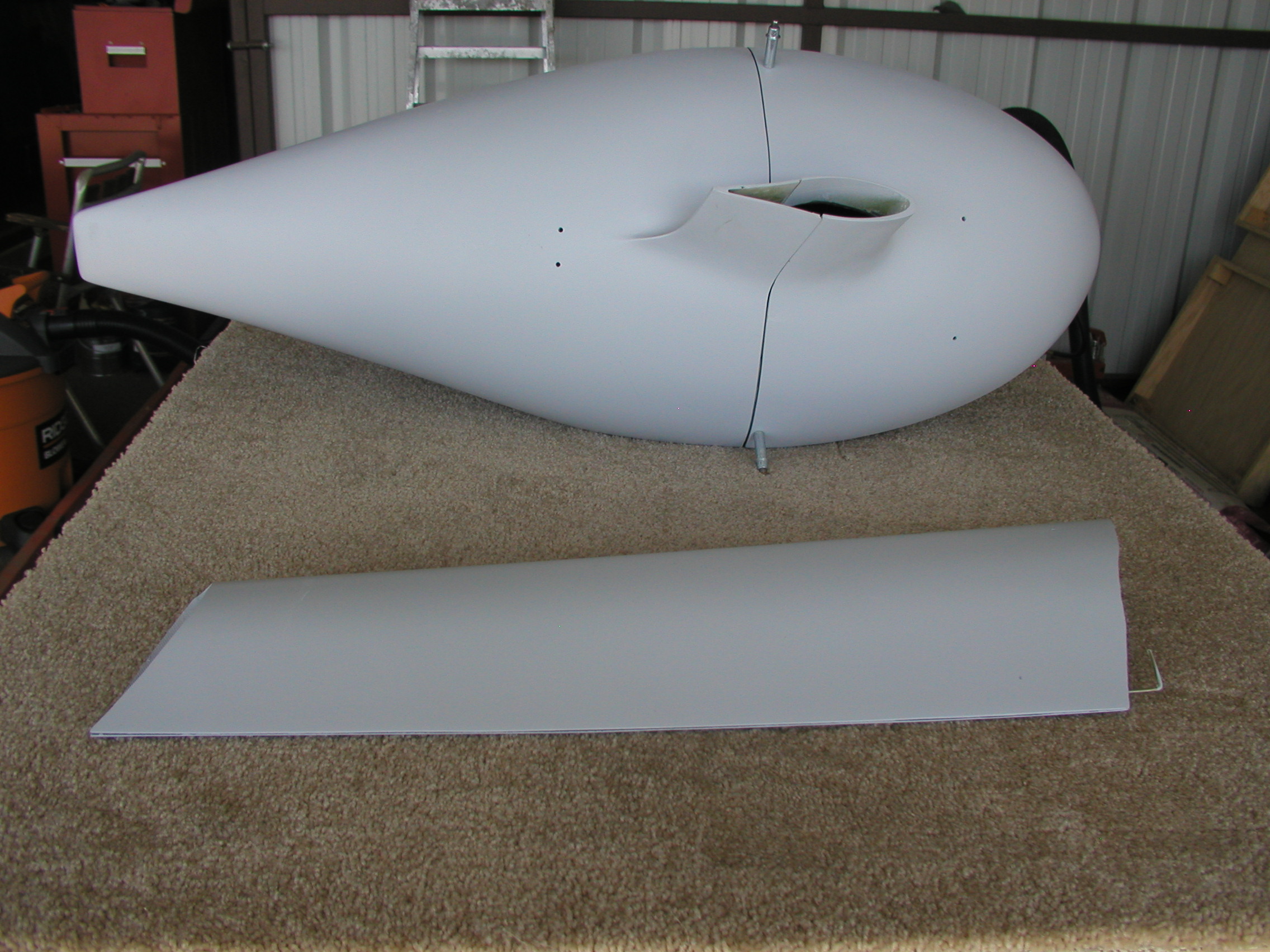

PostPosted: Mon Mar 29, 2010 2:58 pm    Post subject: Gear intersection fairing - bonding lower fairing to wheel p Reply with quote

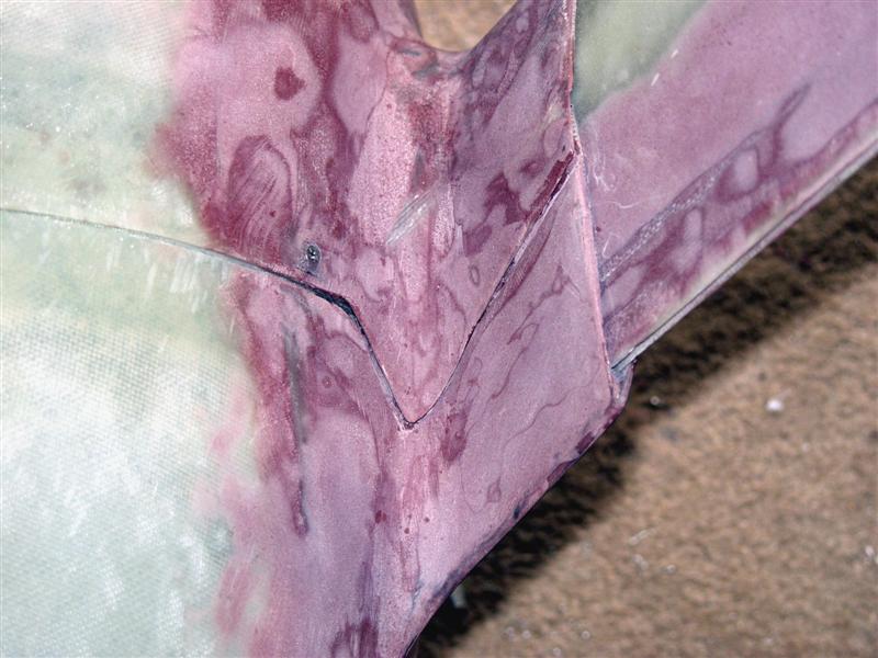

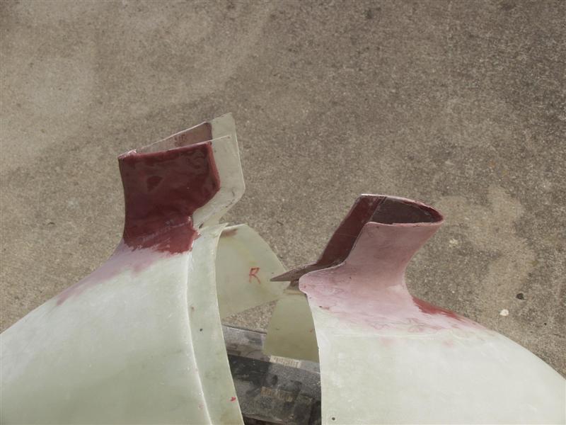

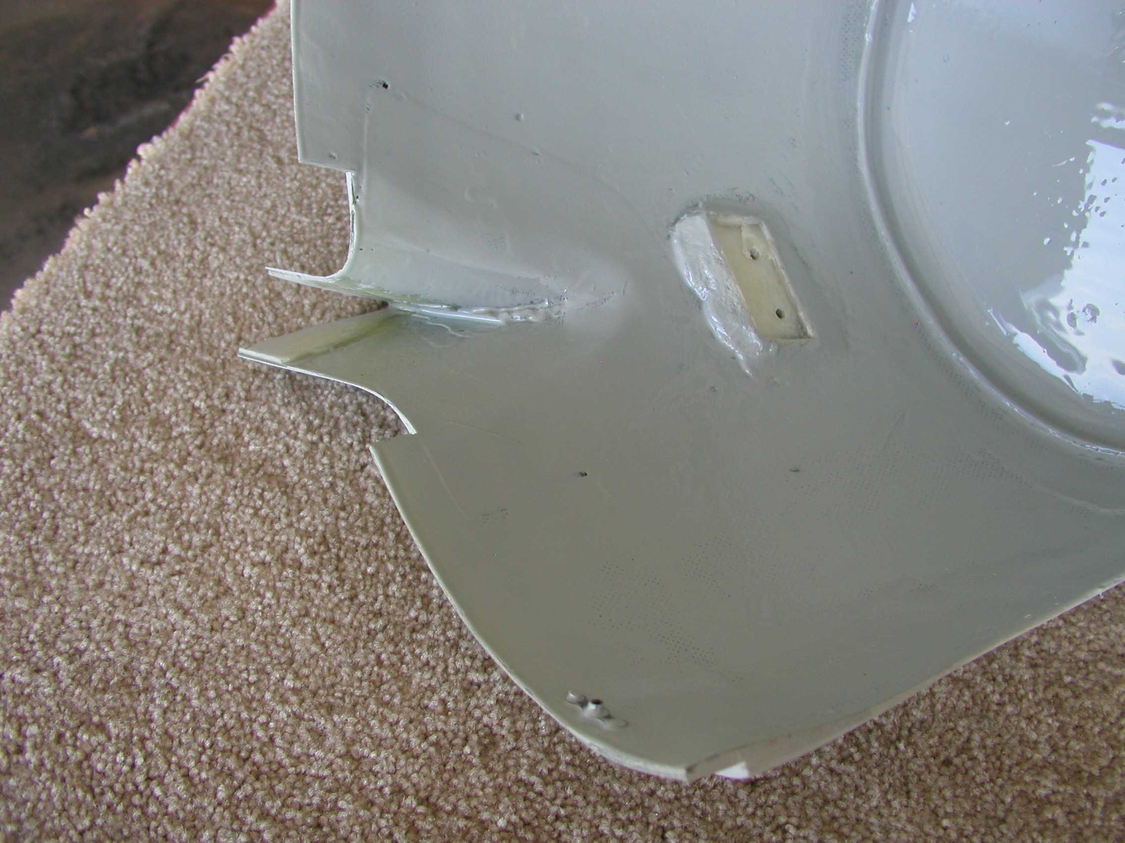

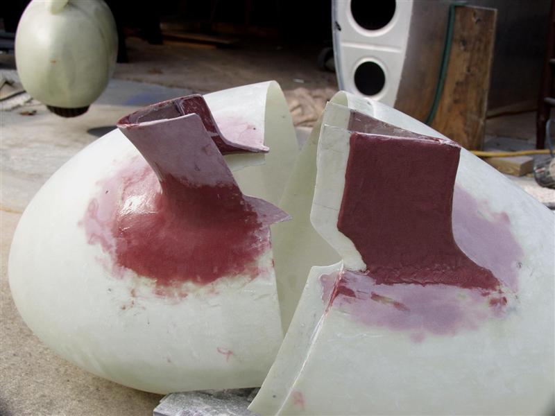

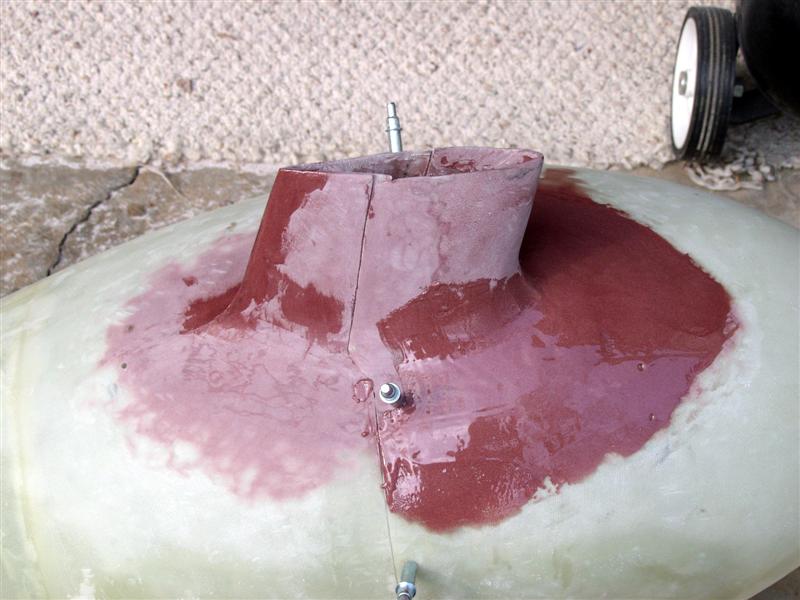

Hey Bill "not lookin' like a fool" Watson,

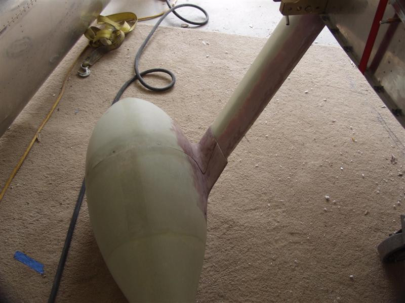

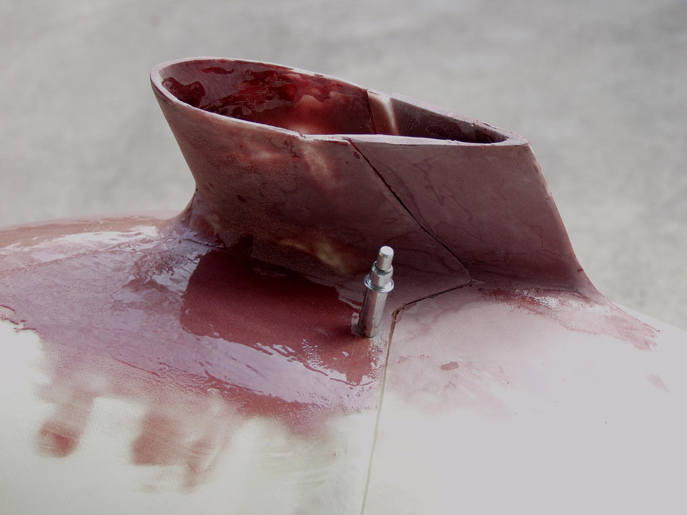

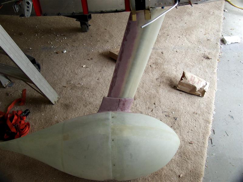

Here are some I made of ours. I added a lip to make a better junction. Be
careful about centering the cut so that the two halves meet without having
to compress one.
Later, - Lew

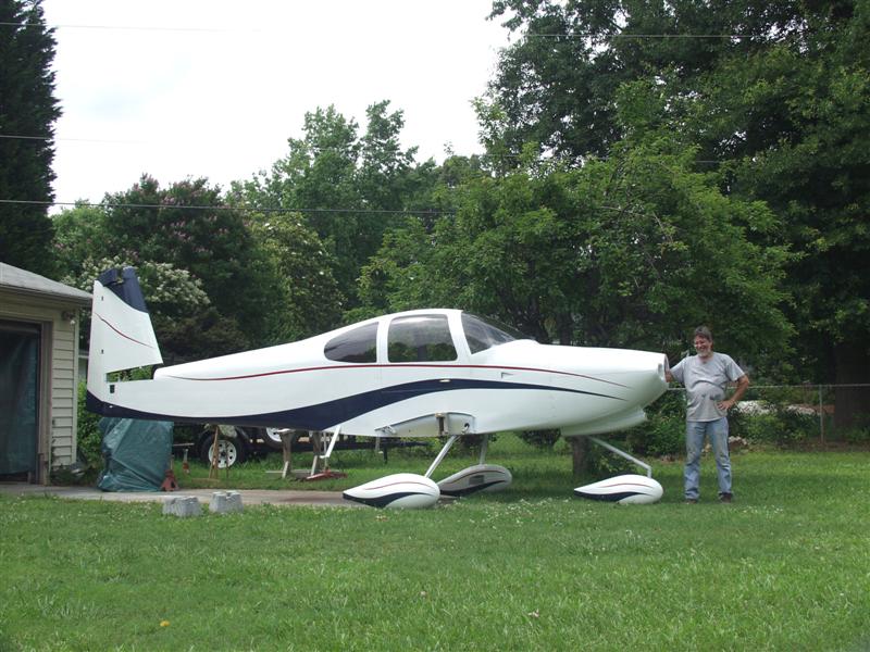

PostPosted: Mon Mar 29, 2010 8:35 pm    Post subject: Re: Gear intersection fairing - bonding lower fairing to whe Reply with quote

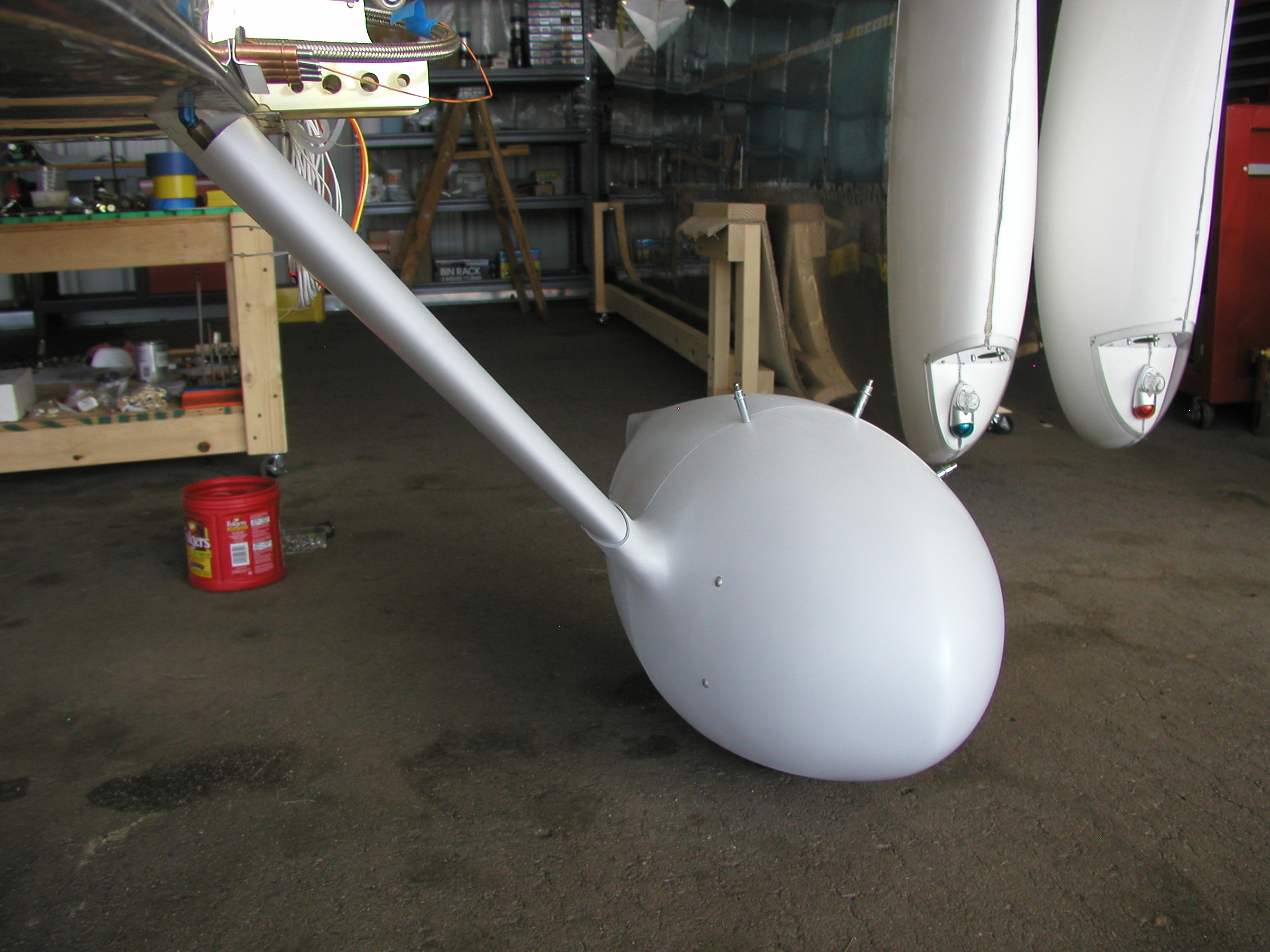

Bill,
My version of wheel pants.
Jim Berry
40482

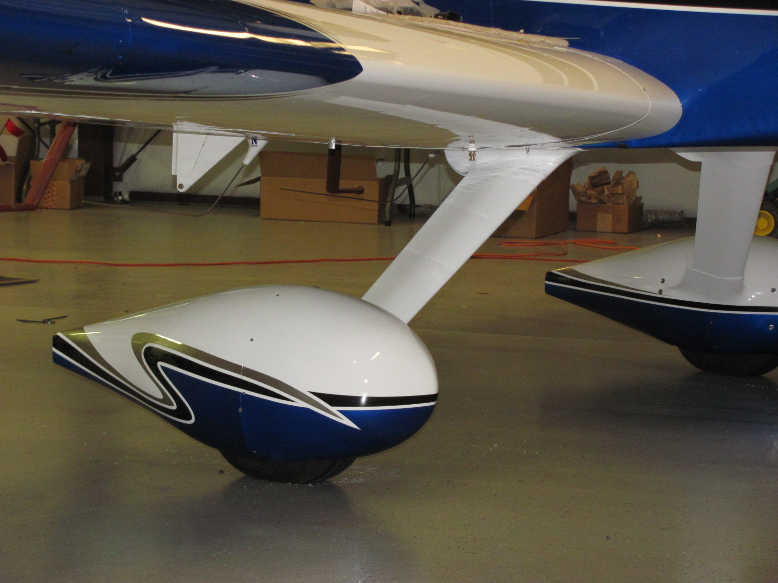

PostPosted: Mon Mar 29, 2010 8:41 pm    Post subject: Gear intersection fairing - bonding lower fairing to wheel p Reply with quote
Hey Bill,
Here are a couple more of the pants in the painting process. They turned
out pretty good. Another thought: since this adaptation incorporates the
alignment of the strut pants, be diligent with getting all that lined up
before glassing. Once it is done ... it's done! Again, if you've tackled
the plexi and windshield fairing -- you can do this, just take your time.
It is tedious now, but saves much later.
Why don't you consider driving the Maule down to Greenville (SC) to check us
out soon? First flight should be any day now if the weather will cooperate!
Later, - Lew
