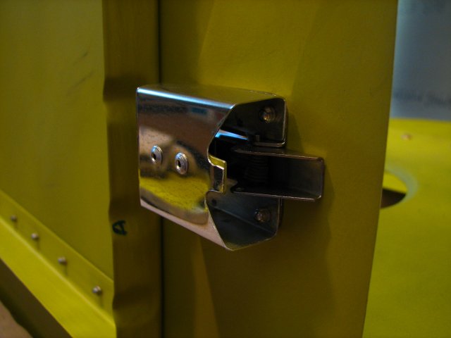

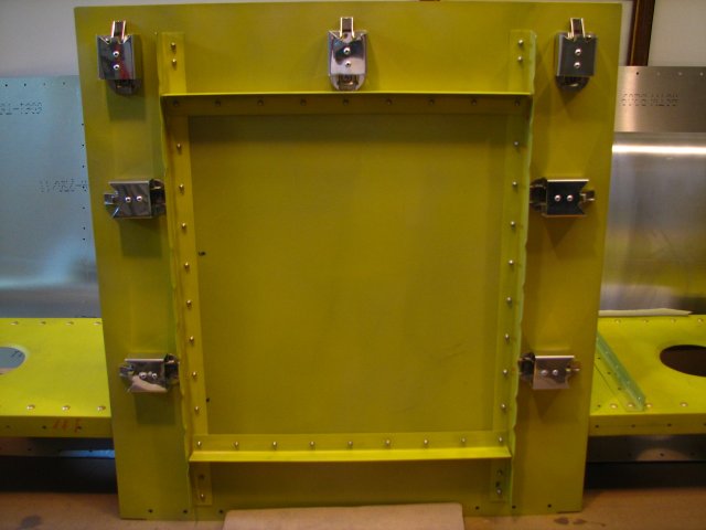

To operate the latches, you will need to apply a force perpendicular to the skin, so the skin
and the area around it must be able to take the stress. My locker cover is 0.020" - I should have used 0.025", but I think it will survive. If not, it should be a matter of hours to make another one with thicker material.
New latches are a bit stiff, so I operated each one a number of times until they became easier
to work with - before I ever installed them in their "final resting place".

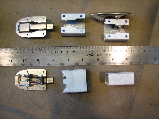

They open with a jolt, so they can damage the skin when they reach fully open position. The
damage is visible on the picture of the hole patters. One of them shows some deformation (3rd from left, on top). So, to fix the problem, I made a "cage", or travel stop, to make sure the latch stops before denting the skin. This is the purpose of those funny "match boxes" you see.

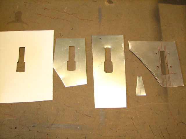

 About the pictures:
I made hole patterns, starting with cardboard and then making them a bit better (on 0.016"),
until I was happy. I used the one to the right to trace the hole shape on the door, then
drilled small holes all around and shaped with a file.
The travel stop / cage was made of thin stock (0.020"?), and then a trapezoidal piece (0.032")
riveted inside (see sample next to the hole templates).

About the pictures:
