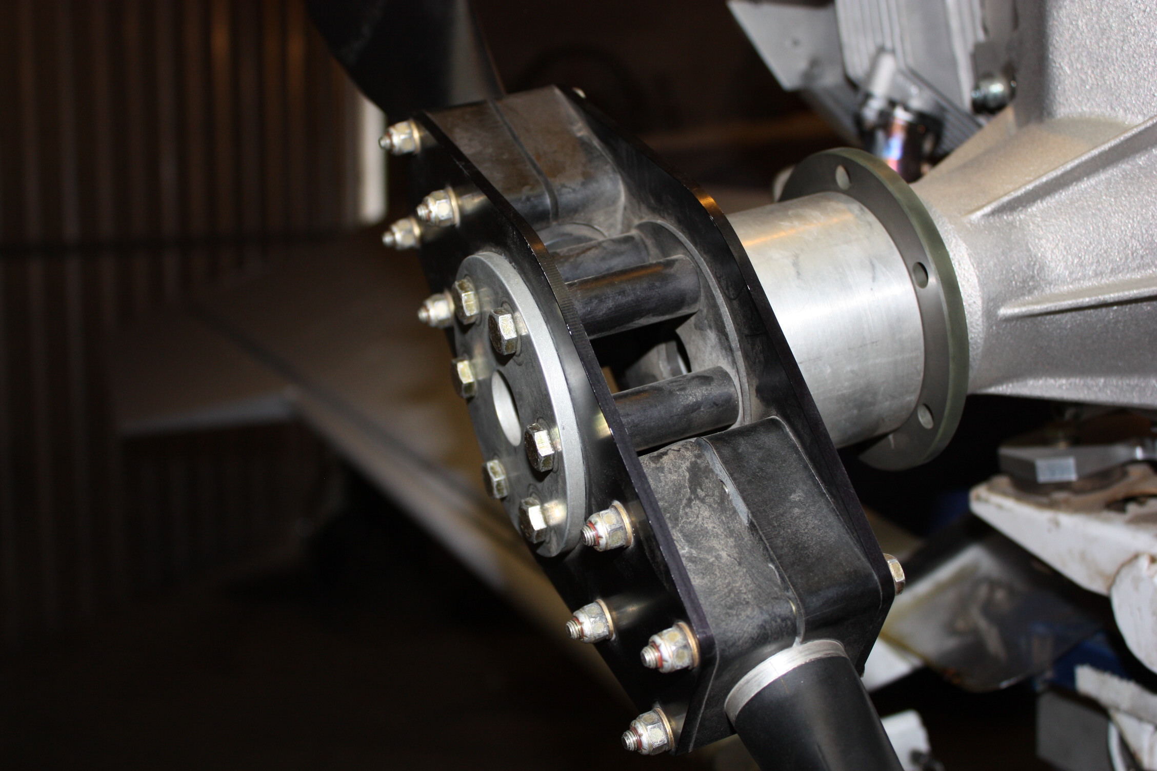

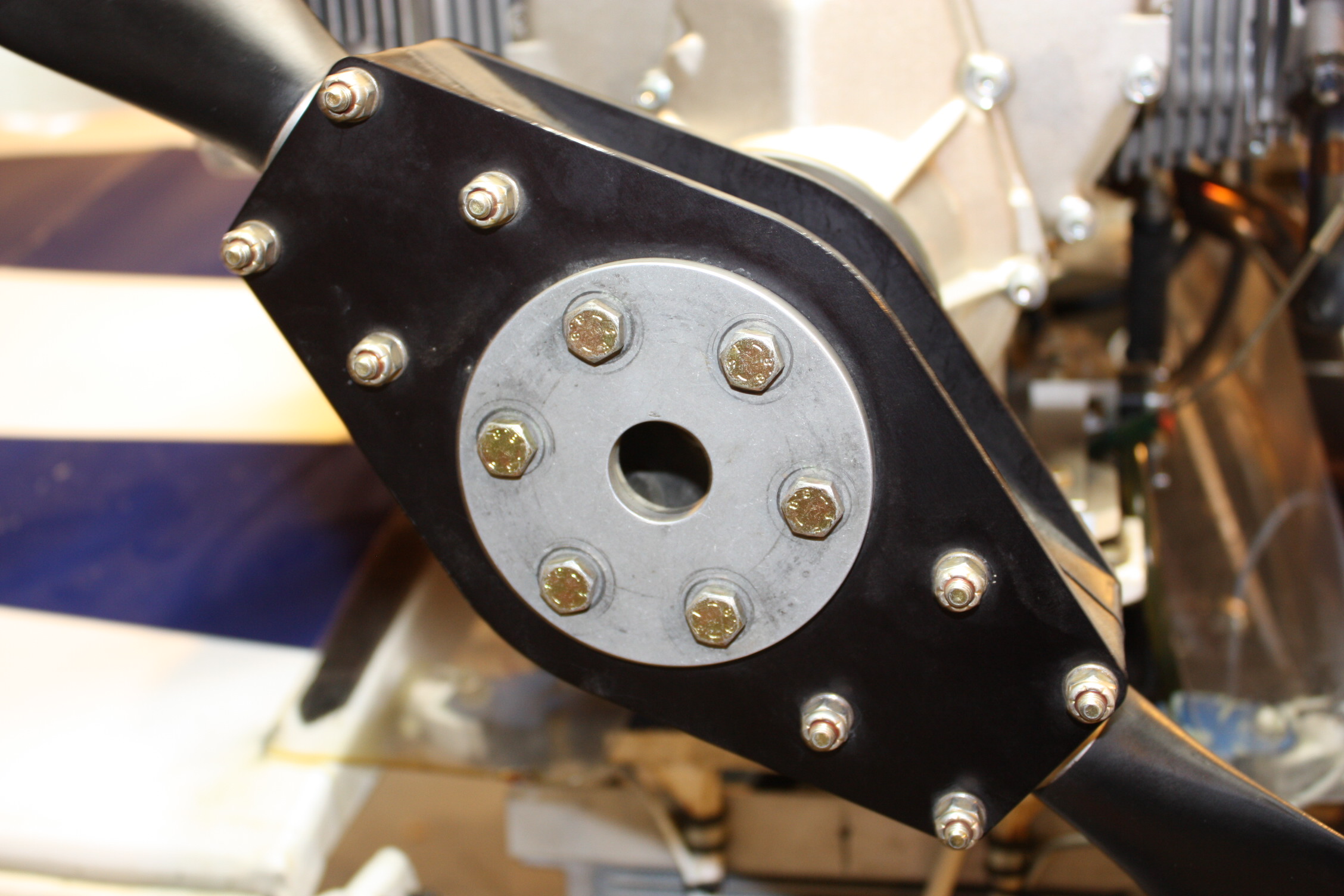

You will notice that I have changed the subject line a bit, because I want to address two issues.
I looked at the pictures of the props that were the problem, and it is plain to me, (I own a two blade warp) that the entire holding set up has been changed from the props that were having the problems. The method of attachment has been changed, so actually any comparison between the two is not applicable until one of the newer ones happens to develop cracks, no matter what they are installed on. The ones that were having the problem looked as though they were cast pieces, the newer ones have a flat plate that they are secured to, no edges or corners to start a crack. I have included two pictures of the current configuration of the prop for your comparison. Quite frankly, I am confused that the article failed to mention that the blades were the older style. It seems to me to be a bit like the stuff that the Enquirer likes to publish.
