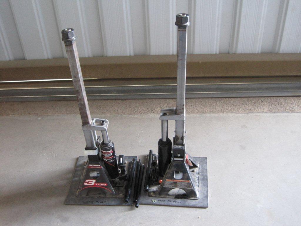

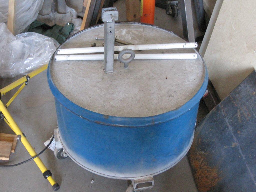

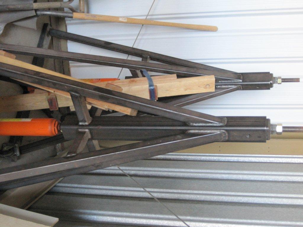

PostPosted: Tue Mar 16, 2010 5:14 pm    Post subject: Wing jacks Reply with quote
It always amazes me when people are willing to jack a $150000 aircraft with
a makeshift arrangement. Dropping an aircraft will be expensive in both
dollars and time. Aircraft jacks normally require a hydraulic mechanism for
lifting and a locking mechanism to hold the aircraft if a hydraulic cylinder
fails. I have attached several pictures of the jacks we built to jack high
wing aircraft and low wing aircraft like the RV10. You should be able to see
the hydraulic jacks that are available of the shelf and the additional steel
tubing, large nut and threaded steel rod. On the high wing jacks we use
steel bolts inserted into the tubing to lock in place after the lift. On the
low wing jacks the jacks them selves have a locking mechanism and we simply
welded the tube onto the jack and welded the nut and inserted the threaded
rod. One picture is the moveable tail stand/weight. BTW do not use the
threaded tie down bolt areas as the tapped block does not reach the skin (on
my QB wings) and the Vans supplied jack points will compress the skin of the
wing and eventually crack and break it. On top of the jacks we use wooden
block with baffling material siliconed on to protect the surface. We also
place the jack under the main spar.
 Filesize:  92.24 KB
 Viewed:  15267 Time(s)
 Filesize:  107.73 KB
 Filesize:  98.33 KB
Lew Gallagher
Joined: 04 Jan 2008
Posts: 402
Location: Greenville , SC
PostPosted: Tue Mar 16, 2010 7:59 pm    Post subject: Re: Wing jacks Reply with quote
Hey David, et al,
That's a sweet jack! I'm on it. Looks like:
https://www.toolsmithonline.com/products.php?product=Powerbuilt%C2%AE-3-Ton-All%252dIn%252dOne-Bottle-Jack%7B47%7DJack-Stand
has the jack/stand. I assume you haven't had any problems with the safety ratchet? A quick google search turned up several complaints of Powerbuilt's regular jack stands failing -- evidently cheaply cast China ratchet.
About the wing tiedown not being flush with the skin: I've made a stud that screws into the tiedown with a shoulder on it so that the weight is on the threads, not the skin -- is that a bad idea? better to spread the weight on the skin?
I'd still like some examples of when both wheels need to be jacked off the ground.
Just a thought about using the engine hoist point to raise the nose wheel: with the engine mounted, the tail acts as a counterweight and the force on the hoist point is less than when lifting the engine by itself ... so what could the problem be?
Later, - Lew

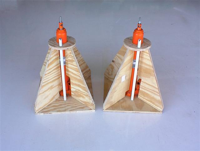

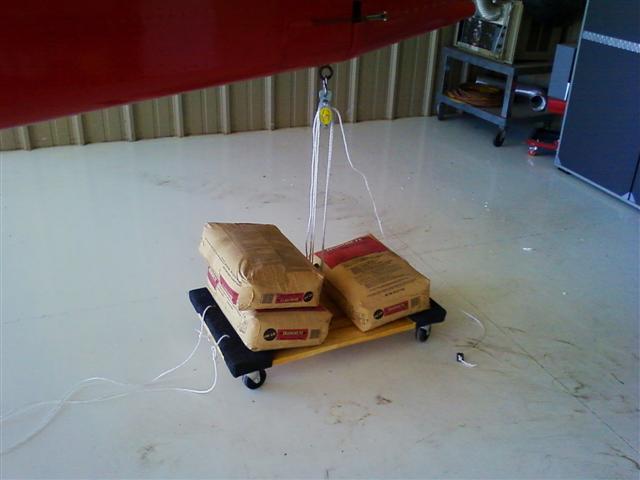

PostPosted: Tue Mar 16, 2010 9:04 pm    Post subject: Wing jacks Reply with quote
I have a 3 blade Aero Composit prop and in order to remove the lower cowl I
have to pull the tail down so the front gear leg can drop down and provide
clearance. I have a 4-wheel HF furniture dolly wilh 180 lbs of concrete mix
on it and a block and tackle that does the job. My wing jacks (I'm glad I
have two) are HF rams in a plywood stand. I drilled a hole for a short piece
of threaded rod that replaces the wing tie-down so the plane can't slip off
of the jack. There is no safety lock on the jack so I block up the axel as
soon as I remove a wheel.
Albert Gardner
N991RV
Yuma, AZ

Why mickey mouse with expensive aircraft indeed! You normally will
only need one jack. Here is a high quality jack that I use on my
Mooney that should work on RV-10 by just screwing jack points in place
of tie-down rings:
http://www.aircraft-gse.com/lw-3.html
$180. They have gone up a whopping $30 since I bought mine 10 years ago.

PostPosted: Wed Mar 17, 2010 12:36 am    Post subject: Wing jacks Reply with quote
Albert Gardner
N9914RV
Yuma, AZ
 Filesize:  29.11 KB
 Viewed:  15234 Time(s)
RV-9A N872RV
RV-10 N991RV
Albert Gardner
N991RV
Yuma, AZ
<DSC00006 (Small).JPG>
n223rv(at)wolflakeairport

On Mar 16, 2010, at 5:31 PM, "Albert Gardner" <ibspud(at)roadrunner.com>
cowl I
provide
concrete mix
glad I
Albert Gardner
N9914RV
Yuma, AZ

Here is how I hold my tail down when needed. Otherwise I roll it into a
corner.
Albert Gardner
N991RV
Yuma, AZ

If you attached a fence post of the right length, you could just put a
bolt through to secure the tail from going up or down. With it secure,
jacking on either wing tie down point, or both will raise the nose.
That is how a gear check is done on retractables.
