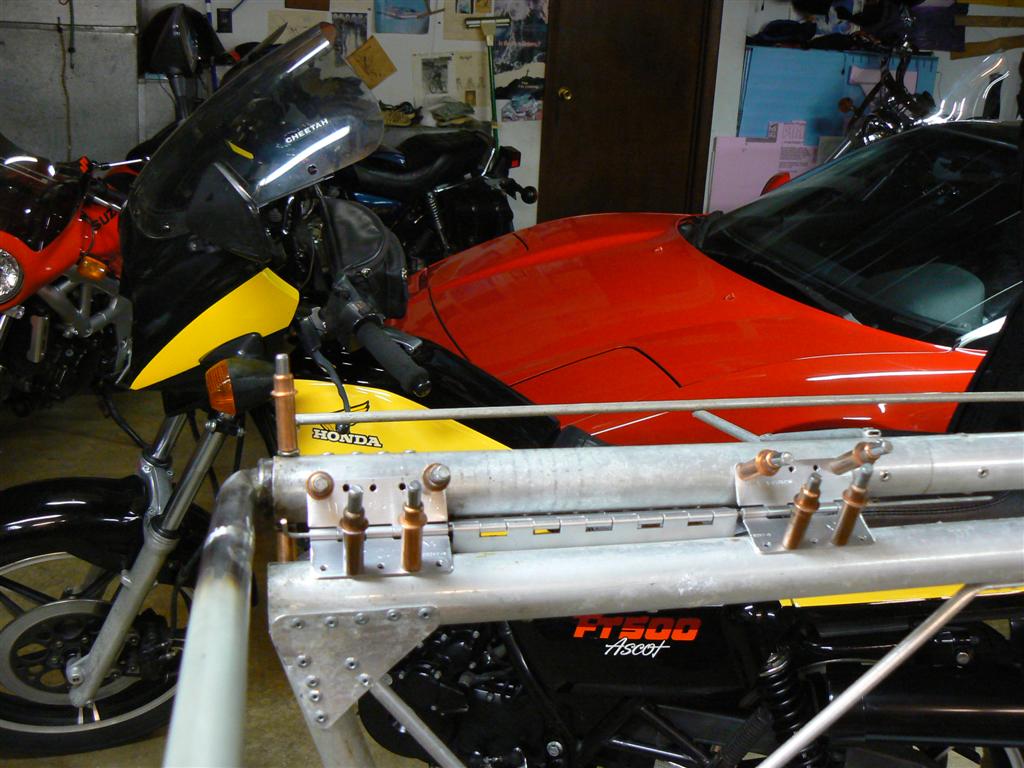

No, it is at the tip and doesn't need much, it just needs not to have the hinge flexing around. And splitting the hinge and attaching it is easy.
You drill & cleco the usual hinge normally, using an extra long piece of hinge wire scrap. Then take what ever extra hinge additions you plan to use, (pre-drilled for the rivet holes) slide it on the hinge wire, and just let it hang down between the rear spar and the aileron tube. (Working with the wing upside down as the plans show) Push the little hinge segment up against the tube, & where ever it goes, that's where it needs to be. Drill it, cleco it, you're done.
Spent the day in the garage working on mowers, tillers, etc. and had to stand the wing up out of the way, so here is what the hinge setup looks like from the other side. You are looking down from the top of the wing, and the aileron is as if it were hanging straight down.
One thing is for sure: this type hinge setup does not flex. Period.
