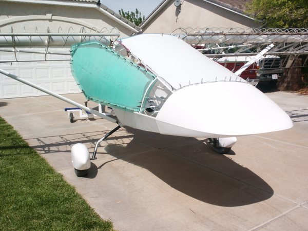

PostPosted: Mon Mar 22, 2010 3:47 pm    Post subject: MK111Xtra Reply with quote
Boyd,
  I set my tail feathers and main wing's incidences for a MkIII "Classic".  Most likely, my settings were exactly the same as yours are.
  But, as no doubt you are aware, my plane doesn't quite look like a MkIII Classic, anymore.  In fact, very few Kolb people could tell it isn't a genuine MkIII Xtra.
  While researching the incidences for an Xtra (since I knew they were NOT the same as a Classic), I called and talked to Brian (at) TNK.  (would that have been Brian Melborne??  I didn't catch his last name)
  Brian explained to me, when they got that very first Xtra built, someone test-flew it.  Whoever test flew it said that there was a significant "nose down" tendency, that they attributed to the wide, wedged nose, acting like a big scoop to the on-coming air.  With a high tail profile, almost all air was forced UP onto the wedge.
  So, it was decided to lower the leading edge of stabilizers, effectively raising the leading edge of the wedge, which allowed more air to go below the nose, and thereby reducing the nose down tendency.
  Brian also explained to me that they also changed the Xtra's main wing tab mounting hole location.  Instead of it being 7/8" up from the bottom, it is now supposed to be down 7/8" from the top of the tab (or close to these points...use a digital level, of course).
  This higher tab mount hole effectively reduces the wing's incidence.  At this point, I can't recall exactly why.
  My phone conversation with Brian was almost two years ago, and the exact facts of what, why and when are getting a little fuzzy at this point.  It could be that the steel gear legs factored in to some of the adjustments, but I don't recall anymore.
  As some of you Kolb guys may be aware, I am "nearing" completion of some aspects of building my MkIII (after 10 years, it's about darn time!!).  About three weeks ago, I called TNK, and asked Travis if there were any precise digital incidence angles for an Xtra.  He said "yes, and handed the phone to Dennis, who gave me the following numbers;
1) motor mount is to be level...first!!
2) boom tube "should" be -6.1 deg (mine was incredibly close to that!!)
3) hor. stabs are then to be set to -4.8 deg
4) main wings are to be set to 3.4 degrees, with .6 degrees dihedral  (although I have heard from a few that more dihedral would be better.   I ended up with 1.6 deg, since my wing struts were already made, and I did NOT want to change them.  I'm happy with the final result!!)
  Yes, Boyd, old Kolb didn't say anything about -4.8 deg.  My MkIIIC plans seemed to reference inches most often, not degrees.  It is evidently a newer way to describe what the factory wants to advise for wing incidences....I'd guess.
  And, yes, they changed the instructions, as I understand it.
  I hope I cleared up any confusion.
Mike Welch
MkIII
PS.  I also included an old photo of my MkIII I took a couple of years ago, prior to leaving Utah.  If you look closely, you can see the significantly steep wing incidence (in the previous MkIII Classic setting)
    My plane is MILES, HOURS, and LIGHT YEARS past this photo!!!  If spring ever stick around, I'll take some more up to date photos.    Wink
