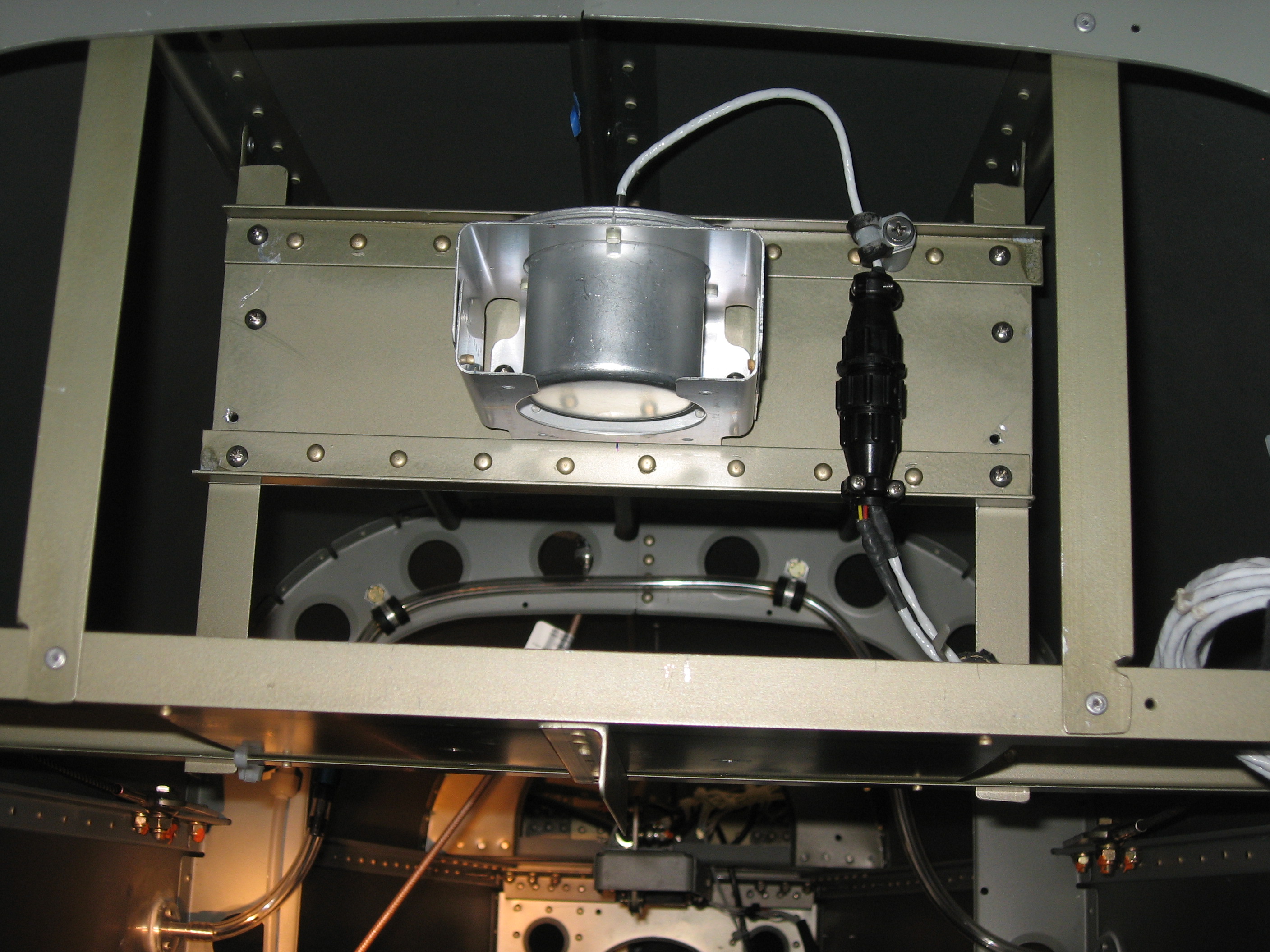

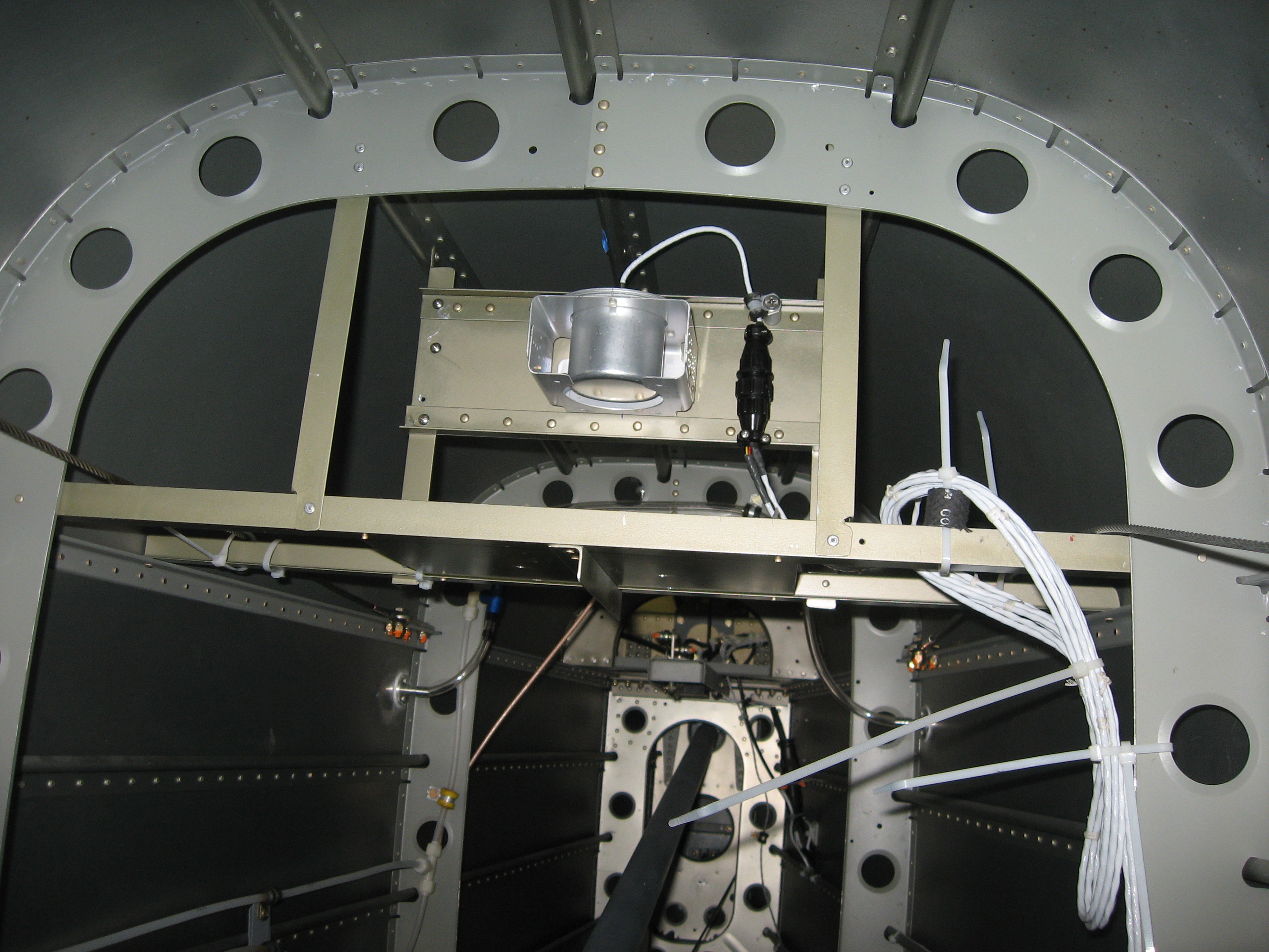

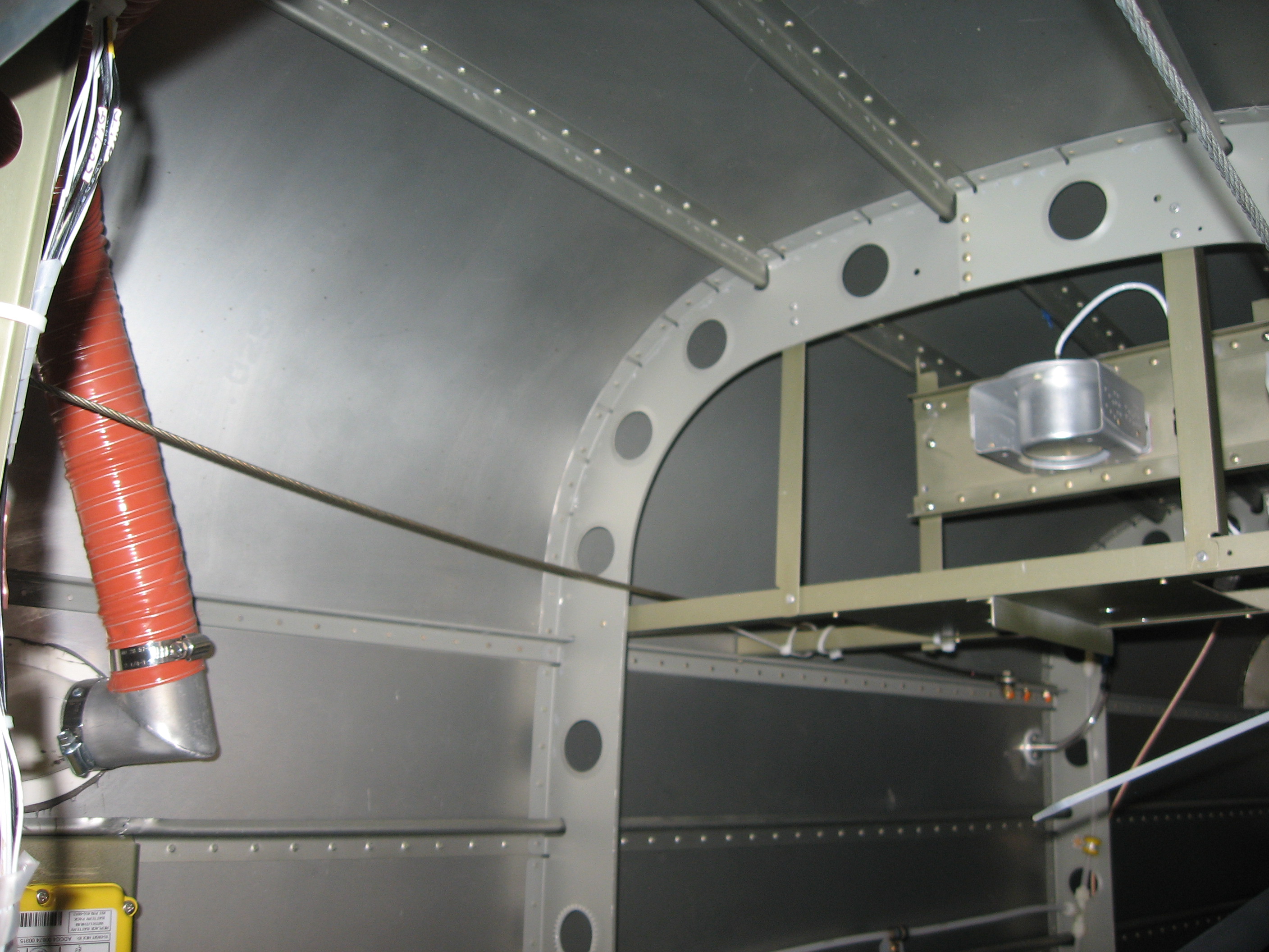

I removed the op tech equipt and put in a G500 and and here is where I put the GMU44. The one problem that showed up on calibrating was the strobe power pack and what I did was to the ground straight to the battery. That cleared the red flag. The AHRS went on vans mount, pilot side of auto pilot servor. It was made for it.

PostPosted: Tue Mar 23, 2010 7:41 am    Post subject: Re: AHRS and Magnetometer location on the 10 Reply with quote
Thanks Patrick,
The photos really help. I think that will be the location unless I find an easy spot in the wing.
