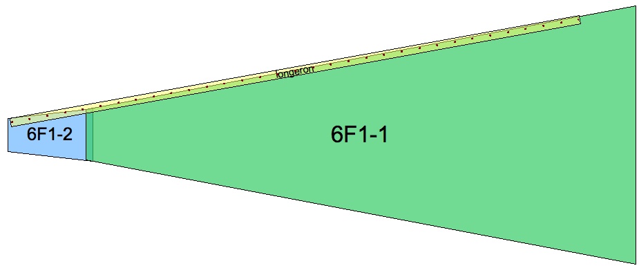

As I examined the fuselage plans, I noticed the bottom skin sides
aren't straight: where the front (6F1-1) and rear (6F1-2) parts join,
there is an angle.
This raised a concern: as the bottom longeron is straight, won't I
have problems with edge distance when I drill holes on the longeron?
(see attached drawing - obviously not on scale - where the blue part
is 6F1-2, the blue part is 6F1-1 and the longeron is the long blue
rectangle).
Or I could make the bottom ski straight, but this could have a ripple
effect (i.e., 6F1-2 (front H.T. frame) might need to be wider, which
would in turn affect 6F2-6 (rear panel, top) and God know what else...).

Larry, it appears you understood my concern - but I don't understand what you are saying.
Did you position the second tail frame differently from the plans? or did you make a rear bottom skin different from the plans, so the sides of 6F1-1 and -2 make a straight line ? (I don't understand the sentence "The rudder pivot plates and
extreme forward width required.")
Your sentence at the end ("...the sides remain straight.") seems to indicate that you did modify 6F1-1 and/or -2 ...
Thanks for the links to the pictures - I have stared at them for a while, but I don't feel enlightened...
Attached is my modified diagram, now a little closer to the actual proportions of the parts involved.
The red dotted line represents the rivet line.
Thanks for your time and patience...

Yes, Carlos,
I did remake the bottom tail panel, but only slightly to get a straight
enough shot at proper edge distance. All else seemed to fit when jigged
as per pictures shown. I don't perceive any curve in my tail longerons
at this point. The pics were intended to show setup jigging used
to assess the rear bottom panel and the rest of the assembly. This is a
fairly common arrangement. I remember using quick clamps to grip
the final assembly, so sides might not have been perfectly straight for
drilling and clecoing along that line. Symmetry and centering
used up a lot of ink markers.

Larry, thanks for the clarification.
I believe I have now enough information to proceed: I'll try to "convince" the longeron to follow the curve first, and if that doesn't work, make a second rear bottom skin. Thankfully aluminum is recyclable...

Your picture implies the longeron needs to be shaped to fit the sheet metal. I'm not building a HDS but I do have experience shaping L-Angles, formed or extruded. If I'm not understanding the problem, let me know.

Ron, that seems to be the case, judging from the comments I received.
