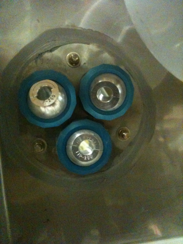

Has anyone figured out a good way to protect the firewall integrity were the control cables pass thru the firewall in the stock holes?
There is no space between the holes (1/4 inch) to accommodate the eyeball type pass- thru, nor the stainless shields. I could trim three shields and nestle them together, but has anyone made a shield in one piece that would cover all three holes? How about you guys with access to a machine shop that could punch out such a shield and sell them to us less fortunate.

I sandwiched stainless steel rings with three eyeballs and sealed it all together. I wish I hadn't drilled out the original holes until I was ready.
