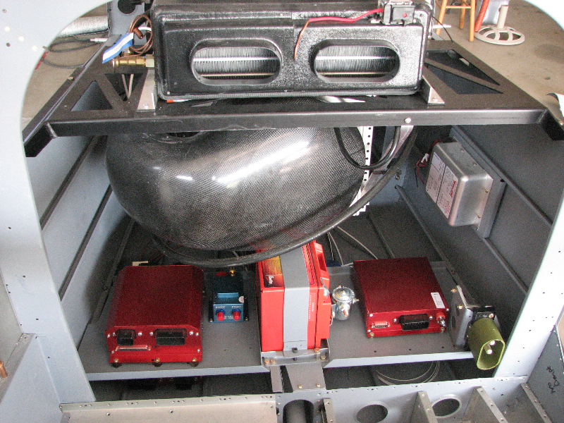

PostPosted: Mon Mar 15, 2010 6:17 pm    Post subject: Jumper plug and recepticle. Reply with quote
John you may have seen my set up on the 8A (under development). Yes heavy (not sure we have the same one as mine can’t be 1.5 lbs.), yes kind of ugly. My only answer is that when you need one you need one. With modern EFIS you will find yourself plugged in a heck of a lot more than you may think. The system update for my G900x takes about 30 minutes. Initial programming could be hours. No reason you can’t simplify with basic leads near the batteries but the plugs are easier to use and get to when loaded (the baggage area loaded, not when you are loaded).

PostPosted: Wed Mar 17, 2010 8:01 am    Post subject: Re: Jumper plug and recepticle. Reply with quote
[quote="Phil.Perry(at)netapp.com"]I was thinking about putting it into the baggage bulkhead and located just in front of the baggage door. This way it would be out of the weather, but still accessible via the baggage door.
My plan may be flawed though. The further you get into the project, the more you realize that all that thinking you did previously really doesn't matter. Smile
Phil
Phil, that is where I located mine and I am very happy with it in that position. I have an opening for it in my aft baggage bulkhead and in the upholstery panel. It is covered by a small rectangular cover that velcros in position. Abby at Flightline Interiors did a nice job on it. I also made a plug out of a block of phenolic that stays "plugged in" when not in use to protect the pins. As I mentioned in an earlier post, I would not want to be without it.
