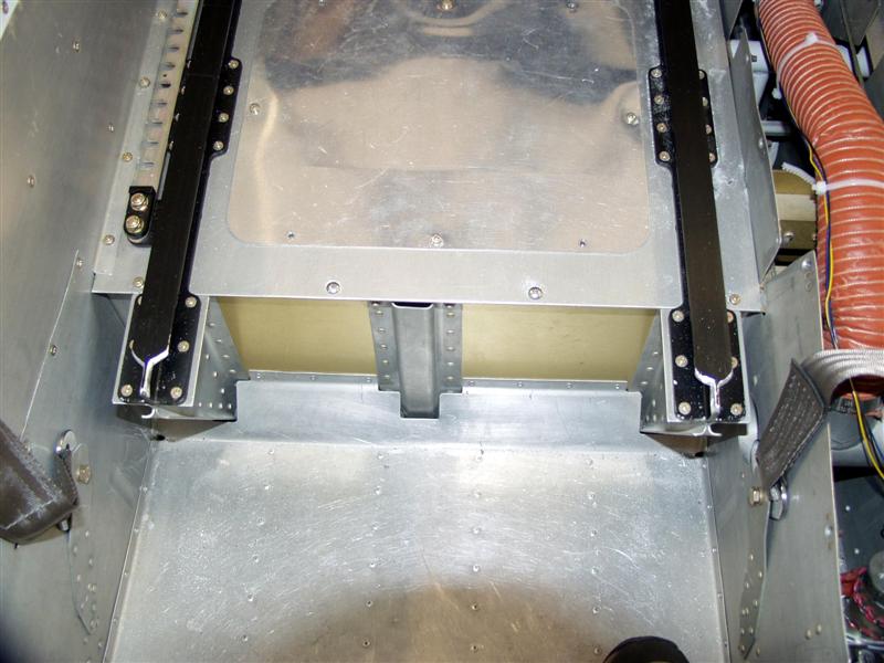

Hey Guys,
I asked the inspector (Vic Syracuse) - who has built a couple of -10's - if he had any tricks for getting the seats out. He said he trimmed off the upper "ears" of the rear of the I rails so that after removing the seat position pin, the seat slides back, then tips up without hitting the flap tunnel covers. I did that today and it works like a charm.
Perhaps this has been covered by others, but I don't remember it, and I'm too tired tonight to search it!
I'll attach a pic.
Later, - Lew

PostPosted: Tue Mar 16, 2010 3:49 am    Post subject: Seat rails Reply with quote
When less tired please send a picture. I'm interested

PostPosted: Tue Mar 16, 2010 5:54 am    Post subject: Seat rails Reply with quote
Hey John,
The picture was attached to the post, but here it is again.
Later, - Lew

PostPosted: Tue Mar 16, 2010 12:55 pm    Post subject: Seat rails Reply with quote
Instead of trimming the rails, consider beveling the rear of the plastic strips so that the seat will tip up for removal.

PostPosted: Tue Mar 16, 2010 2:02 pm    Post subject: Seat rails Reply with quote
Less intrusive...works great too. I just 45ved the nylon parts and it tips up and comes out fine.

PostPosted: Tue Mar 16, 2010 2:53 pm    Post subject: Seat rails Reply with quote
Sorry, I should have said the FRONT of the strip since that is where the interference occures when trying to remove the seat.
