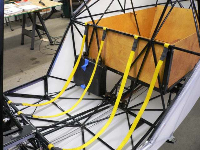

PostPosted: Tue Mar 09, 2010 8:46 pm    Post subject: Northstar problems Reply with quote
Here you can see the outlet on the front and the drain in the bottom.
Jim Series 5 0-200
21D MN
 Filesize:  166.77 KB
 Viewed:  20766 Time(s)
Lynn Matteson
Posts: 2778
PostPosted: Wed Mar 10, 2010 3:00 am    Post subject: Northstar problems Reply with quote
And on my installation, I used a plastic (PVC) floor flange of a
suitable diameter cemented to the fabric below the quick drain to
reinforce said fabric, and allow for sumping the header tank through
a hole cut in the fabric.

You need an access port on the bottom of the fuse to take samples from your header. A nice addition on future header tanks would be for the tank to have a small sump on the bottom to trap water.
Noel
From: owner-kitfox-list-server(at)matronics.com [mailto:owner-kitfox-list-server(at)matronics.com] On Behalf Of Zimmermans
Sent: March 10, 2010 1:15 AM
Subject: Re: Northstar problems
Jim Series 5 0-200
21D MN
Noel Loveys
Kitfox III-A

PostPosted: Thu Mar 11, 2010 1:20 pm    Post subject: Northstar problems Reply with quote
The simple answer to that is, if it bothers you install a screen after the
header tank.
Me... I like the idea of a gascolator with a clear glass bowl and a drain at
the lowest point of the whole fuel system. That's just me.
Noel
