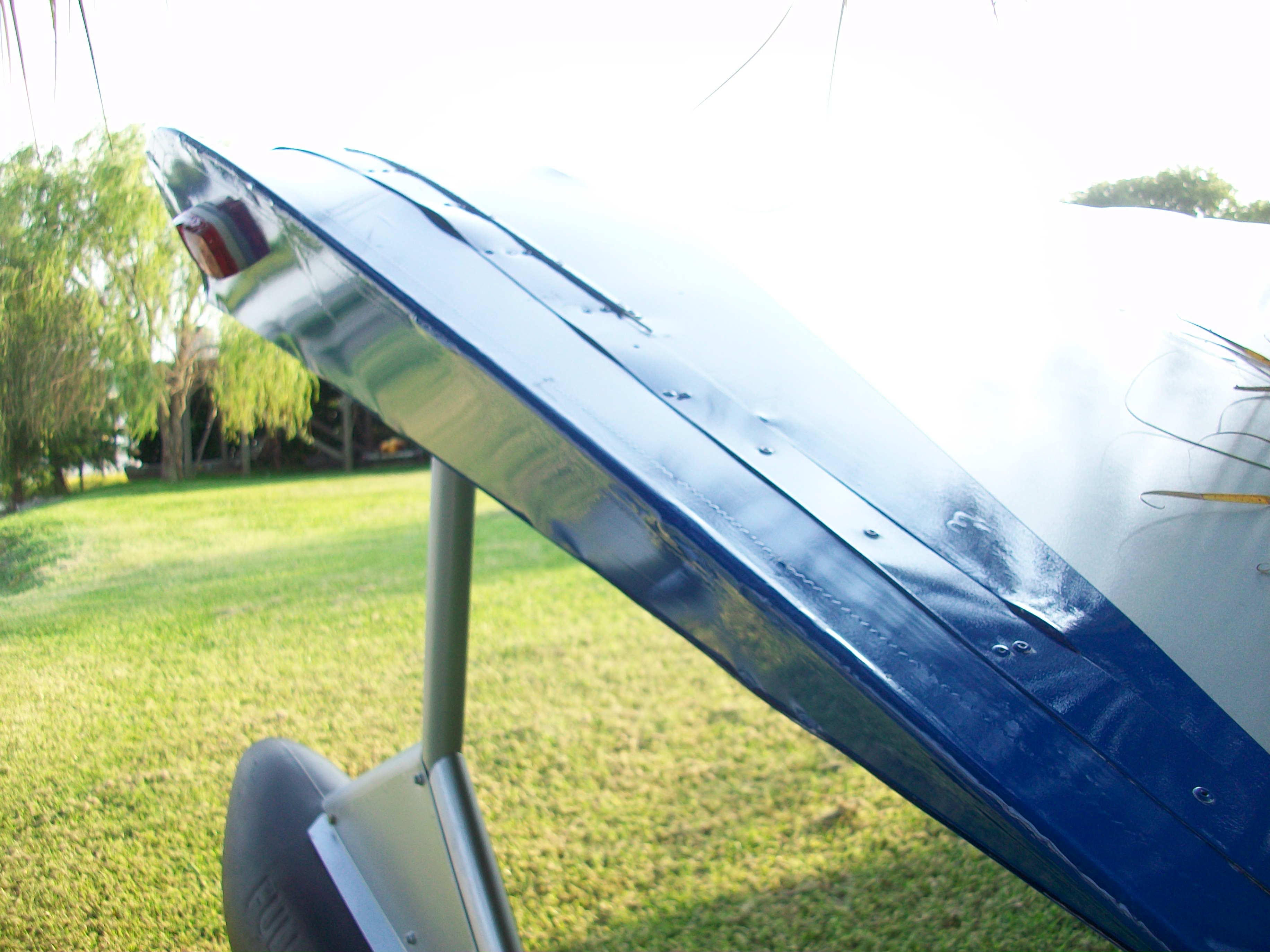

Here are photos of my old FSII clipped wing amphib...i would cruise with SeaReys with ease...(80mph-ish) with a 582 and warpdrive.
daniel myers
