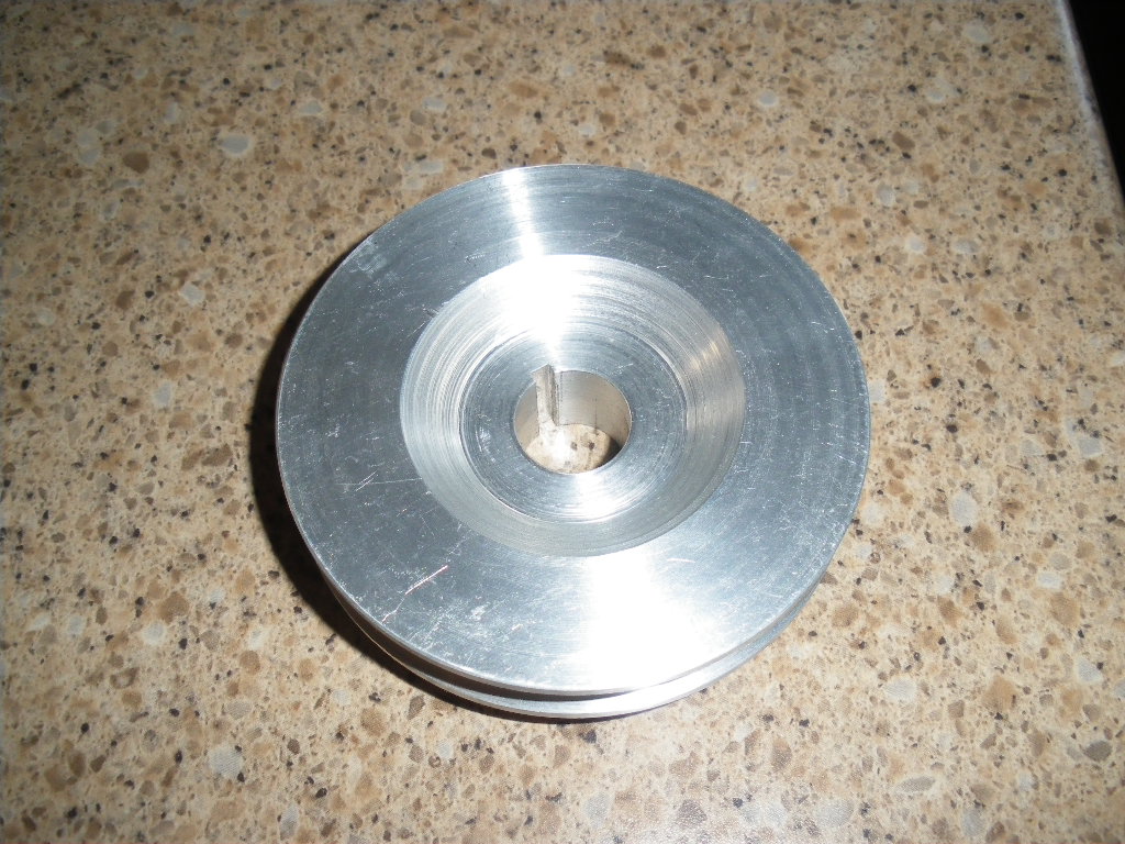

Hi folks (especially those of you that are machinists Wink
I made pulley for my alternator from an aluminum plate. I have a lathe, but I'm far from being a machinist.
I was pretty proud of me until about half an hour ago. I made the center hole about .003 to .004 to large in diameter. (ouch!) (I cut .0015 to .002 too much). Now, the pulley is pretty slack on the shaft. Is there a good way to make it the proper size (adonizing, other means) that will be reliable... or do I need to start over and use this one as a failure trophy in my workshop?

We used to send the new kid to the tool crib to request a hole shrinker.  Just a part of a good education. As for myself, I would proudly display a custom-made pulley with all my other "trophies". Yes, I'm implying that you have indeed made yourself a "trophy".
And a hint - This probably won't be the last "trophy" you make. Re-making a part is always easier than making the first botched one. Please don't be discouraged by this kind of experience. We all do it.  Keep after it and you'll get there, trust me.

If it is a permanent mount you can shim the assembly. Use one piece of shim stock cut to the width of pulley wrapped completely around the shaft except for the area where the key is.
Or just make another one, it's all about learning anyway.

Hi Michel;
  The first was a learning experience, the second will be perfect. Have fun.

VERY GOOD JOB.  It does LQQK nice.  A bit slower and a rounded bit would prevent the score lines on the inside taper.
BUT!  Have you inserted the Woodruff key?  You may find the problem goes away once inserted.  BUT!  Watch out for wobble.
The next thing you can do is make the center bigger and insert a sleeve.  Or get some shim stock and metal bonding CA glue.  Shim up the difference and you will be good to go.
How did you do the keyway?

ron is correct, a full wrapp shim may work. cheep and easiest way. recoat or redo just takes more time.

problem with a shim is it will be off balance and cause a vibration.
rebuild or build up the layer and remill.

looking at the picture, you just need to have a plasma coater add the metal back on. or its cheeper to rebuild new one.

I bought an expensive broach with the appropriate collet. So far this is an 80$ pulley and still spending... Wink
I think the sleeve idea is not bad, but if I have to redo machine work, i might be as good to start over. And I am not precise enough with my tools to machine a press-fit assembly (.001 or .002 under clearance) with enough assurance.
I am surprised nobody liked the JB Weld approach... after all, I only need .0015" or .002" of it. That thing has many uses including (for automotive):

It provides nearly 4000 psi of tensile strenght and it is good for up to 500F. And if it could be good enough, that would save me about 6 hours of re-fabricating one (and buying the stock aluminum to start over).
Is there any warning against that?

 I do not think there are any uses of JB Weld where one would not want to keep the wheels on the ground!!

Is knurling an option? If you are only seeking .002", even .002" per side,
it shouldn't take much to raise that much material in AL with an ID knurling
tool.
Don't know the cost of the tool, maybe someone has one to loan.
ganurling, kanarling, you know, those little diamond shapes that raise metal
above the surface.

I have found that JBWeld is great with steel, not so great with aluminum.  I had quite a few failures to bond with aluminum before I reached that conclusion.

Plasma coating is NOT the way to go.  There are so many things to wrong with that process:
1 - It is a hand operation - In this case
2 - It is inside a through hole - Very difficult to get a uniform coating
3 - It is OPERATOR dependent
4 - HEAT is going to be high on the issue list - Again operator dependent
5 - The part has to be VERY roughly sand blasted 20 to 40 grit - And there is a sharp edge that won't be any more ... More machining.
The idea of using Hard Coat Anodizing is a good one.  But the build up is NOT 100% build up.
Example: a coating of 0.002" is ONLY a build up of 0.001" and a penetration of 0.001".  The coating shop calls that a 0.002" Coating.  IF - The hole dimension is off by 0.003" you will need a build up of 0.0015" per side so that means a coating of 0.003"
THAT is difficult to do on many aluminum's, especially 2024.  I don't recall, what was the  sheave was made from?
AND don't forget - - - They will have to mask the key-way.  Masking is the costly part of the job.  The rest of the part could be coated.
Shimming will NOT cause the the sheave to go off balance.  If that was the case the Woodruff Key would cause it to go off balance.  Also the weight distribution is so close to the centripetal center that a much larger mass would be need to cause an out of balance condition.  BUT!  If you have the opportunity to do so... BALANCE the alternator rotor and still if you have the equipment... Do it in the housing.

Thanks for the response... The material is 6061-T6.
The pulley is the one going on the engine side, not the alternator side.
If I get the part anodized, I could recut the key hole after (?)

Well. this is exactly what I thought about and I did not readilly see consequences... the pulley will be attached very tightly to the shaft using a 1/2" lock nut and washer (it is not just pressed fit.. It has a woodruf key and if the materials wears out (which I don't know how it would do that since there is no relative movement), the most the pulley will move is .002". All the material around the hole is thick, and solid. I'm no expert... could it cause the lock nut to unscrew itself?

The problem with JB Weld is that (as far as I'm aware) it does not have any
tested, documented properties. At least, not the kind of testing really needed
for aircraft use. It may work fine; it may not.
I might consider it for something that was not moving, did not require defined
structural properties, or was not subjected to vibration.
I once heard a fellow staunchly defending a repair he made to his prop with JB
Weld. And that was on a certificated aircraft!
assurance.
automotive): - cracked engine blocks
- transmission & rear-end casings
- cylinder heads & sleeves
- axles & hubs
- valve guides
- press fit bearings
- crankshaft pulleys
- casting defects
- key ways
- stripped threads

Jim ? would you go flying with that guy and his jb welded prop?

Michel   why not just insert some precision shim stock to remove play whatever you use to hold pulley on will contain shim stock. if the shim is wrapped around the shaft, the keyway will prevent any oscillationsof pulley , we used this on high rpm machinery 8to 12k rpm for months and months without a single failure and this equipment went thru lots of rapid de-acceleration cycles....
for what its worth

Michel:
I would just ask them to MASK the keyway.  In the business it is know as DOUBLE MASKING one layer of special masking tape and a coating of a liquid masking over the tape.
The cost for masking might be $30 tops ... It is the labor you are paying for.
It sure would be much less time consuming than re-cutting AND ... HERE is the BIG AND ...
Hard Coat Anodize can have a theoretical Rockwell of over 60.  This makes it VERY difficult to machine AND even if you did machine it, so hard it can dull a carbide bit.  Also penetration part of the hardcoat after machining never is smooth.  Go with the masking.
Barry
operator dependent
0.003"
was made from?
> it in the housing.

The only thing I can think of that would work against you and it works against all of us is VIBRATION and maybe a back-fire.
Barry

Consider the consequences if it should fail. After all this
isn't going on a garden tractor!
Ron Lee
