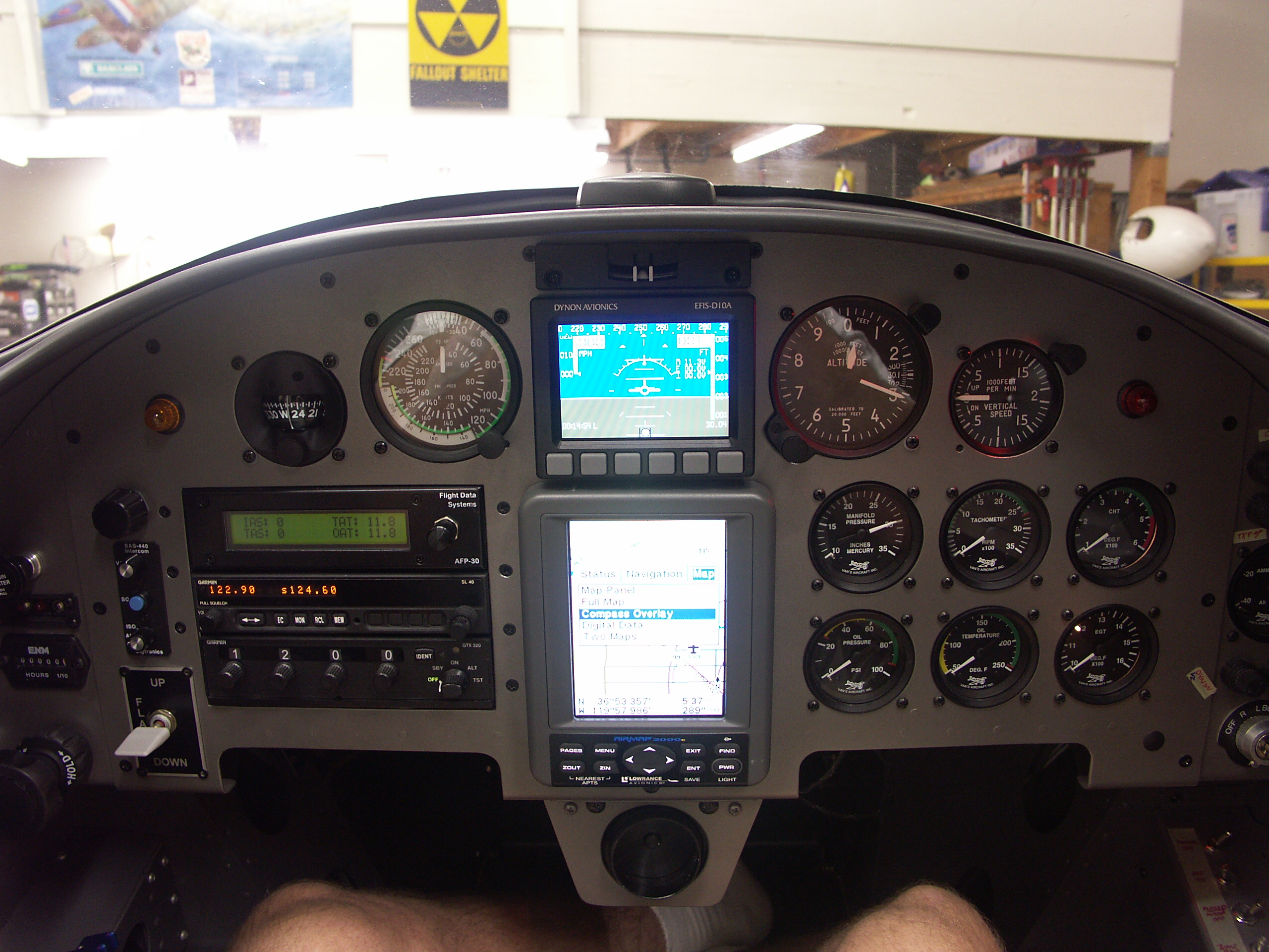

tcone1(at)comcast.net
PostPosted: Sun Mar 07, 2010 3:31 pm    Post subject: RV8- Air Vents Reply with quote
Mine is out the bottom and I love it.
Here's a pic
