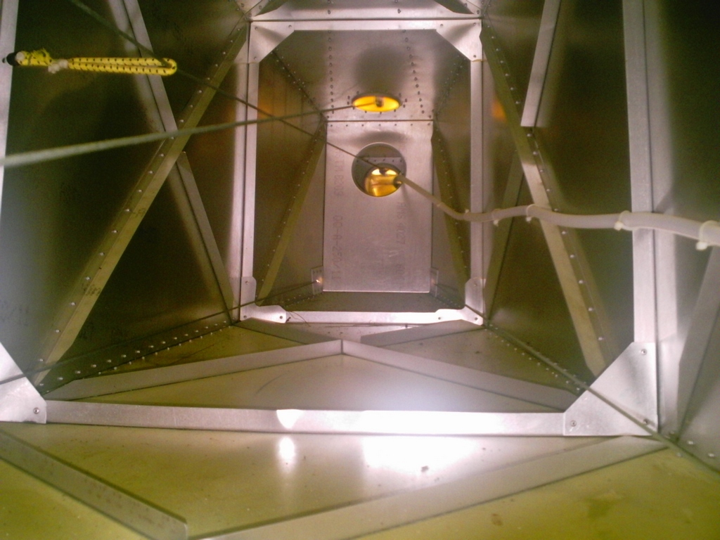

In practice, I fitted the bungee across to the RHS fuse and ahead of the crossover to the top elevator cable that comes off the control horn, so this is the lower elevator cable. Reason for this is to keep the control stick biased to neutral using the bungee tension to counter the assymetric tension of the elevator cables with respect to aileron position.
I have added 2 attachments
You will find out what I mean when you do it.
