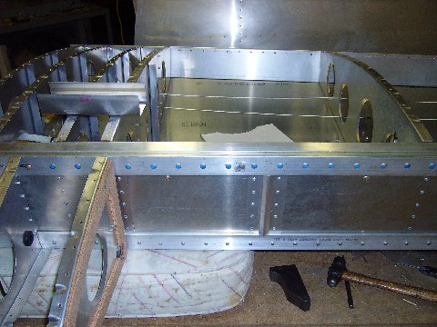

I don't know what I am doing wrong but almost all of my rivets I drive are turning BLUE and I am using the ones Zenith Supplied. Is anyone else having this problem?
Jeff

Never seen that - are you sure they aren't they explosive bolts?

No, nor have I ever heard of a rivet turning blue. The act of setting a rivet
of this kind generates a fair amount of heat internal to the rivet, which
makes me wonder if this is some odd sort of chemical reaction.
Did the rivet turn blue immediately after you set it, or did it wait a while -
perhaps the same length of time it would take the rivet to cool? It's probably
a silly question, but did you soak or coat the rivet with anything, or store
them near a reactive chemical?

Jeff, after chewing on this a bit, I have suggestion/offer. I bunged up a few
rivets while setting them, and have some extras. None of mine turned blue.
If you're in the CONUS, I could mail you a few of mine to try. If you set them
and they turn blue, there's something in the process you're using. If they
don't, there's some difference in the rivets, and you might want to think about
getting some more rivets.
few rivets while setting them, and have some extras. None of mine turned
blue.
I should clarify - I bought a bunch more rivets.
them and they turn blue, there's something in the process you're using. If
they don't, there's some difference in the rivets, and you might want to
think about getting some more rivets.
