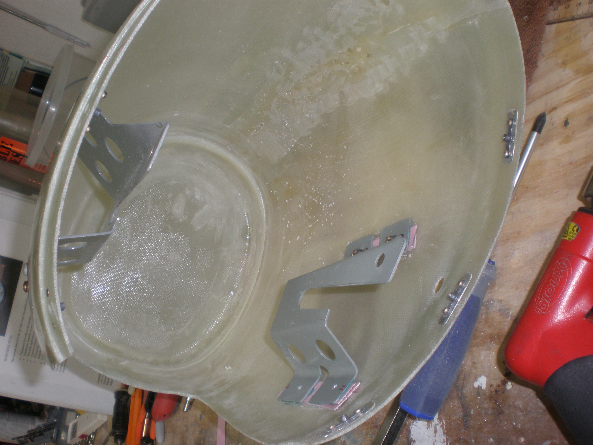

AirMike
Joined: 27 Feb 2007
Posts: 514
Location: Nevada
PostPosted: Sun Feb 28, 2010 9:05 am    Post subject: Reinforcing screw holes on wheel pants Reply with quote
I shoved some pieces of GRP that I had cut off of the doors (window) under the screw holes (epoxy/flox glue) and they are tight and tough.
