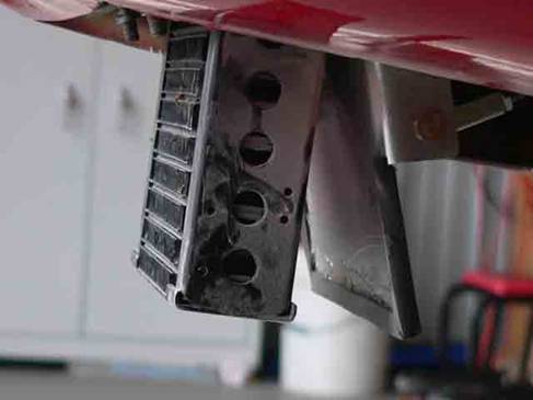

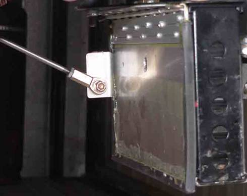

It was taking a long time to warm my 912 oil temps on cold days and the temps were staying below the recommended levels. I was going to put in an oil radiator bypass thermostat, but after purchasing the unit I realized it required putting in a lot of extra pluming, thus increasing the chances of a failure. Instead, I built a simple shutter to reduce airflow through the radiator (see pics below). The oil changes temperature almost immediately when opening or closing this shutter. There is a 20-degree difference within a minute or so.
I have the old style engine mount and this shutter may not fit with the new mount.
Les

Great idea Les! I have been playing around with a vane type of arrangement but yours looks better. Thank you! Right now I've been using Mexican chrome (duct tape) up here in cold ND, but with days getting warmer a cockpit adjustable thing is better. Same reason why I didn't put on the thermostat.

I tried both the Permacool and Thermostasis oil thermostats, with no appreciable results from either......  Certainly not worth all the extra hoses and hose clamps holding in hot oil.....  A shutter like yours looks like the way to go. JG

Understand the shutter works well for warmup...can you precisely control the temp in flight? I built a vane type shutter and couldn't get it to work as designed. I'm tired of fooling around with tape and having to land enroute to adjust it as temps warmup...

I can hold the shutter anywhere from right against the oil heater (0-degree) to about 75-degrees away. In flight the only testing I did was at the two extremes, 0 and 75-dregrees, and noticed that the oil temps changed about 20-degrees F on a 50F day.
