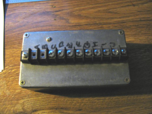

Hey Jean-Philippe - I have a spare NSI CAP140 ecu controller I have'nt used for years.
It was working fine when I removed it.  If you can't resolve the issue I could send it to you for just shipping charges from the USA.
                                           Glenn
