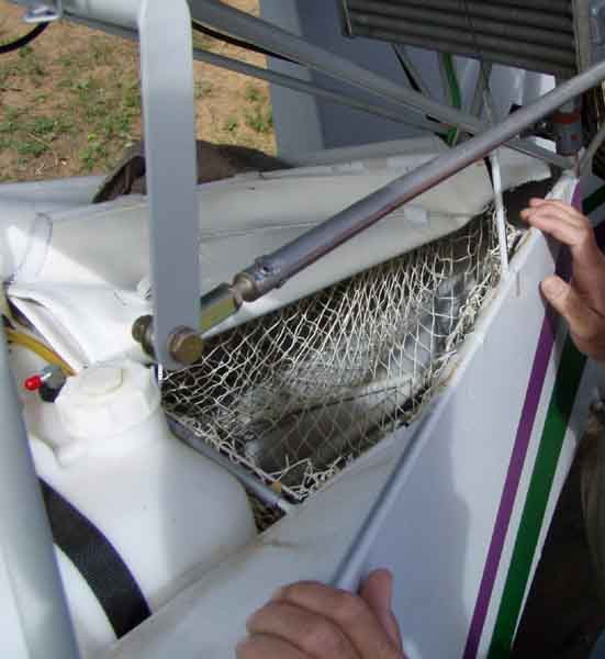

Mark Rinehart asked: << I modified my Mk3 fuselage cage to add an 12"x12" access door on the horizontal deck behind the seats (very similar to what Steve Green did with his)... I was wondering if I should install a shelf in this area for storing baggage/camping equip/etc ... what do you do? >>
Hi, Mark –
I did the same thing for my Mark-III. You apparently came to the same conclusion at I, noting that the space behind the fuel tanks is a useful storage volume – why cover it over?
With lightness in mind, I did not use a “shelf” per se, but rather, a sling made from fishing net. Because of the center fore-aft tube in that location, my fishing net cargo sling is actually two compartments – a left and a right side, with the net attached along all 4 sides. The single piece of net rides over the center tube, and each sling compartment is about 14 inches deep.
For the top, I fabricated a vinyl cover that velcros down at the edges. It is firmly attached down the center, so it cannot come loose and go into the prop. See picture – hope this helps …
Dennis Kirby
